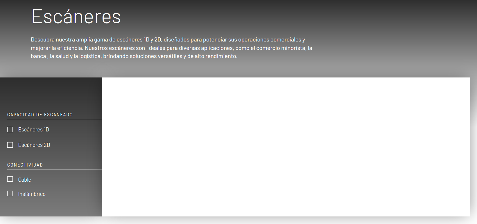

Hi, I'm using Jet Smart Filters to filter some products by attributes in elementor. Filters works fine in both languages (english and spanish) if you are loged in as an admin, but they don´t work in spanish if you are just browsing the site (loged out).
Thanks!

Can you please revise if this option is enabled:
WPML → Languages → Language filtering for AJAX operations
Source:
https://wpml.org/documentation/getting-started-guide/language-setup/enabling-language-cookie-to-support-ajax-filtering/
If so, please let me know - take note in this case I will provide a test site with WPML on which I will need to ask you to provide the Smart Filters plugin so that we can recreate and escalate this issue internally.
If you will not be able to cooperate on this matter, then I might need to ask you to consult the Crocoblock team first about this issue, as we do sadly not have access to the plugin.
Best regards
Andreas
August 17, 2023 at 5:53 pm #14248265
eliasB-3
Thank you so much! yup, that was the problem.
