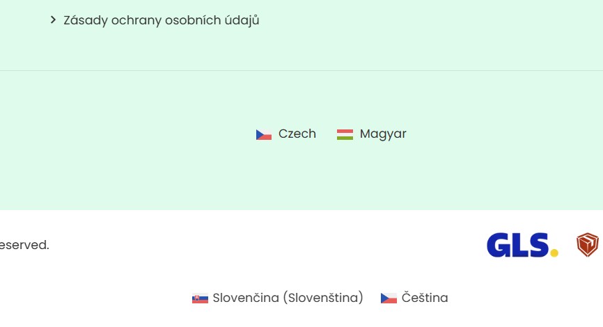

I tried to observe the issue in your site but I see multiple language switchers in the site footer with different languages, pointing to different domains (see attached langs.jpg).
Can you please explain the issue in more detail? A screen-recording showing what's exactly happening 'll be helpful in understanding the issue.

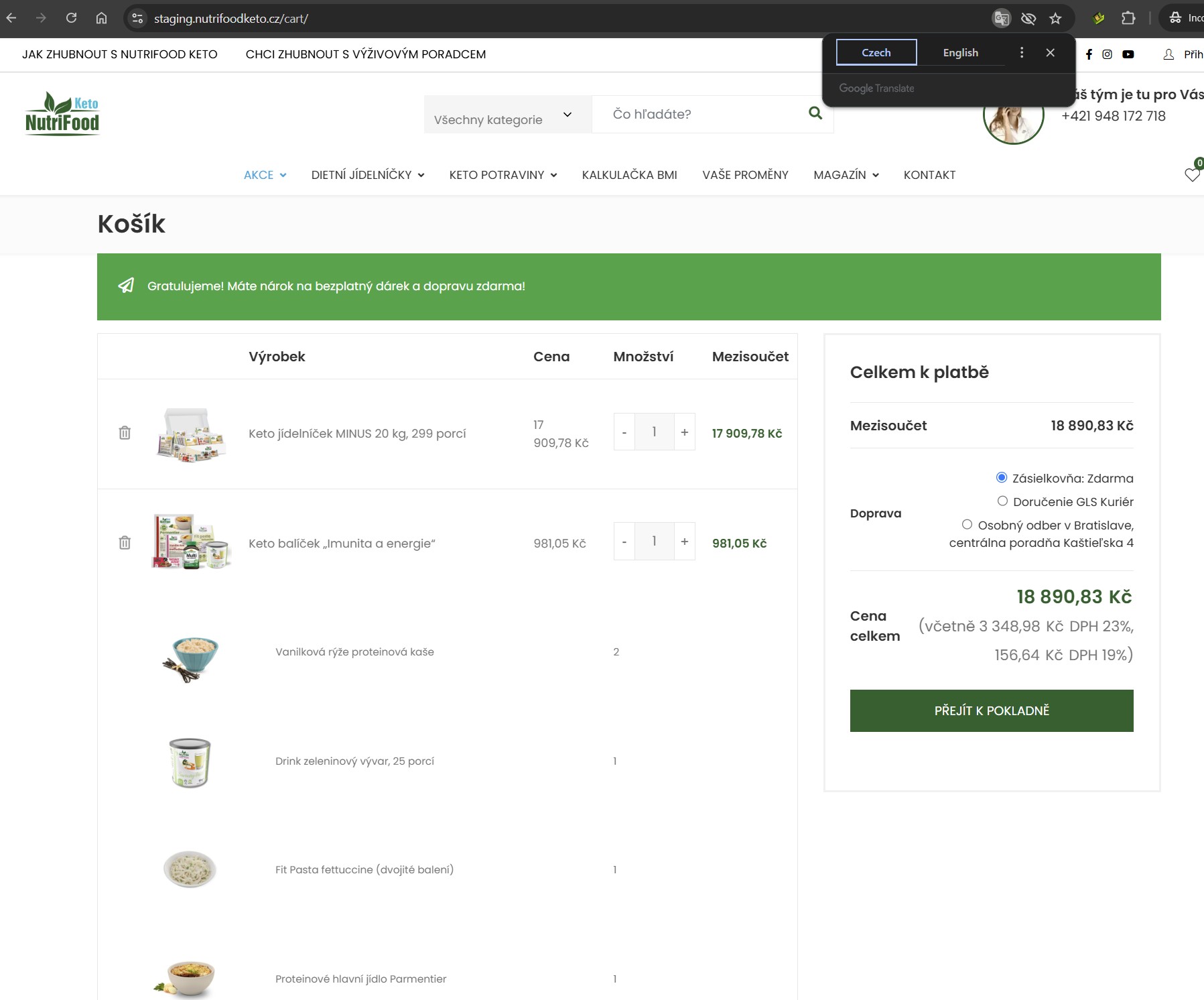

For the other issue about cart deleting the items, I tried this in default CZ language as you mentioned it is the main language, although I see SK is the default language of the site. However, in CZ adding items doesn't delete it (see the cart.jpg attached here).

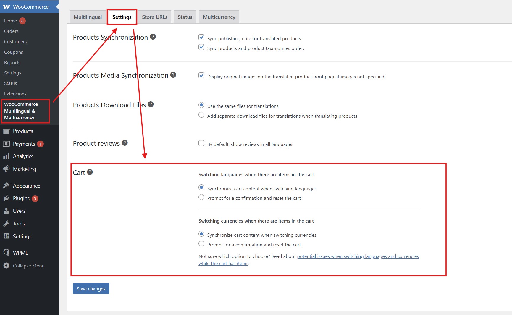

Additionally, you can find some Cart related settings in WooCommerce -> WCML -> Settings -> Cart section (see attached) which take place when switching a language or currency in the frontend.
