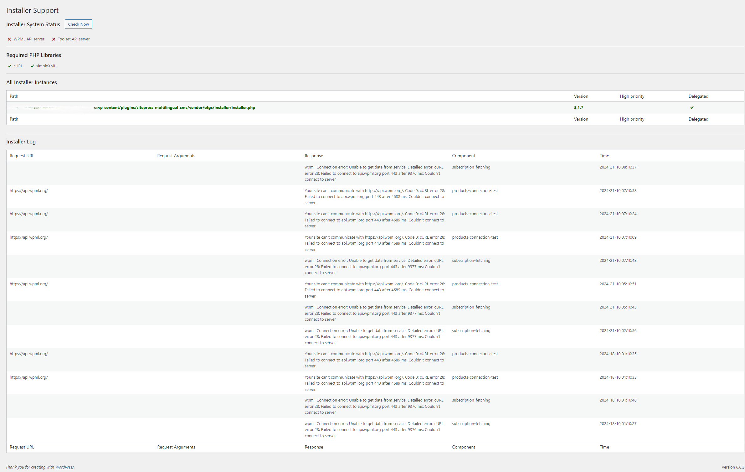

I've been trying to activate a new website so we can finish the WPML Setup and I'm stuck in the Register WPML step.
Already verified with the host and the following domains are whitelisted: wpml.org, cdn.wpml.org, api.wpml.org, api.toolset.com, cloudfront.net.
We have installed WPML successfully in over 60 sites and this is the first time we run into this issue.
Have followed all the steps in https://wpml.org/faq/wpml-plugin-cannot-connect-to-wpml-org/
Connection error: Unable to get data from service. Detailed error: cURL error 28: Failed to connect to api.wpml.org port 443 after 9376 ms: Couldn't connect to server.
Is there a way to manually validate the license key?
Can we bypass the key validation step so we can keep developing and translating?

Our Systems team confirmed that there are no blocks on our end regarding this URL.
On WPML > Support > Installer support > can you please let us know if you see two green check icons at the top after you click the "check" button? Or are there any red X-ses instead of the green check icons?
If there are any red X-ses, can you please contact your hosting provider to ensure that these domains are not blocked?
– wpml.org
– cdn.wpml.org
– api.wpml.org
– api.toolset.com
– cloudfront.net
Curl error 28 is also mentioned in our documentation here:
I can see that your site is hosted on GoDaddy. We had multiple clients who said GoDaddy support told them everything was fine, but we encouraged them to insist on requests until they resolved the issue because that error was coming from the hosting provider.
There's a block there, and the hosting provider needs to resolve this.
Please let me know how things go.
