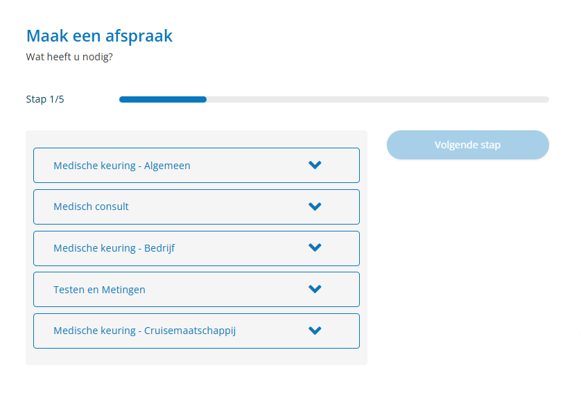

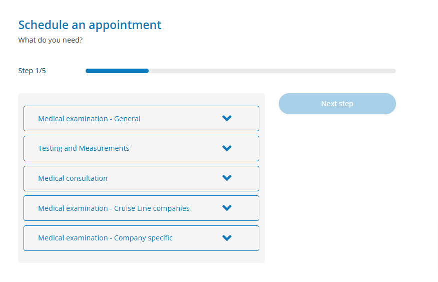

I am trying to ensure that the category order for the salonbookingsystem on hidden link is displayed correctly for both Dutch and UK categories. The intended order for Dutch is: 1. Medische keuring algemeen, 2. Medische keuring bedrijf, 3. Medische keuring cruisemaatschappij, 4. Medische consult, 5. Testen en metingen. For UK: 1. Medical examination general, 2. Medical examination company-specific, 3. Medical examination cruise line companies, 4. Medical consultation, 5. Testing and measurements.
When the Dutch categories are arranged in the correct order, the UK categories end up in the wrong order, and vice versa.
Could you help us fix the category order so both Dutch and UK versions display correctly?

Since the developer nor Wpml could find a fix for this I had to fix this by myself so here is how I fixed this:
1: delete all categories for all languages
2: make again the categories and make it in the correct order, translate direct a category after its made
3: for fixing the order i sorted the categories on id for both languages
4: connect again all treatments/consults to a category ( this i did not do yet for the staging site but i plan to fix today between 1600 and 1700 the cateogry order for the live site with this recipe)
