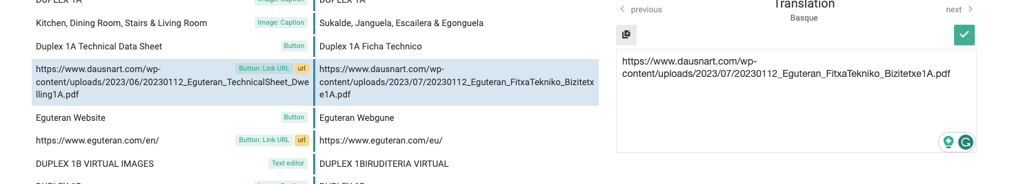

Thank you for the login information. I managed to login and now I am monitoring this page:
When I checked the Advanced Translation Editor it is showing as the one I shared the screenshot.
I wonder if it is correct?
November 20, 2023 at 1:46 pm #14877595
enneco-gotzonA
Hi Christophe, thank you very much for helping us!
Indeed, in your screenshot of the Advanced Translation Editor, the URL of the [original] English PDF is correctly linked to the URL of the PDF corresponding to the Basque translation.
