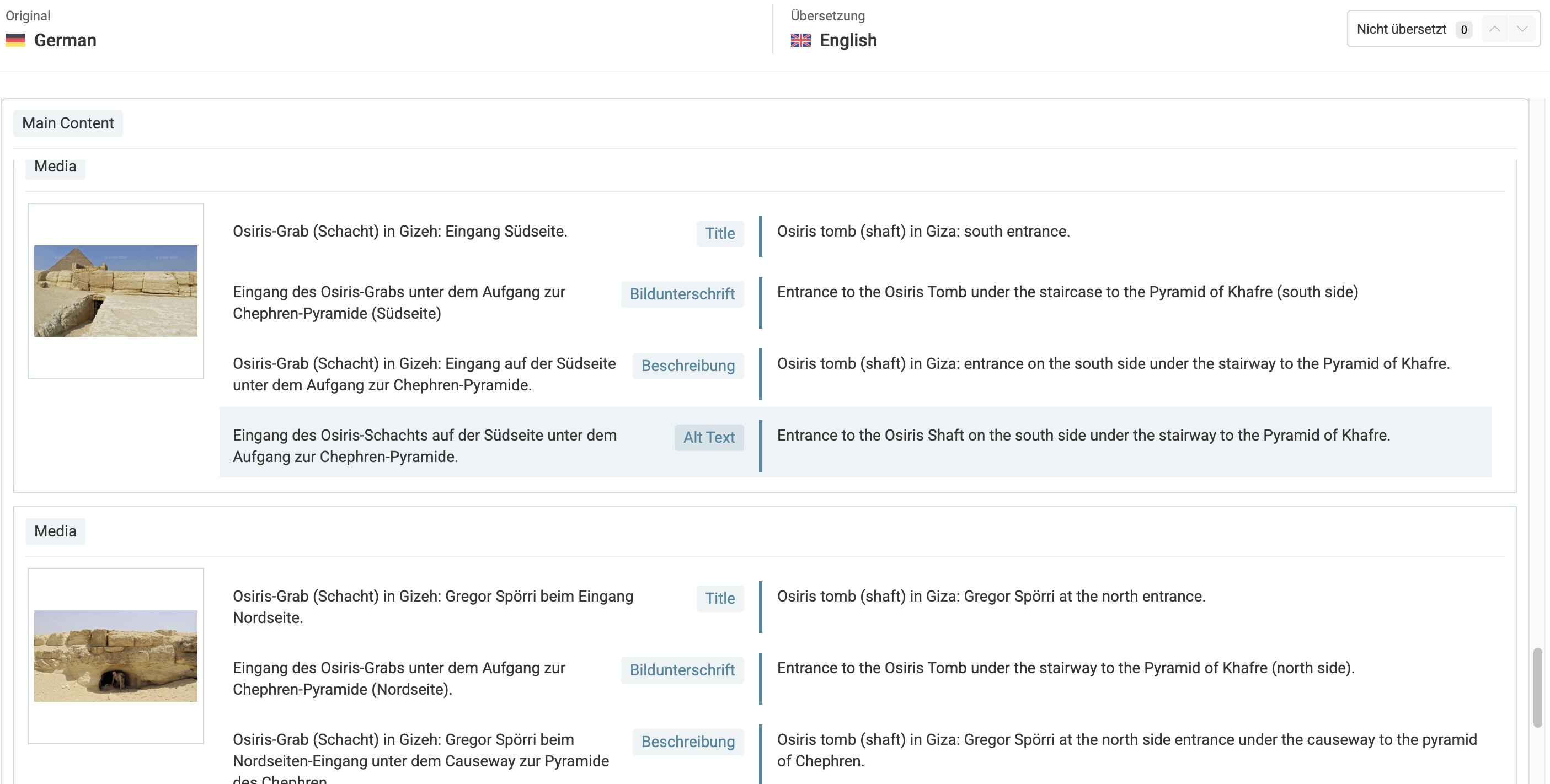

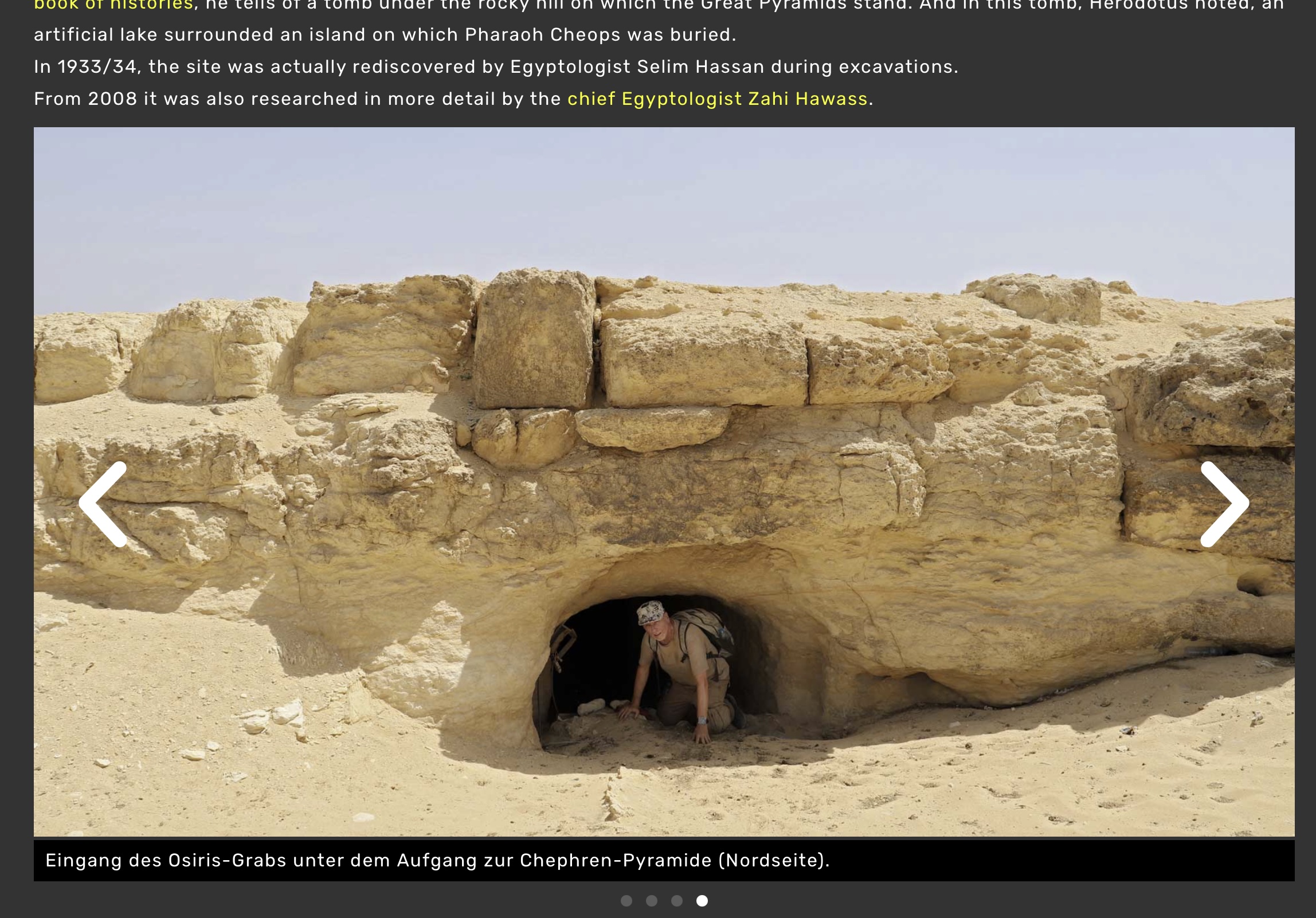

I am trying to translate media text and swap images in a carousel on my site hidden link using WPML. Previously, the translation process worked as expected, but an update seems to have changed this behavior.
The translated text in the image carousel remains in the original language, and specific images swapped for the translation do not show. The carousel also started showing the last picture as the first picture, while the first picture is missing in the translation.
Why does the translated text in the image carousel remain in the original language?
Why are the swapped images for the translated page not showing?
What caused the carousel to reorder images incorrectly after the update?

Hi Kor
Here's a quci video showing the issue: hidden link
The other issues disappeared like magic? There are no dobule photo in the slides anymore and some actaully have the correct translation other don't show the translation
Here's an example where all the photos still have the original text instead of the translation: hidden link
I hope you know what I mean?
Thank you
Pascal

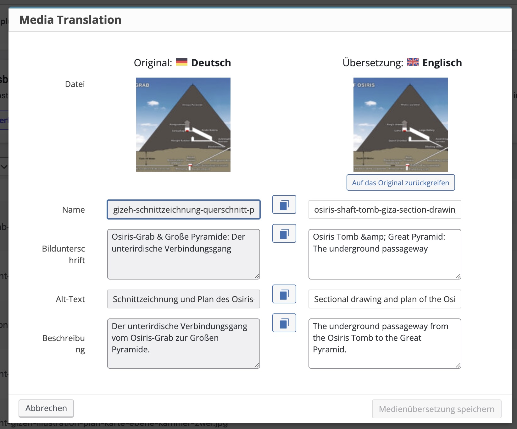

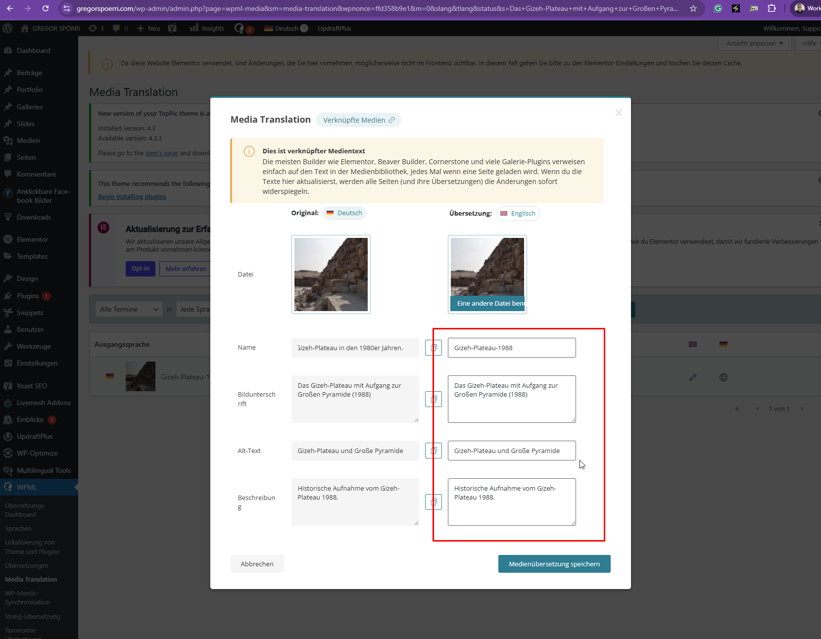

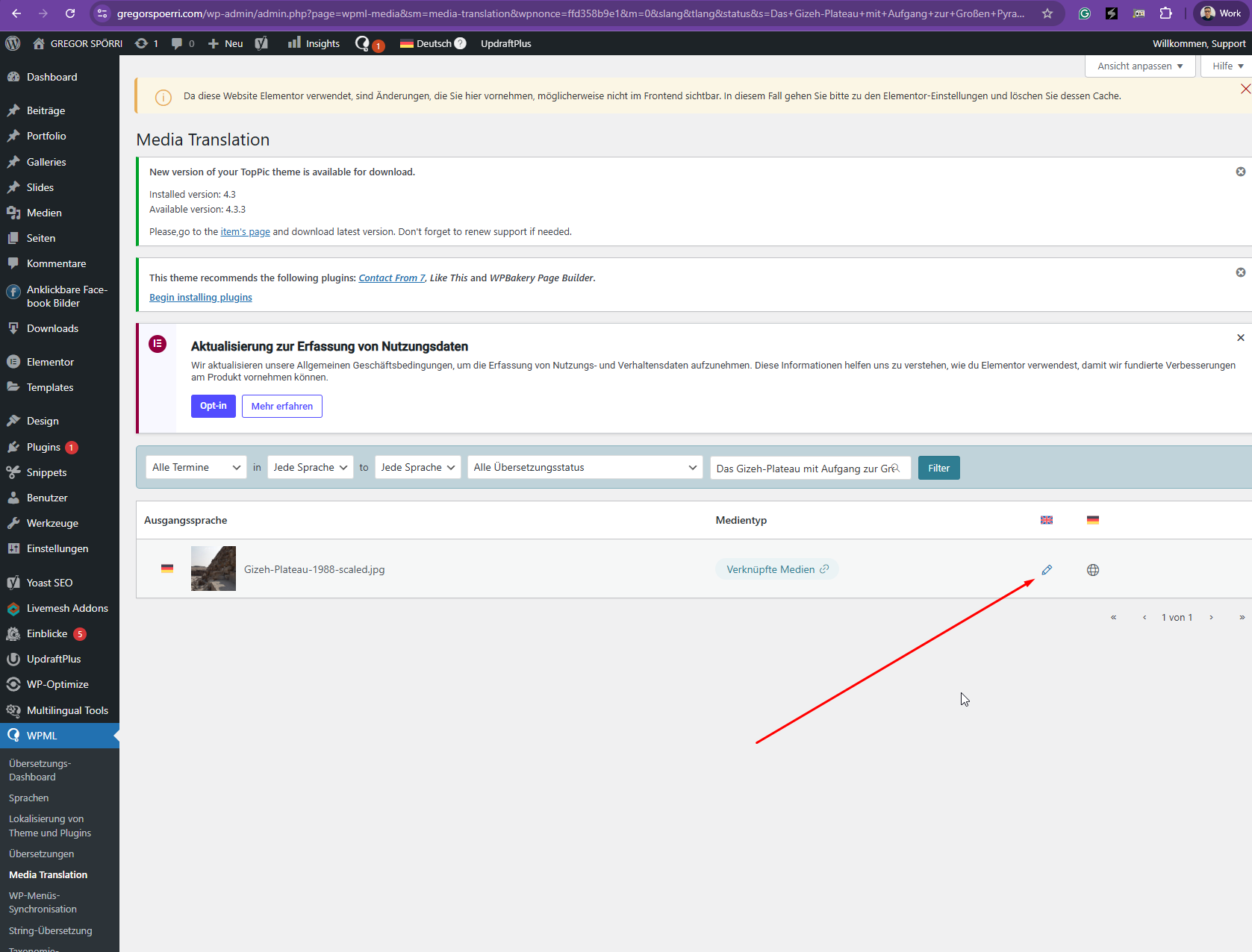

WPML Supporter since 08/2022
Thanks for your reply. Could you please try translating the media information using the Media Translation as shown in the attached screenshot here? hidden link

pascalB-17
Hi Kor
Thanks for the update. I did that and after cleaning the elementor cache it did show the translation.
BUT what's the point of having an advanced translation editor containing the images where everything is automatic when I have to go through the media translation and then clean the elementor cache?
So this is not a satisfying solution...
