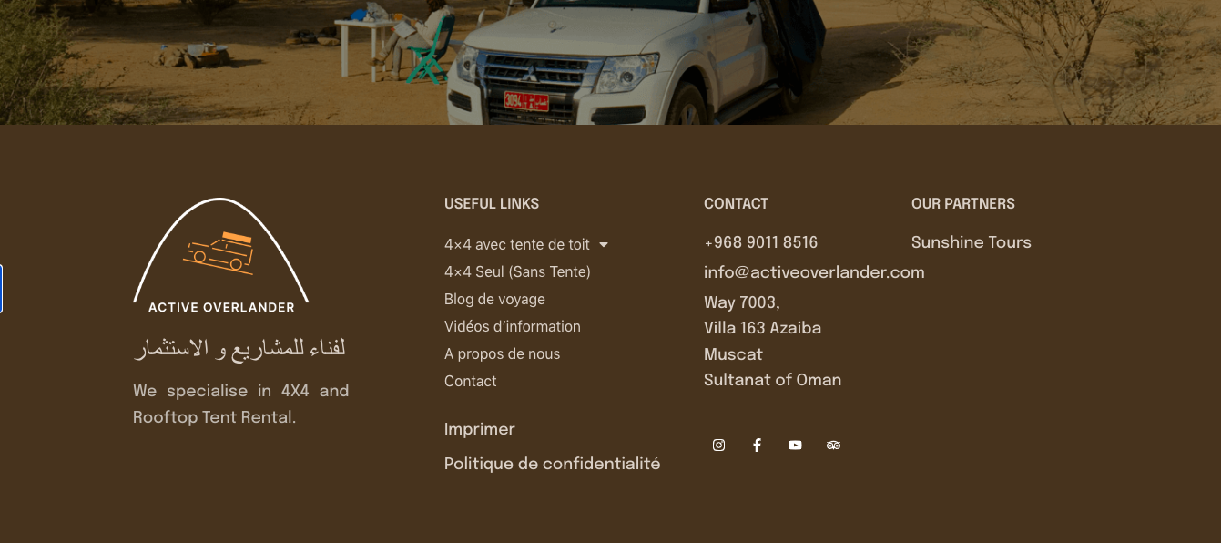

There is a bug in Menu Widget in Footer - first it didnt display in DE and FR and now when i tried to rechoose the Menu in this widget in EN original language FR menu showes up.

Thanks for your patience. I checked further and found the cause of the issue.
You are adding script code inside an Elementor HTML widget. This is not expected behavior for WPML translation tools, as they are designed to handle standard HTML content. Adding custom script code inside Elementor builder content can cause issues during translation.
<![CDATA[<script type="application/ld+json">
  "@context": "<em><u>hidden link</u></em>",
  "@type": "AutoRental",
<!-- wpml:html_fragment </script> -->
When I remove the script from the widget, everything works correctly.
In your case, the best approach would be to move that custom code into a small PHP snippet and include it via a shortcode or hook instead of placing it directly inside the Elementor content.

The script is inserted inside an HTML widget in footer template. When WPML Advanced Translation Editor (ATE) processes the content, it parses and restructures HTML. Script inside editable content (like HTML widgets) are not supported and can break the translation structure like it happens with your translated footer template.
ATE is designed to translate text content, not to safely handle JavaScript code inside editable HTML blocks. Because of this, including <script> code inside a template’s HTML widget is not recommended and can lead to broken translation jobs.
