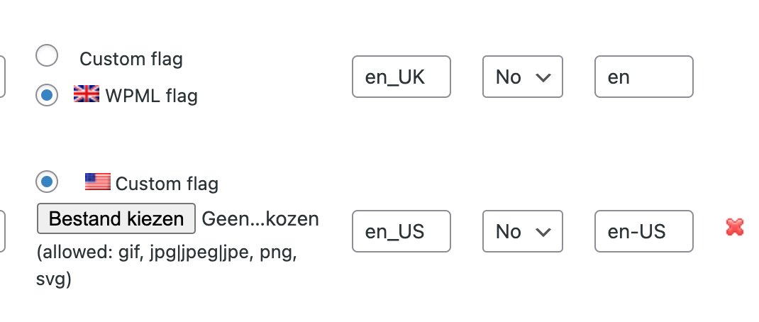

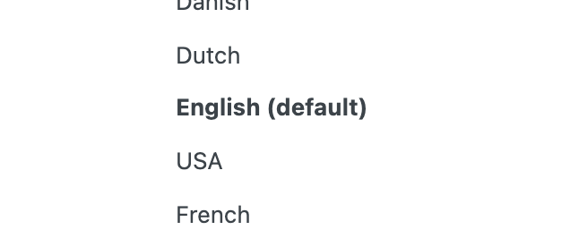

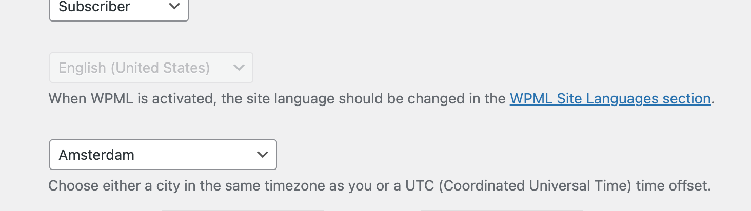

In WordPress under general option Site language shows that this setting should be changed by with WPML.
in WPML default language is english with language code en_UK.
So question is why it's showing wrong code?

Thank you for the info. I was testing your site with various languages yesterday and I was surprised to find that with FR language, the og:locale was correct (see image).
Yet, with the various EN versions, the og:locale was as you had described. This led me to do more digging and I found the following older ticket that may still apply in your case:
https://wpml.org/forums/topic/language-code-in-html-and-in-meta-property-for-a-personalized-language-created/#post-674206
On short, the code in the plugin is doing a kind of validation against it´s own list of locales. If the locale is not valid, it will set it to a default value - perhaps the WordPress default in the database (not the WPML override).
However, this morning, the same FR site is now returning og:locale of nl_NL so I wonder if you have been doing your own testing/changing.
In any case, I offer this as input to what might be happening. We can replicate this on a sandbox site and escalate if you feel this is a WPML bug. Please let me know and I will prep a sandbox site and ask you to upload and configure WP SEO to show the same issue there.
