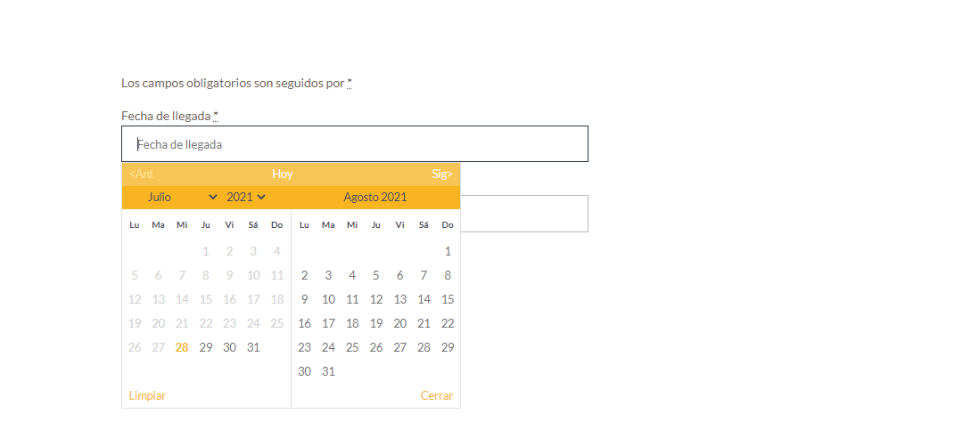

On the accommodation search widget in translated page, i want to see the calendar
I have followed your help on another post, but it doesn't work.
Is there a similar example that we can see? - calendar on EN site works fine here: hidden link, but calendar on ES site doesn't appear
hidden link - what is strange is that the calendar appears on the ES home page, where there is a general (non ID driven) widget.

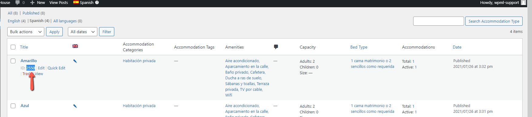

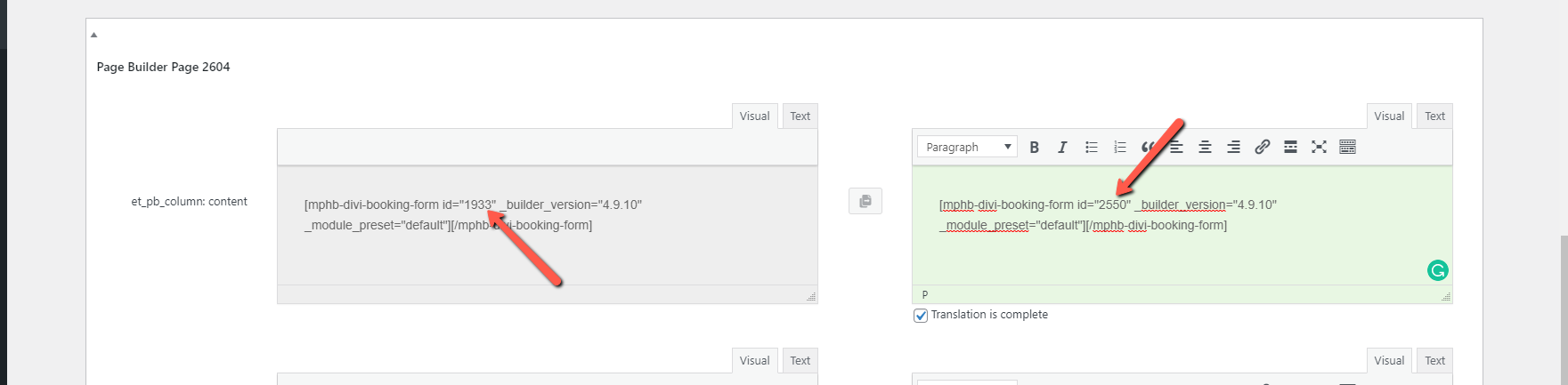

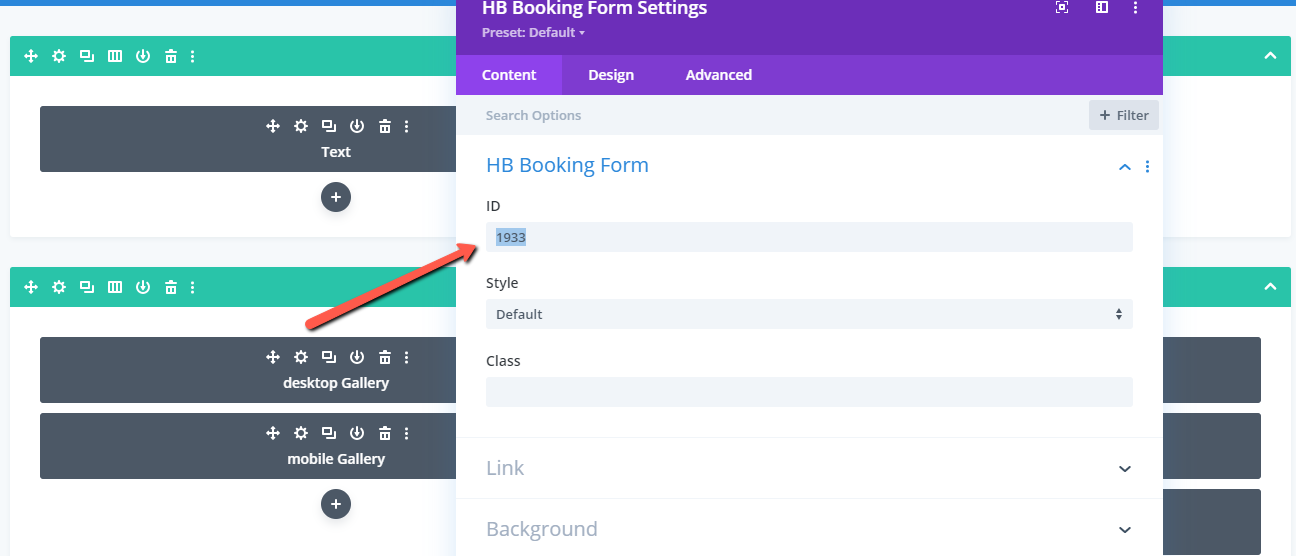

Thank you for the updates and login information. I created a page as private for testing and it works as expected when I specify the ID of translated Accommodation post. Please check the following Page URL and attached images for more details.
It looks like a compatibility issue and translated Accommodation post ID is not synced in Spanish Pages. Therefore please change the Accommodation post ID manually on the Spanish page after a site backup and make sure the issue is existing or not.
