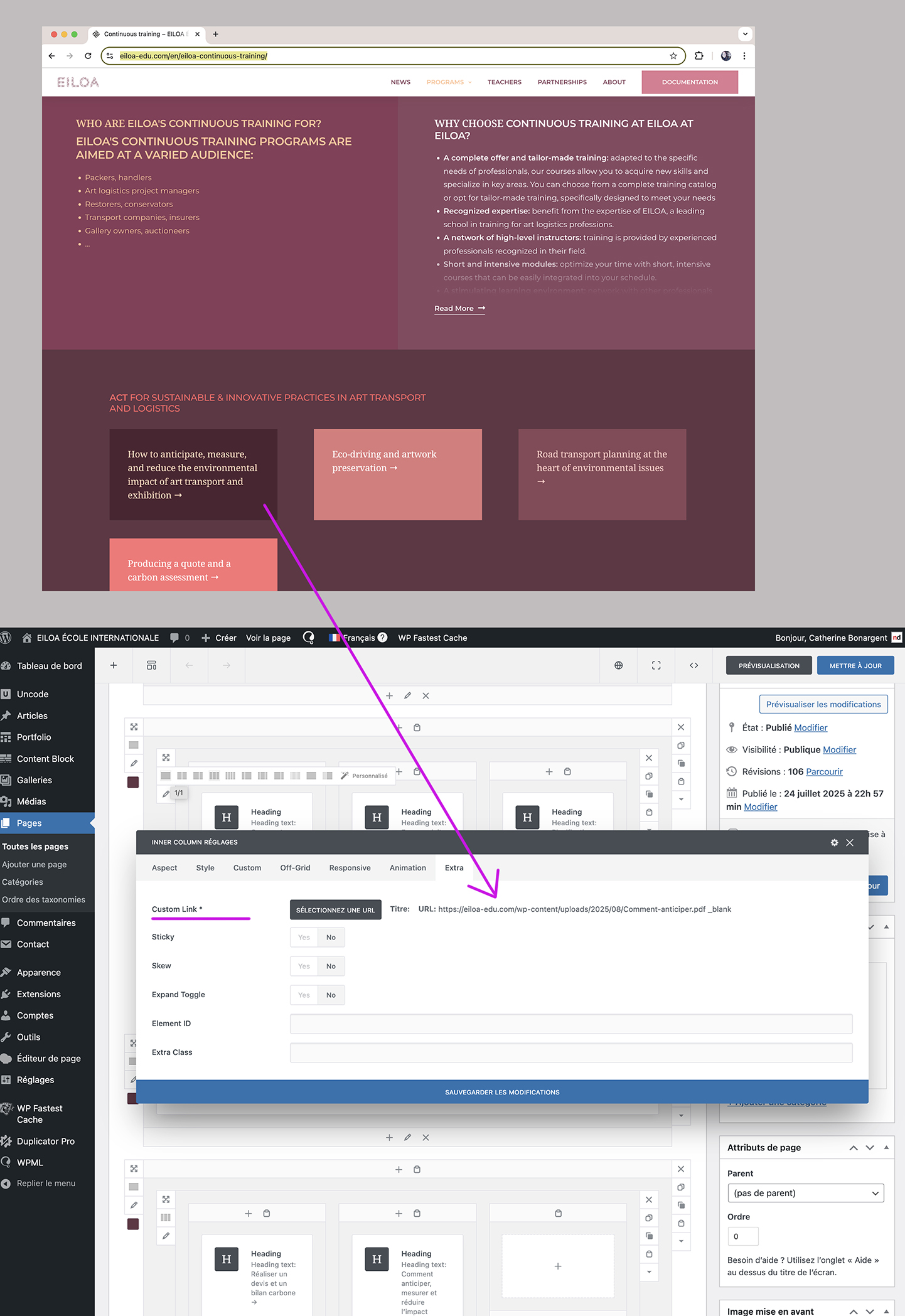

I've finished the translation on the site but there are some links that don't appear in the Advanced Editor or in the string translations. It is the colored blocks on this page which each have a link when you click on them.
See capture below. Each colored 'block' is a column in a row, with a text block inside. The link is associated to the column, not the text.

WPML doesn't see the links, even when the tag is vc_column_inner
Thank you for your help!

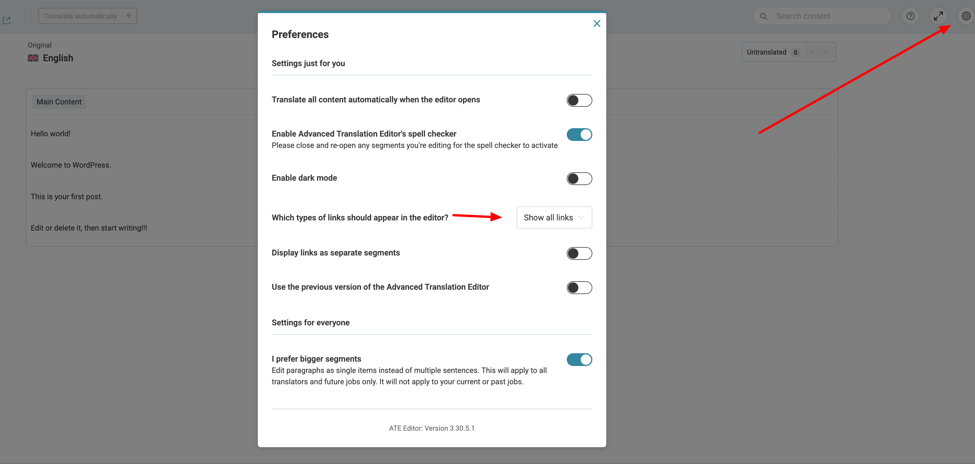

Have you tried, just for testing purposes, enabling the option to display all links in the Translation Editor settings?
You might need to make small changes to the original page, update it, and go to the Translation Editor.
I’ve attached a screenshot to show where this option is located.

I enabled the option to display ALL URLs, and then made a small change to the page, but the URLs do not show up in the Advanced Editor.
