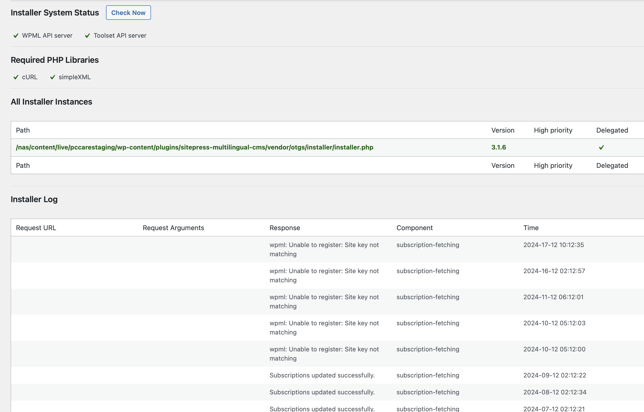

I pushed a newer copy of production to staging, which is hosted on wpengine.com. My settings show that this staging site is linked. The issue can be seen at: hidden link.

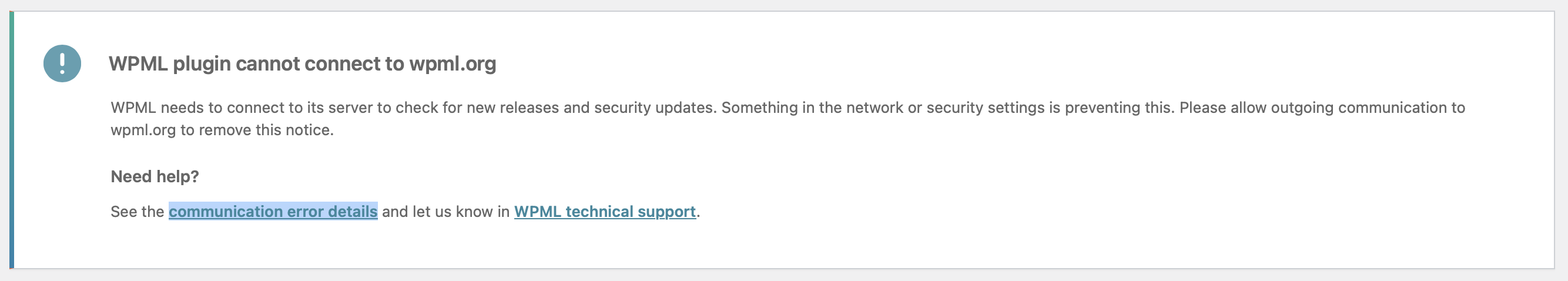

I see the following message in my dashboard: 'WPML plugin cannot connect to wpml.org. WPML needs to connect to its server to check for new releases and security updates. Something in the network or security settings is preventing this. Please allow outgoing communication to wpml.org to remove this notice.' Additionally, I got a communication error details report: 'wpml: Unable to register: Site key not matching.'
How can I reconnect the staging site to WPML?
What might be causing the site key not to match after pushing a new copy to staging?
