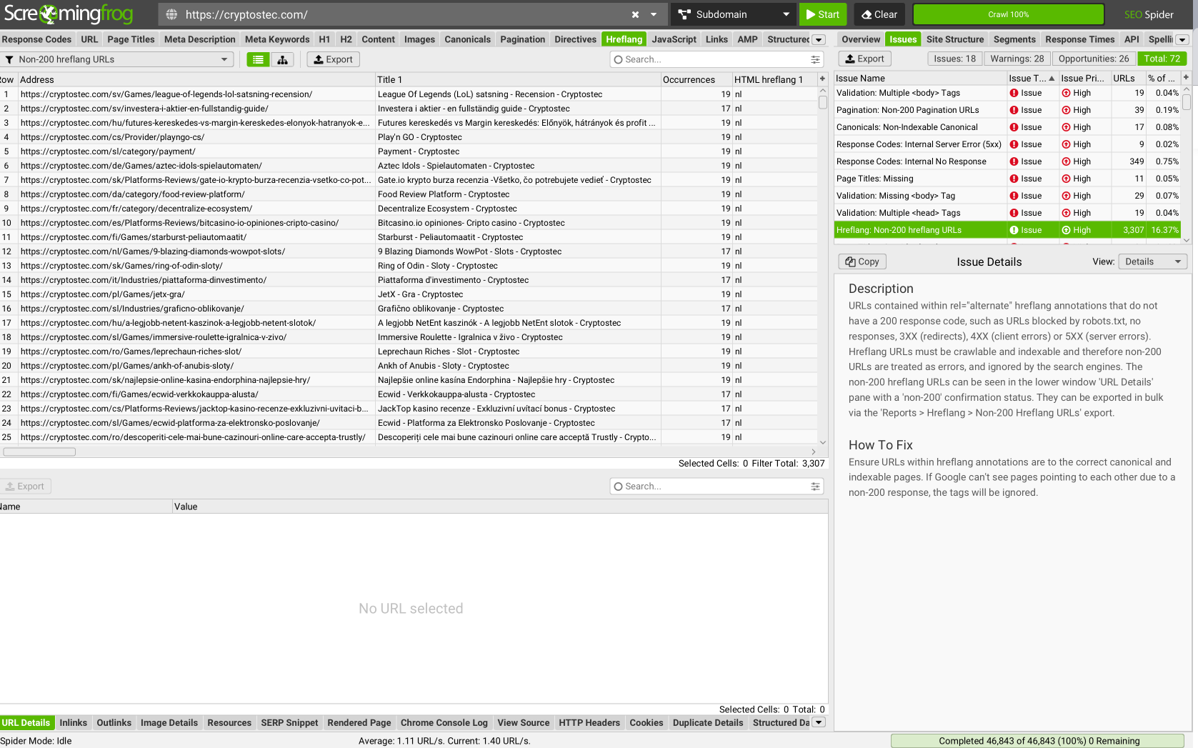

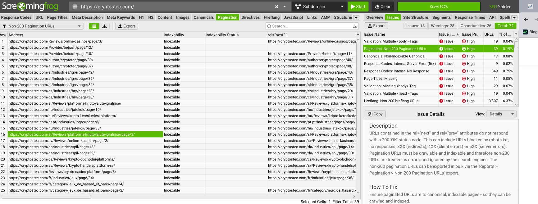

Tell us what you are trying to do? reduce seo technical issues
Is there any documentation that you are following? using screamingfrog
Is there a similar example that we can see? hidden link
What is the link to your site? cryptostec.com
May 26, 2024 at 7:35 am #15670666
zarihounT
I also noticed Non=200 hreflang urls, which is affecting 16% of all website, a total of 3307 urls affected by this.

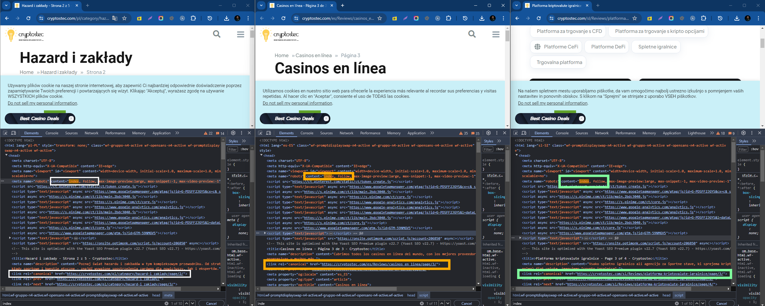

Hello There,
I understand the issue you're facing. The screenshot from Screamingfrog indeed highlights some SEO issues. However, after checking the paginated pages you provided, I noticed that the SEO information is correctly added on each of these pages. Specifically, the canonical and indexing information is properly tagged. Please refer to the attached screenshot and pay attention to the marked points.
Therefore, the SEO issues shown by the Screamingfrog platform could be a false-positive notification. Please try clearing the caches from your site and browser, as well as the WPML caches by navigating to WPML > Support > Troubleshooting. After doing this, resubmit your site to Screamingfrog and check if the issue persists.
Let me know the update. I will be happy to help if you need further assistance in this matter.

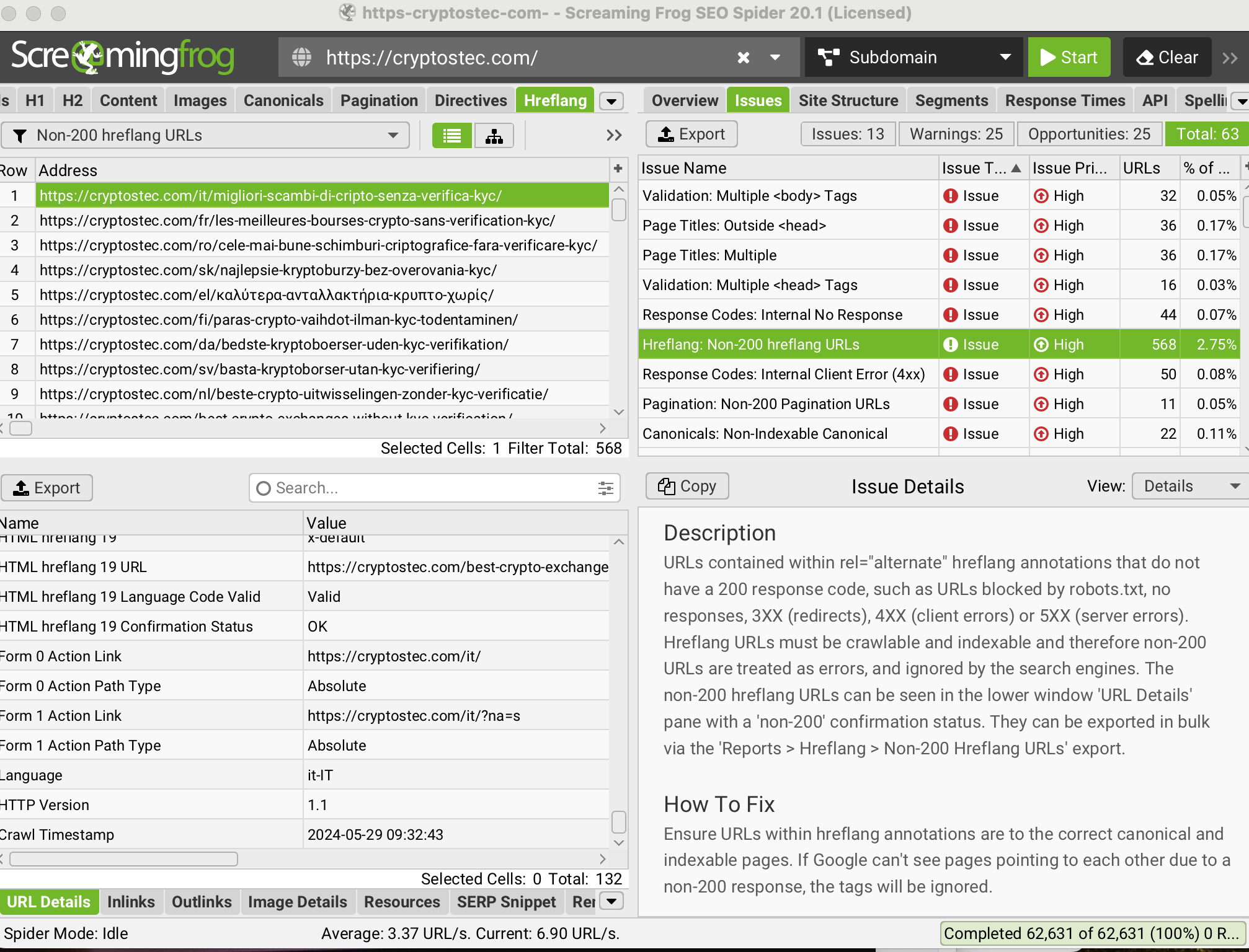

May 29, 2024 at 1:12 pm #15683989
zarihounT
I followed your instruction, it now down to 568, is there a reason it wasn't fix for all pages?
May 30, 2024 at 5:55 am #15685825
Prosenjit Barman
WPML Supporter since 03/2023
Hi There,
Thank you for the update.
As mentioned in this hidden link">guide by Screaming Frog about Non-200 Hreflang URLs, the warning primarily appears when URLs included in `rel="alternate" hreflang` annotations do not respond with a 200 status code.
This issue is triggered when URLs included in rel=”alternate” hreflang annotations do not respond with a 200 status code.
However, when I checked the links, they all loaded with a 200 status code. I didn't notice any 404 errors or redirections. For example, please check this link (hidden link), which was flagged by Screaming Frog.
Therefore, as mentioned in my first message, the SEO warnings given by Screaming Frog could be false positives. Since the SEO is correctly configured for the pages, they shouldn't encounter any issues during crawling or indexing by search engines.
However, you can reach out to the Screaming Frog support team or an SEO specialist for further verficiation. This way, we can take any necessary steps if needed.
Feel free to let me know if there is anything else I can help you with. I'll be happy to assist.
