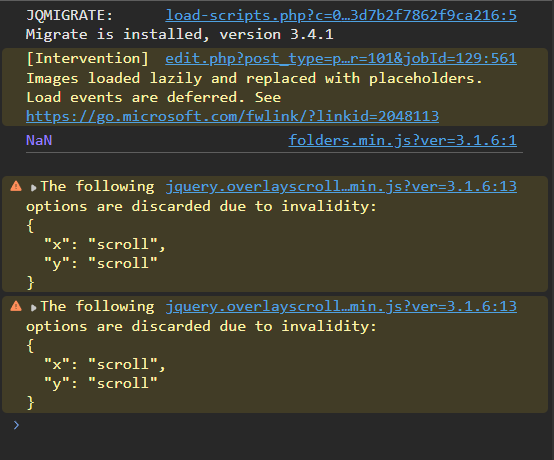

ahmedH-37
This is what i'm getting in the console tab when i click the crayon, no red messages.

Olexander Zhitskiy
I’ve checked this from our side and I don’t see any failed requests or activity related to this job — in fact, there are no requests reaching ATE when you click the crayon.

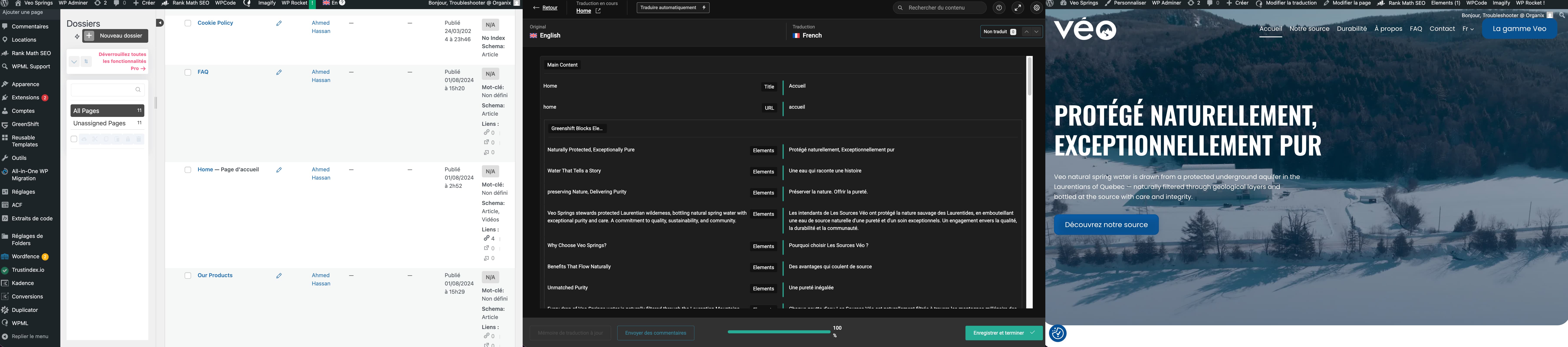

1) Thanks for the update, I restored back EN default language to the pages that had EN language setup initially(as you confirmed it is valid functionality). After that I wrote small plugin to fix stuck posts in ATE(it is located in 'Settings > WPML Post Editor Fixer'), applied fix and 'Home' page now correctly opens in the ATE editor(not Gutenberg) when we click on edit 'French' translation button from 'English' pages list.
2) Regarding broken layout issue - I see the 'French' page with translations gots 'broken layout' everytime I edit and resave post in the original 'English' language for that post. You are correct, the workaround to resave it in ATE right after works correctly.
So, you can check and open the 'Home' page in the ATE editor. I will search further why layout is broken after we save original post and update after with result.
