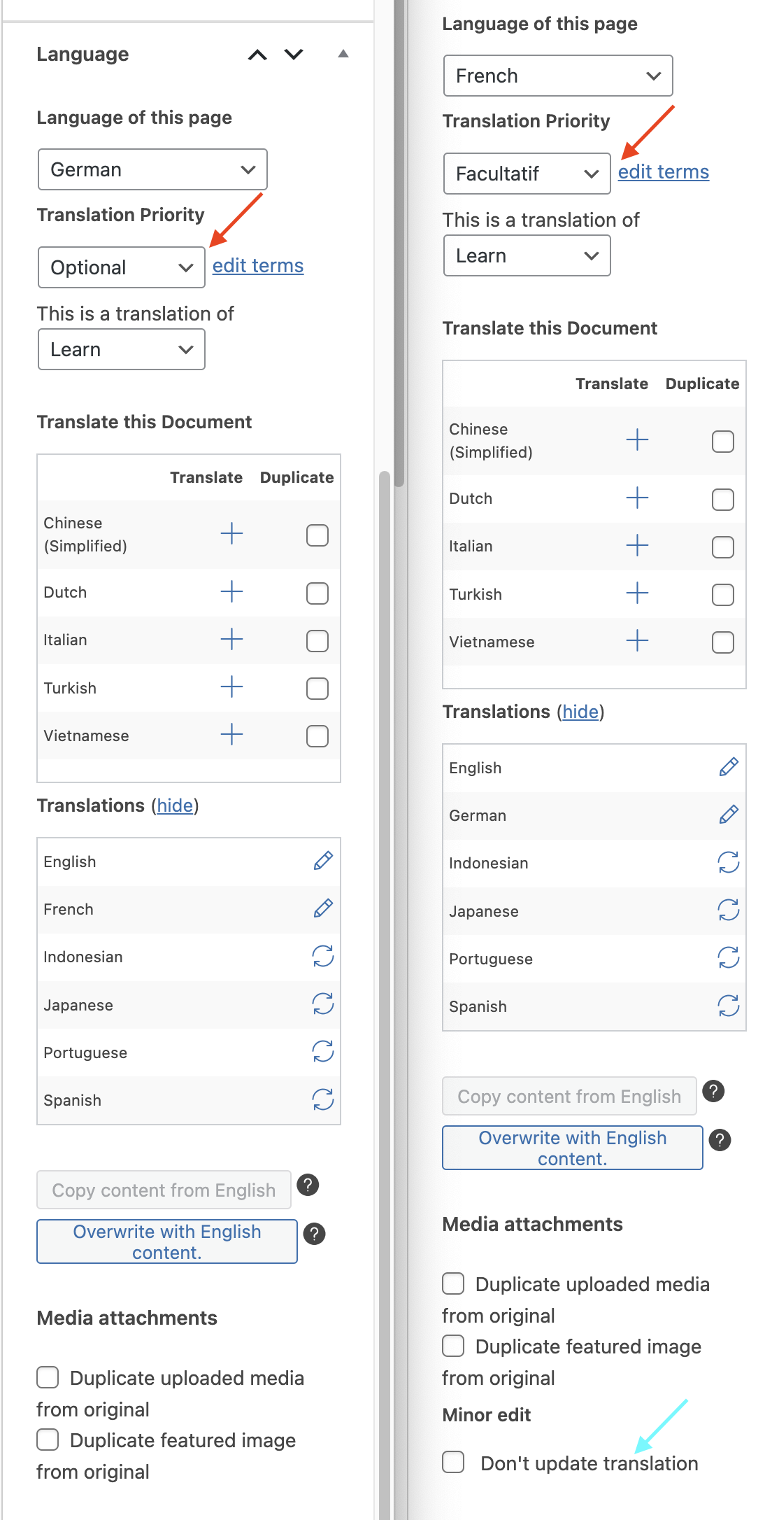

May 7, 2025 at 7:40 pm #17008732
mikeD-5
Also note that there are differences in the WPML sidebar for FR (that works as expected) and DE (which is being over-written by EN); see attached (FR on the right).
Specifically there is no button to "Translate independently"

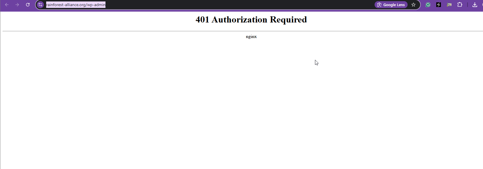

May 11, 2025 at 7:55 pm #17020656
WPML Supporter since 08/2022
Thanks for your reply. My apologies for overlooking this ticket. Not sure why I'm not getting any notifications. Could you please check why I cannot access the Website? I'm getting "401 Authorization Required" when I try to open the login page.
Maybe you can temporarily deactivate the security plugin so that I could check?

May 12, 2025 at 5:01 pm #17024102
Thanks for your reply. It looks like the "Server protection" is causing issues, and I'm able to log in now using the Firefox browser.
The "Translate independently" button will only appear if the translated page is a duplicate of the primary language, English.
