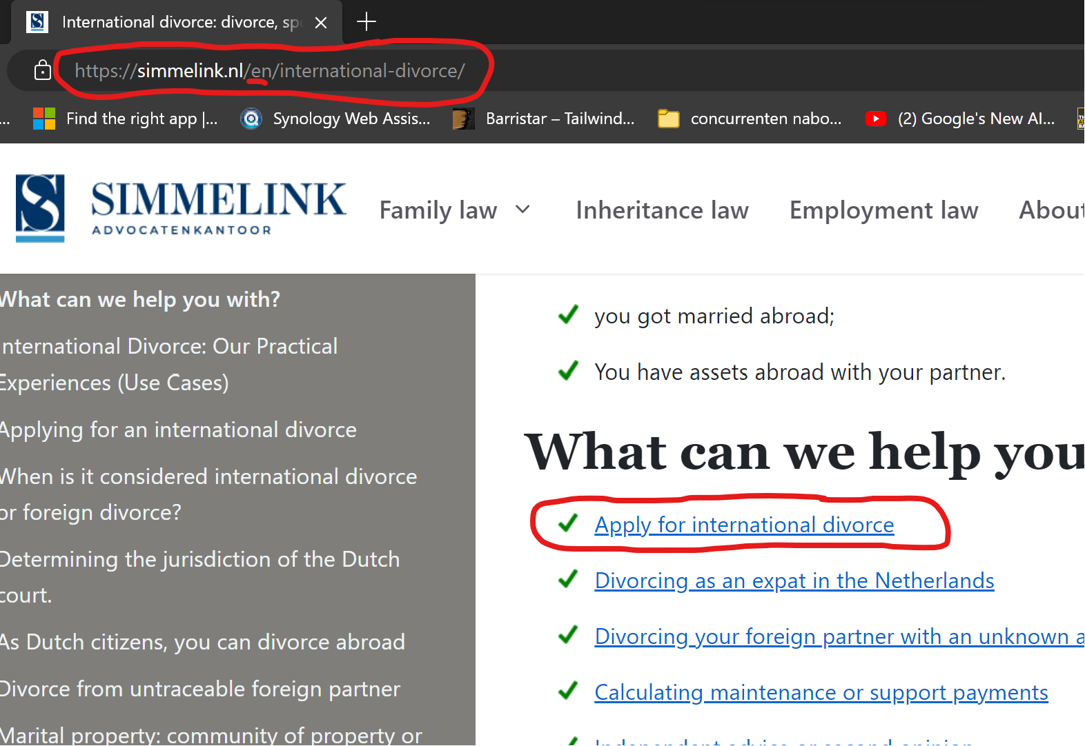

After an initial test, I already have a question due to advancing insight (see also the attached screenshot).
Example:
See the page in the secondary language (English), see attached for the URL.
This page contains references to a Dutch page (see in the screenshot the red circle). Then the href to this page is still mixed: the URL says .../en/..., but the page in question is only available the primary language.
So the "/en" part in the URL is actually incorrect because the language is only available in the primary language.
How can I fix this?

Hi Henk,
I hope you're doing well.
If you're still using the "Translatable-use translation if available or fallback to default language" settings for the "Pages", the way it is appearing is expected. Since that particular child page hasn't been translated into English yet, the Dutch contents(along with the slug) are showing as Fallback. So, the way it is appearing now is expected.
If the Translation preference is set to show only translated content, the link should direct to the translated version exclusively. Otherwise, it should lead to the Dutch version, omitting the "en" code in the URL. In that case, here is what you've to do:
- Please make a small edit to the default page.
- Save the changes and update its translation.
- Once the translation is updated, check the English version of the page.
If the corresponding page with the link is translated, then the link should be updated with that translated version of the page. Otherwise, you'll see the default version without the language code in the URL.
Please let me know if that helps or if you need further assistance in this matter. I will be happy to help.
