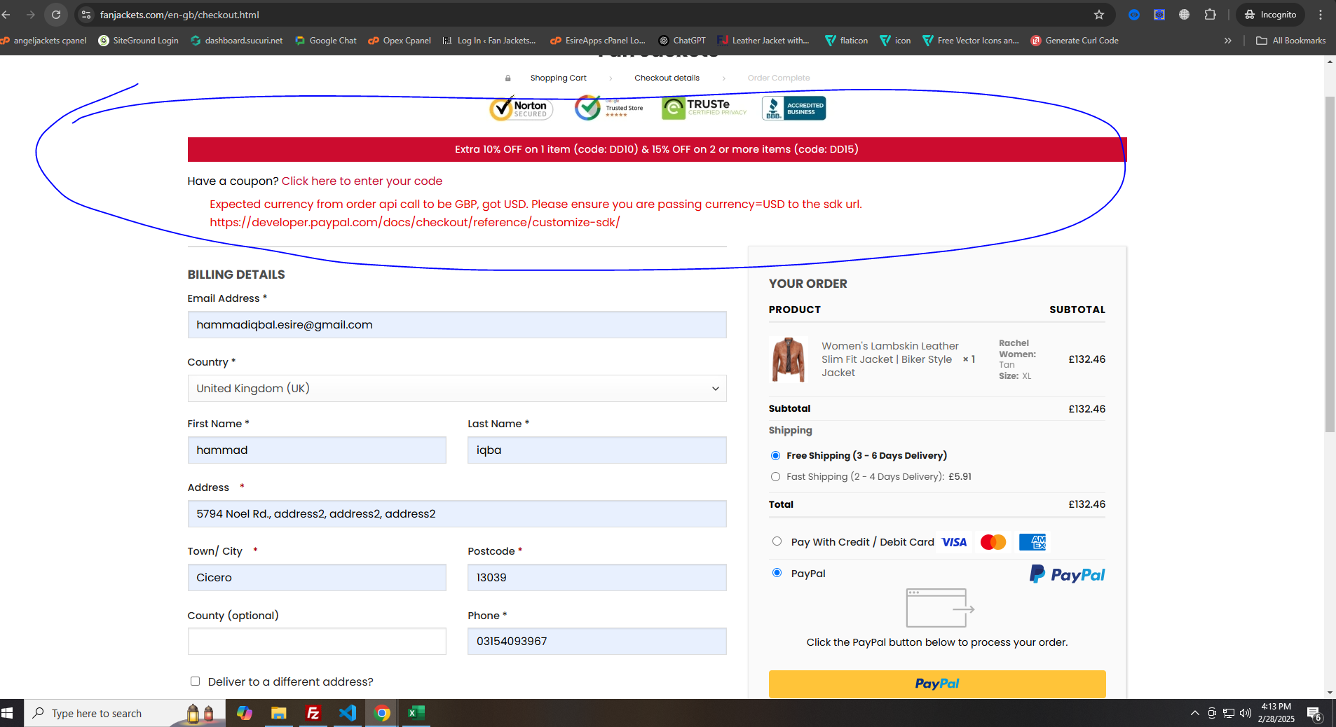

I created 3 stores using WPML, with the default being US and the other two being UK and AU. In the UK store, at the time of checkout, I encountered an issue with PayPal. The issue can be seen on this page: hidden link. I expected to see: <script src="hidden link"></script>.
When I click on PayPal during checkout in the UK store, it shows the error: 'Expected currency from order api call to be GBP, got USD. Please ensure you are passing currency=USD to the sdk url.' Instead, I got: <script src="hidden link"></script>.

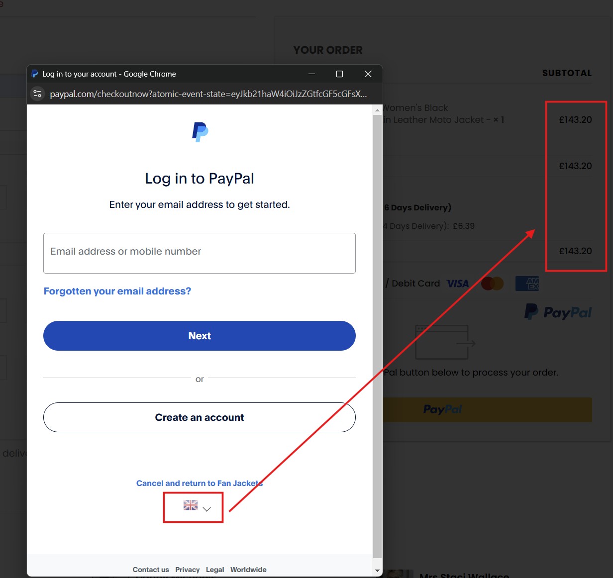

Thank you for contacting the support and our apologies for delayed response due to current work load in the support.

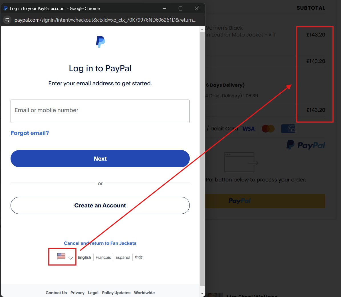

I just checked your site but unfortunately I don't have a PayPal arrangement to check for the issue. However, I observed that I saw prices in GBP and after clicking the PayPal button, I saw GB as the selected location as well.
However, when I changed the location in PayPal popup to USA, cancelled and returned, the prices were in USD on the cart.
So can you please check that when you click that PayPal button, do you see the correct location in PayPal popup? Or does changing that makes any difference anyways?

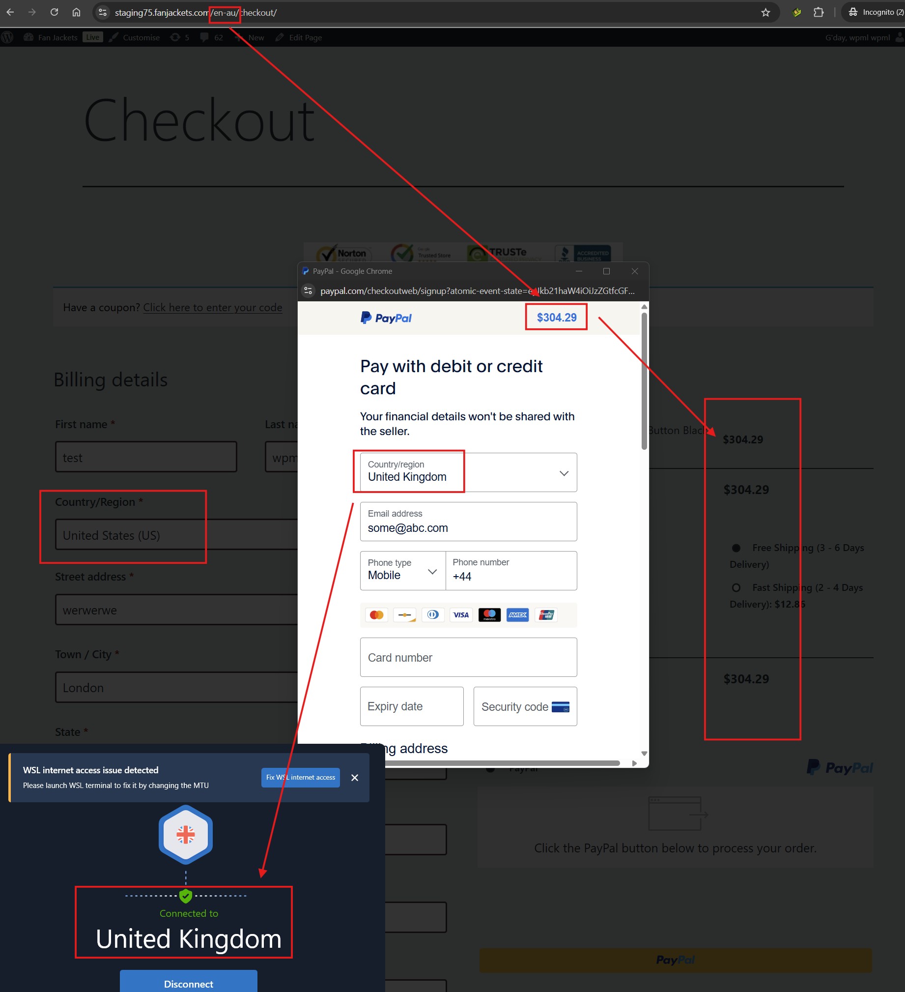

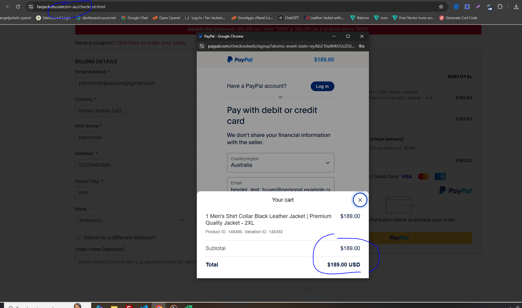

I'm currently facing an issue on the checkout page. For example, when a customer lands on the en-au or en-gb market, everything works fine, and the currency changes correctly. However, when I proceed to the checkout page, enter my details, and click on PayPal, I receive the following error:
For en-au: "Expected currency from order API call to be AUD, got USD. Please ensure you are passing currency=USD to the SDK URL."
Reference: PayPal SDK Customization
For en-gb: "Expected currency from order API call to be GBP, got USD. Please ensure you are passing currency=USD to the SDK URL."
Additionally, when I refresh the checkout page, the currency reverts to USD instead of displaying the correct currency for the selected market (for example, AUD for en-au).

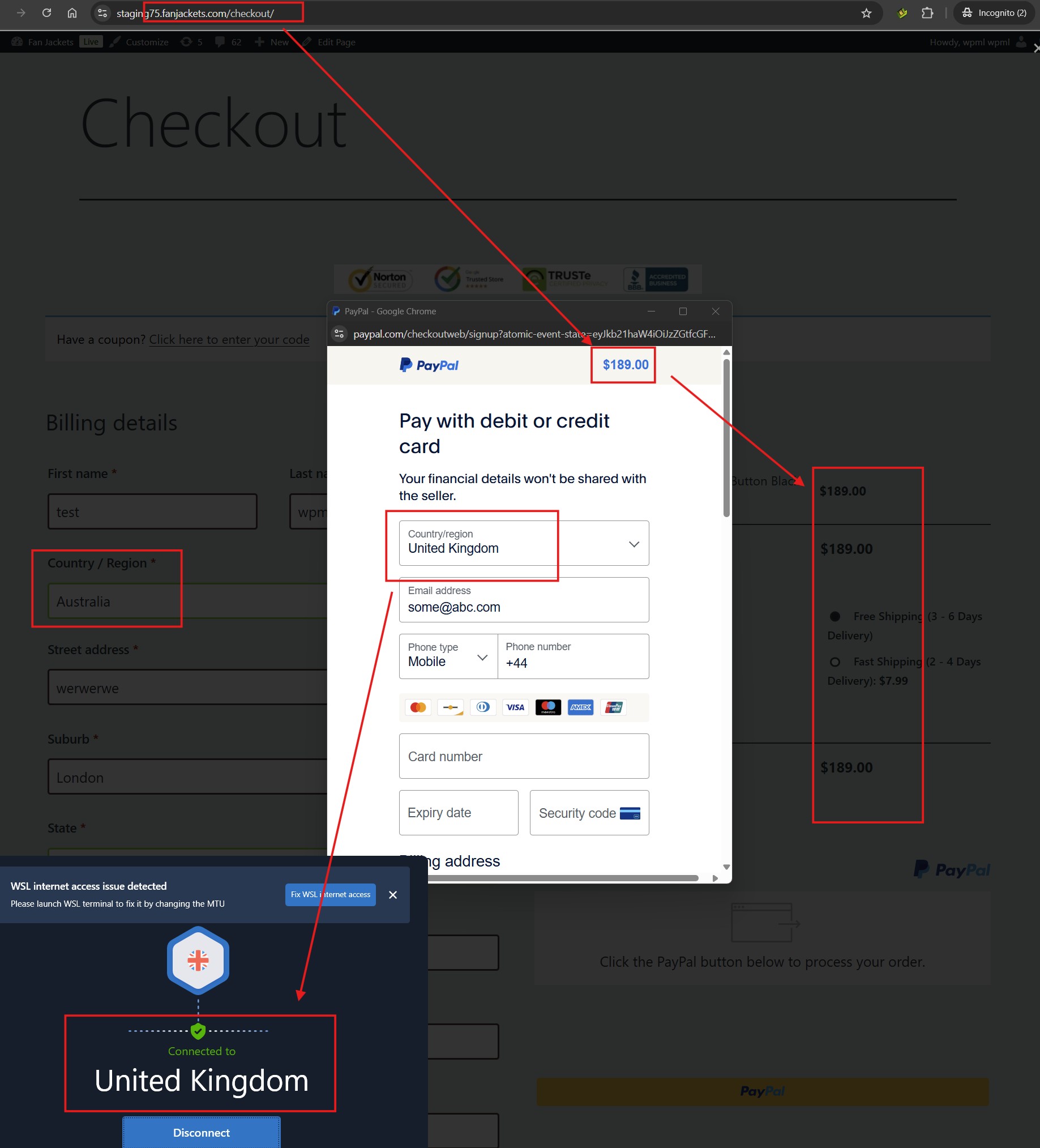

I checked your video and then tried to reproduce the same in your staging site but this seems to work fine for me. I've tried connecting to Australia via VPN, as well as, my default location (without VPN) and in all cases I couldn't see that error.
Here's my screen recording: hidden link

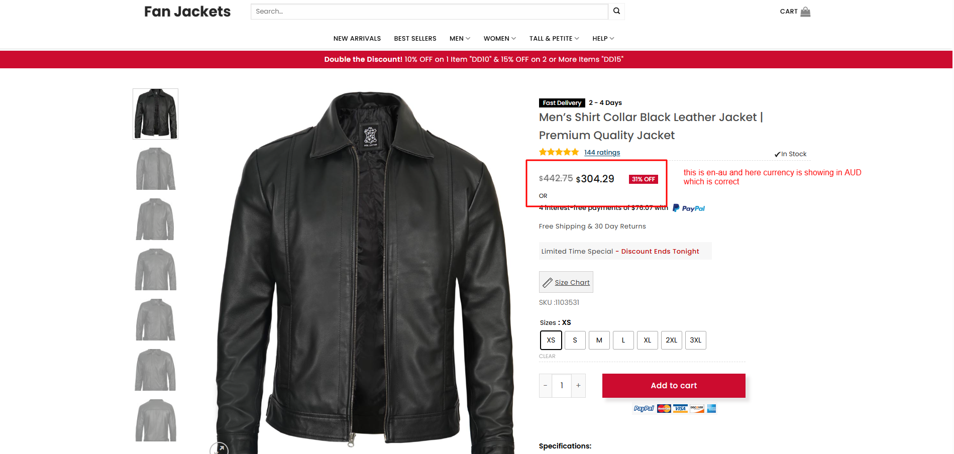

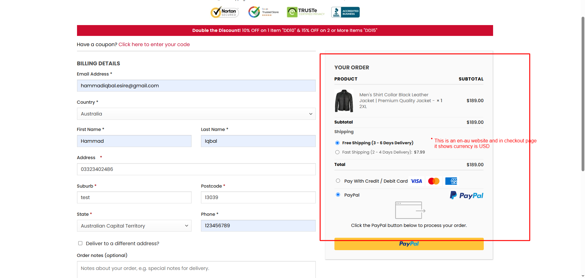

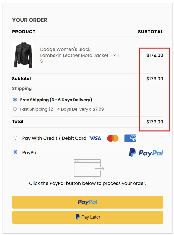

I have reviewed the video you provided and noticed that while you're checking the country settings, the issue seems to lie with the currency configuration. In your video, I observed that on the checkout page, when selecting the en-au language, the currency is still showing as USD instead of AUD. Similarly, when the en-gb language is selected, GBP is displayed instead of the expected currency.
I’ve attached a screenshot for further clarification on the issue.
Could you kindly assist me with a more accurate solution for this? I would appreciate your guidance on resolving this issue as soon as possible.

Thank you for you patience and cooperation. I was able to reproduce the issue after several retries.
And I guess the issue is somewhere else and perhaps a confusion is being created between USD and AUD (both have $ sign) at time of checkout. GBP works fine, even conversions between all these currencies is fine.
Only it happens when trying to switch between USD and AUD. AUD taking precedence, although for a brief moment USD price is shown too. And that's when logically USD was selected but prices were shown in AUD, the said issue happens with PayPal.
IMO, problem is even before that.
I'm working more on it and 'll try to reproduce in a fresh site as well. Please keep your staging site as it is. I've deactivated several plugins and have switched themes. I need to recreate the same setup, so I request to left the staging in current state. I'll update you accordingly.

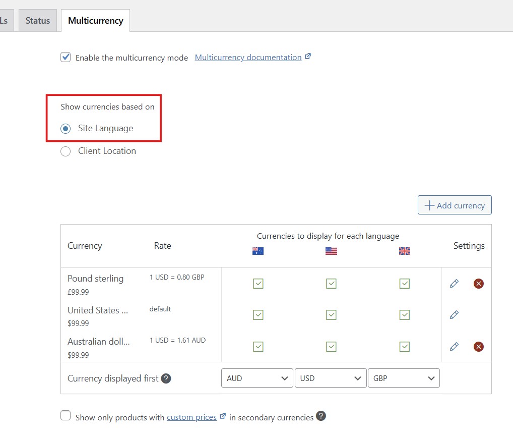

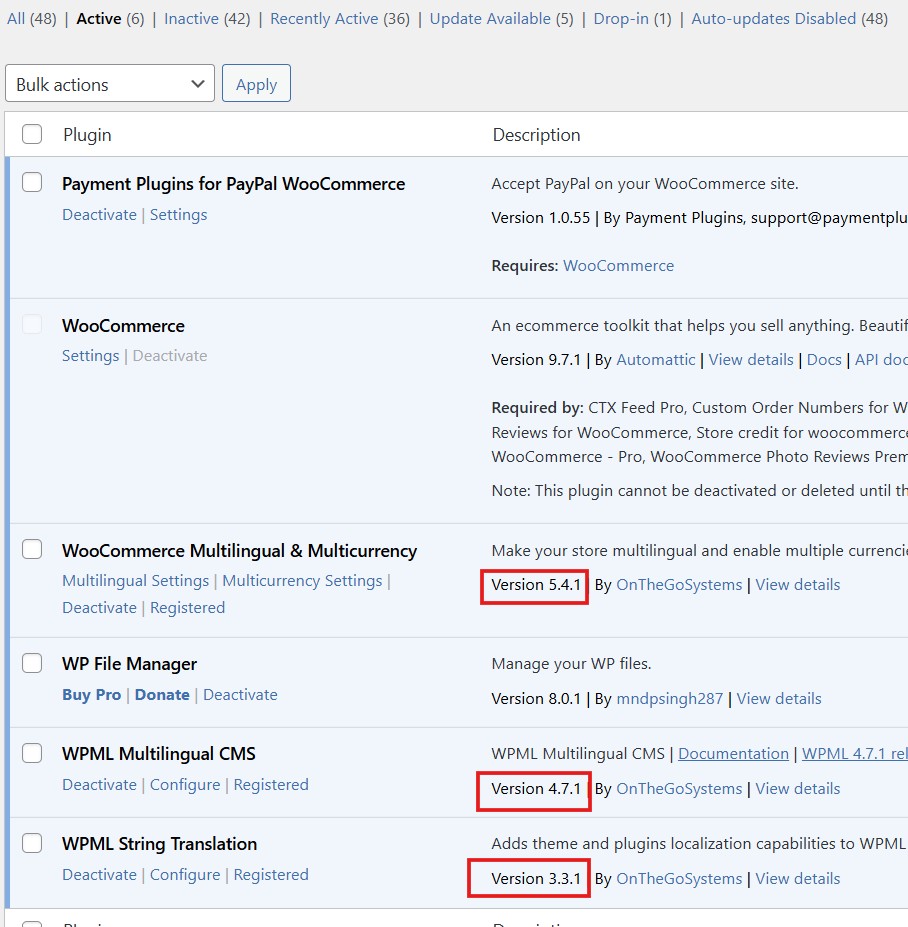

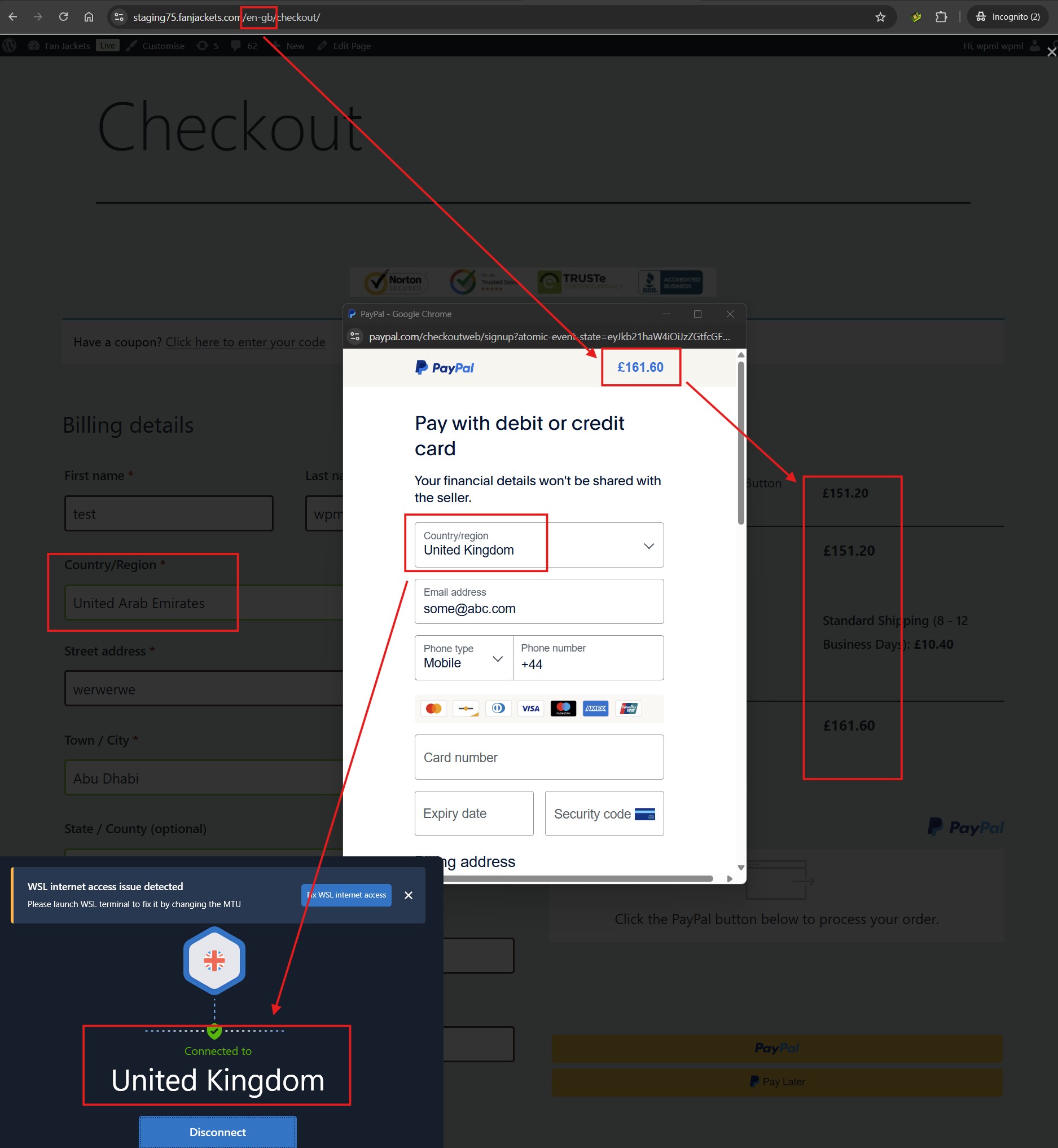

I tried to reproduce the issue in another site where it worked fine because of the plugins difference. So I then updated WPML, String Translation and WCML plugins (as recommended earlier) in your staging site, deactivated the plugins and reactivated to clear any plugin cache, as well as, cleared browser caches.
After that when I rechecked for the issue, it is working just fine in your staging site. At the moment only required plugins are active with a standard WordPress theme like 2021.
I've attached a few images for reference. You can see that regardless of my location, the prices are shown based on the "Site Language" (as per multicurrency settings). And same is reflected in the PayPal popup.
