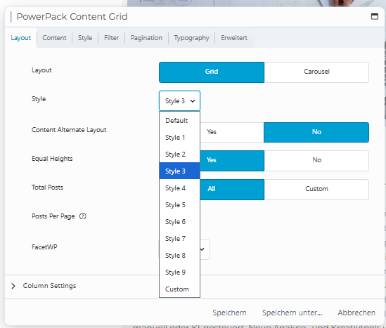

Regarding the custom code:
On our live site, the PowerPack module includes an additional style option called “Custom”, where we insert our own layout/code. This option is currently missing in the sandbox environment, which is why I wasn’t able to recreate our exact setup.
I’ve attached a screenshot showing how it looks on our end.
I’ve also added the translation for the test page so you can now check the modal behavior on the translated version.
Kind regards
November 25, 2025 at 12:09 pm #17607927
Bruno Kos
To properly investigate the issue, could you please let me know if it’s possible to enable or add the “Custom” style option for the PowerPack module in the sandbox environment? That would allow me to recreate your exact setup.
If that’s not possible, would you be willing to provide temporary WordPress admin and FTP credentials so I can investigate the issue directly?
