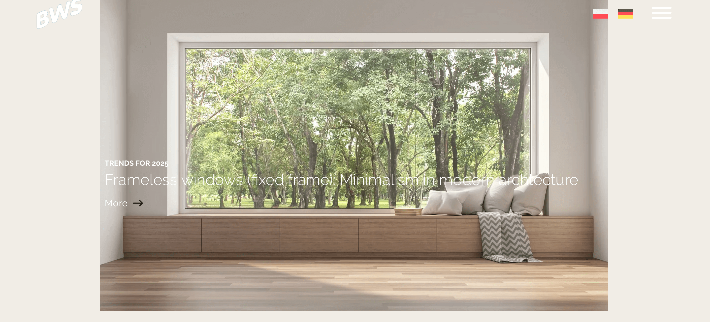

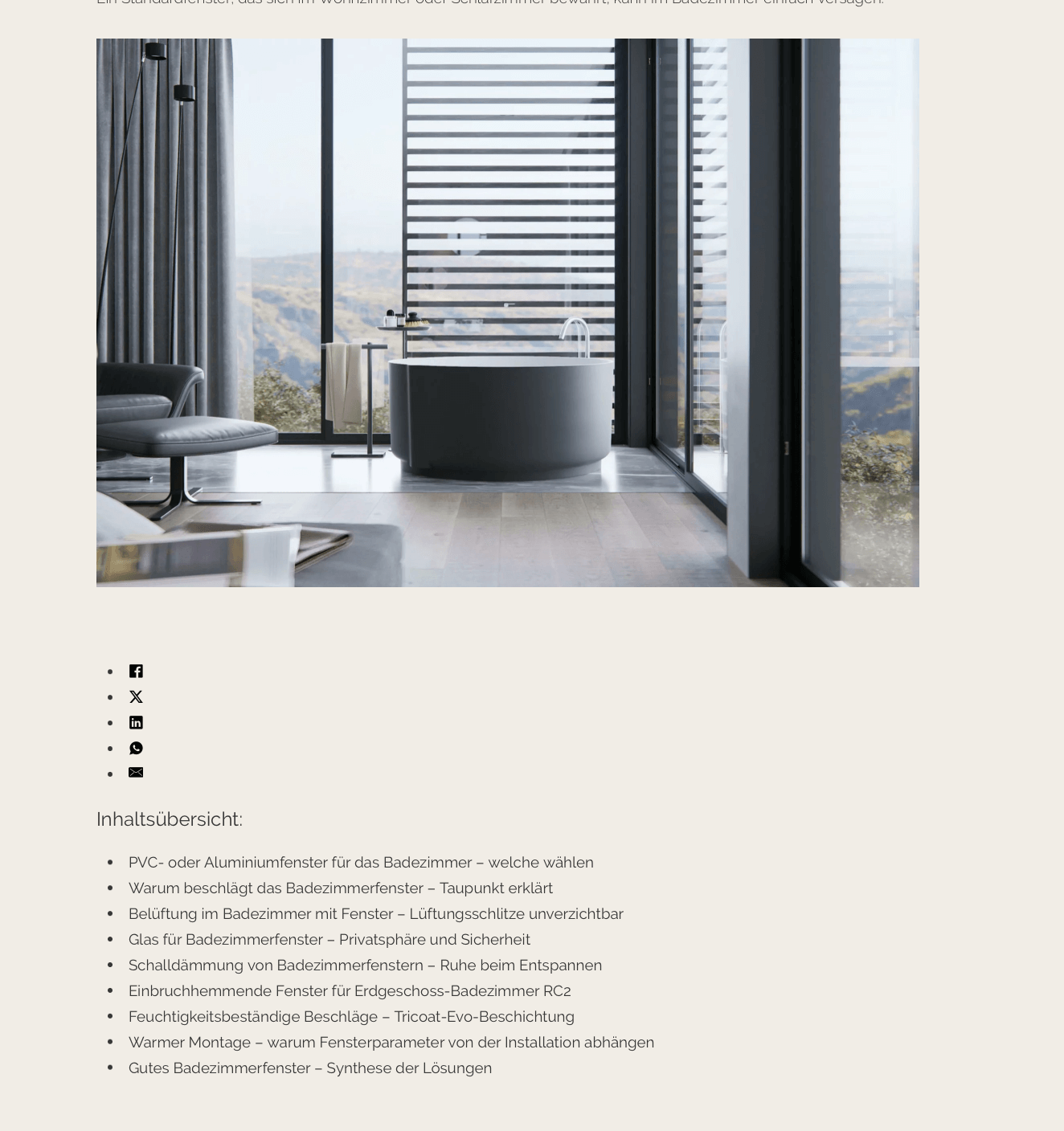

I attached a screenshot of how the translated website: hidden link . The original polish site is displaying correctly, but both translations (English and German) are showing with wrong layout or no layout hidden link. The template I'm using for blog posts is: hidden link. The template in German language shows like this on posts (I attached a screenshot): hidden link, English one is now correct, but that happens on both translations.

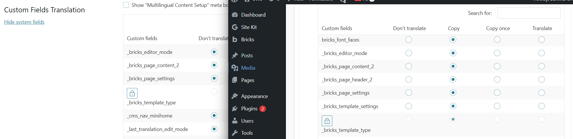

Thanks for your reply. This is what our 2nd Tier Support has done to fix it.
If you edit the PL post, you'll see that it doesn't use the bricks builder directly. Instead, it uses a bricks template (for all blog posts). So resaving the original template and its translations
Could you try this on your production site? Please remember to backup first.

Thanks for your patience. Our 2nd Tier Support mentioned that the issue is caused by the translation settings in WPML > Settings > Custom Field Translation is being modified when comparing with the sandbox site that I've prepared.
They changed the settings back, and you'll need to resave the templates and translations to fix it.
