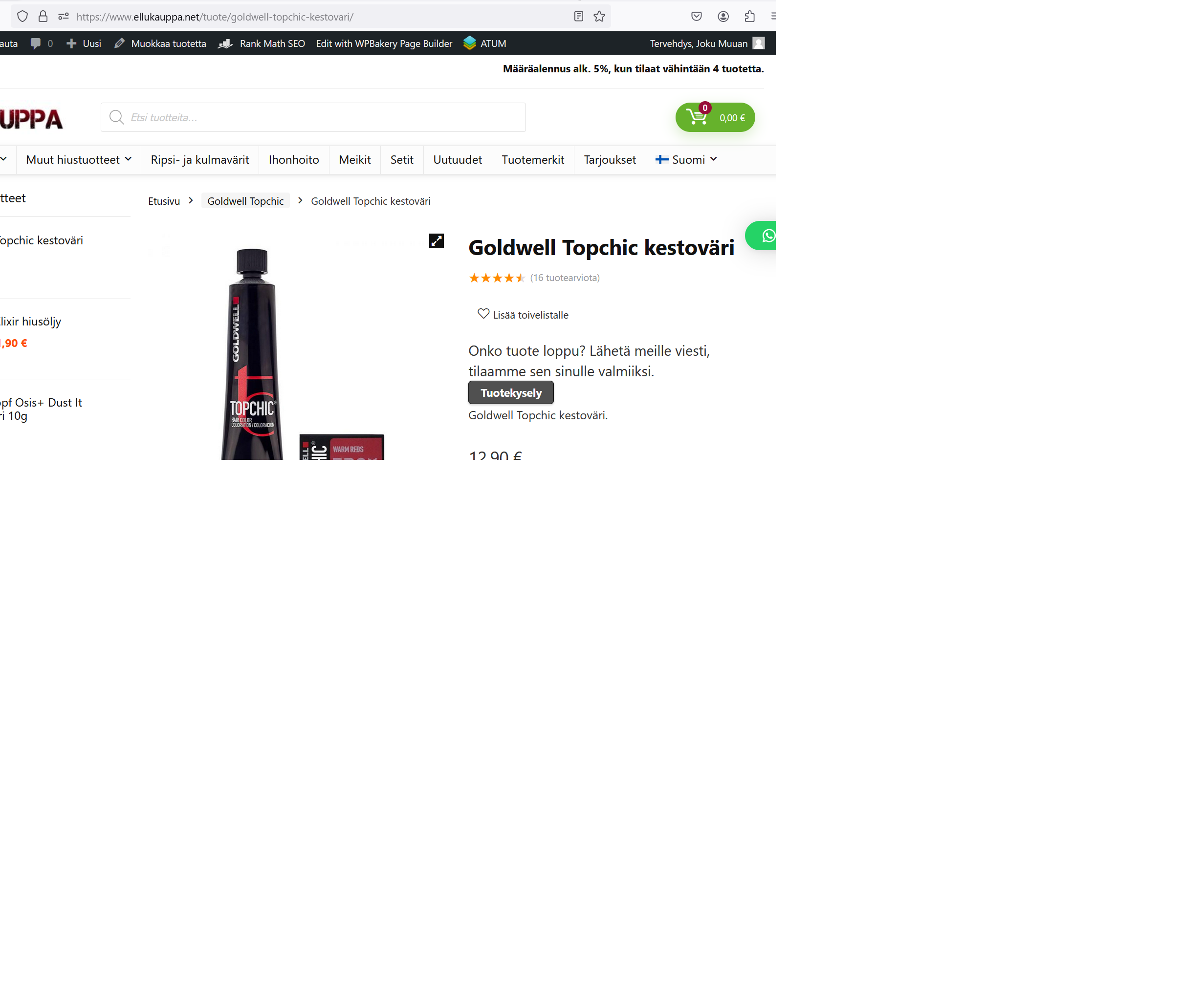

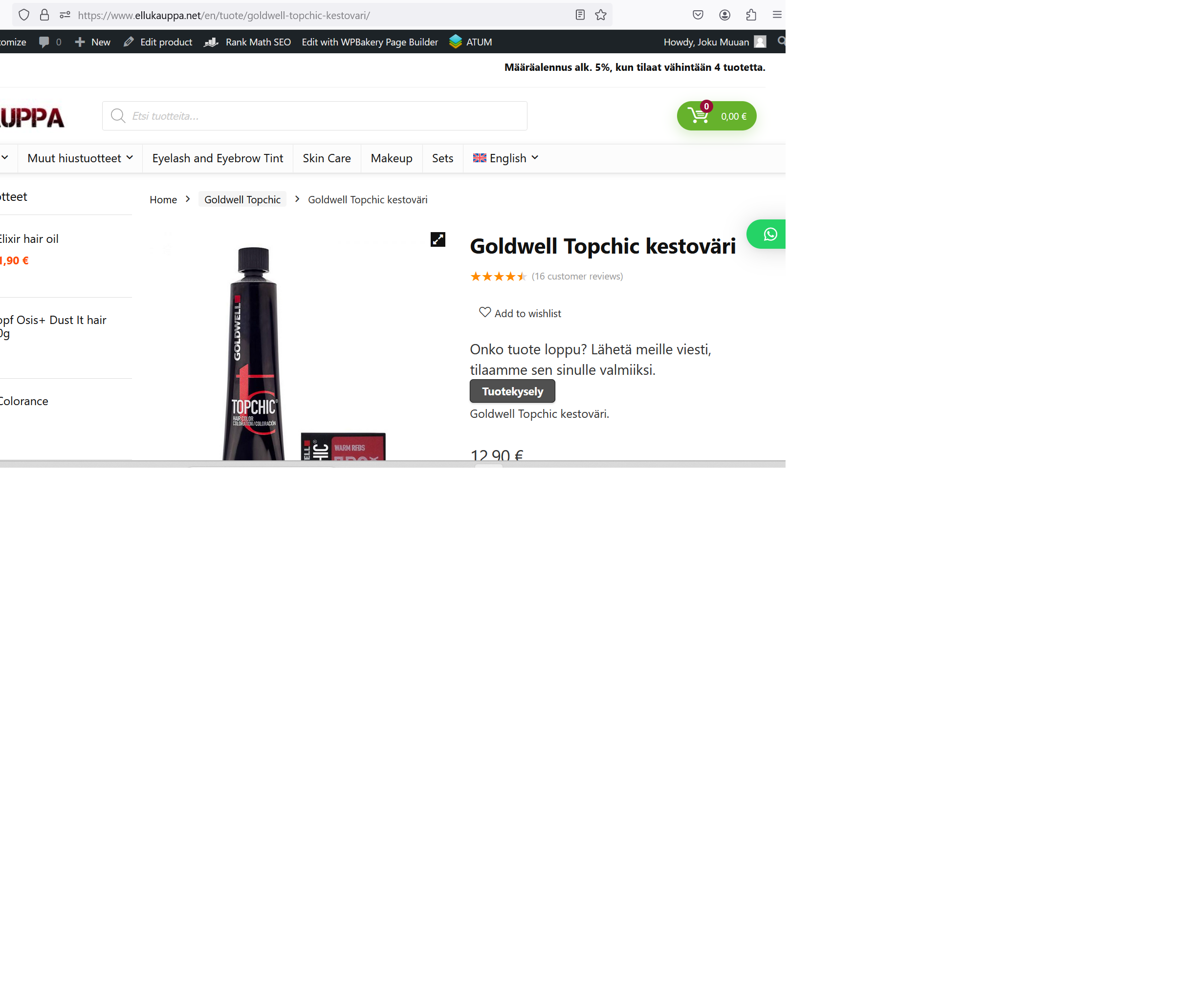

We have just starting with the WPML in our shop. There seems to be a problem with product base slug. We are translating from Finnish to English. Finnish base slug is /tuote/ and translation for that would be /product/, but after saving it doesn't change to shop. In English shop it remains in format ellukauppa.net/en/tuote/.
If we change the slug base language to English and slug to /product/. Then he outcome is obviously ok for English shop, but in Finnish side the /product/ doesn't change to /tuote/
