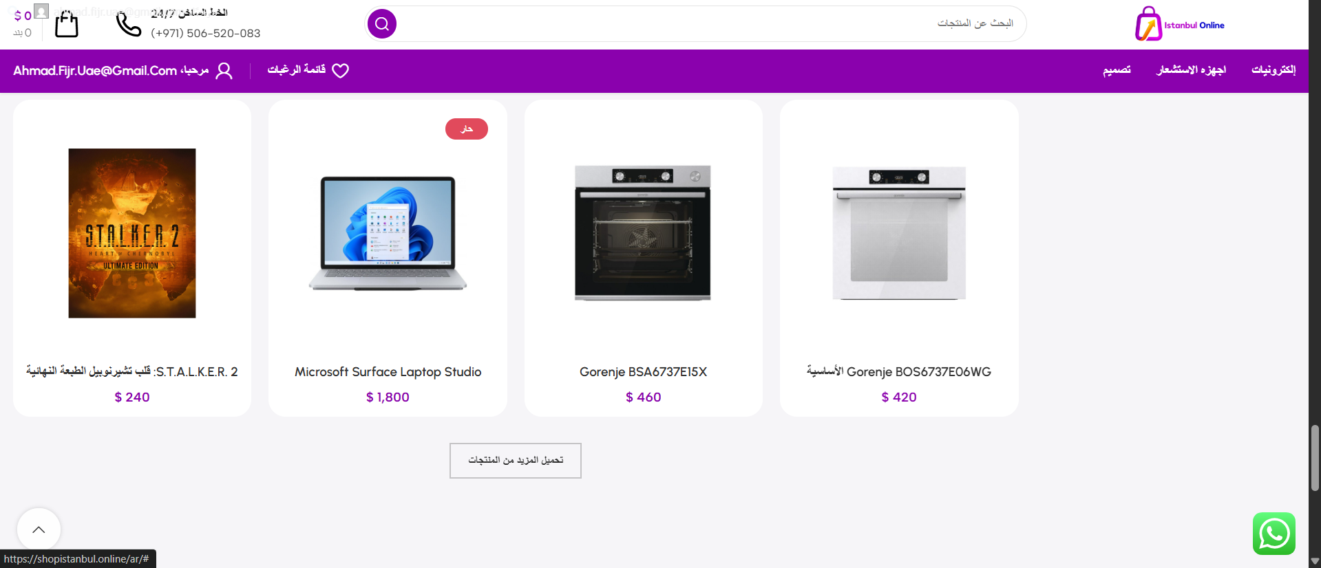

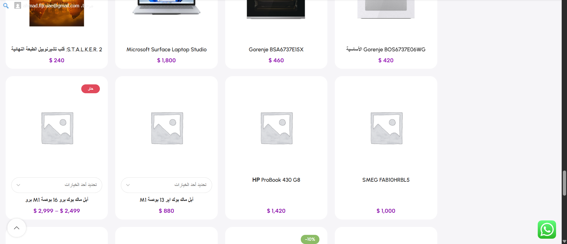

I am trying to load more products on the home page in other languages, such as Arabic or Turkish, using the 'Load more products' button.
The issue can be seen on the home page: hidden link.
However, on the shop page: hidden link,
the product images load normally when using the same button.
When I click the 'Load more products' button at the bottom of the home page, more products are displayed without their images.
This issue does not occur on the shop page, where product images load normally.
Why are product images not loading on the home page when using the 'Load more products' button?
Why does the issue only occur on the home page and not on the shop page?
please help me for make the images loads normally when using the 'Load more products' button

Hello, I face the issue again...
on this page :
but home page of the original language:
it's work fine

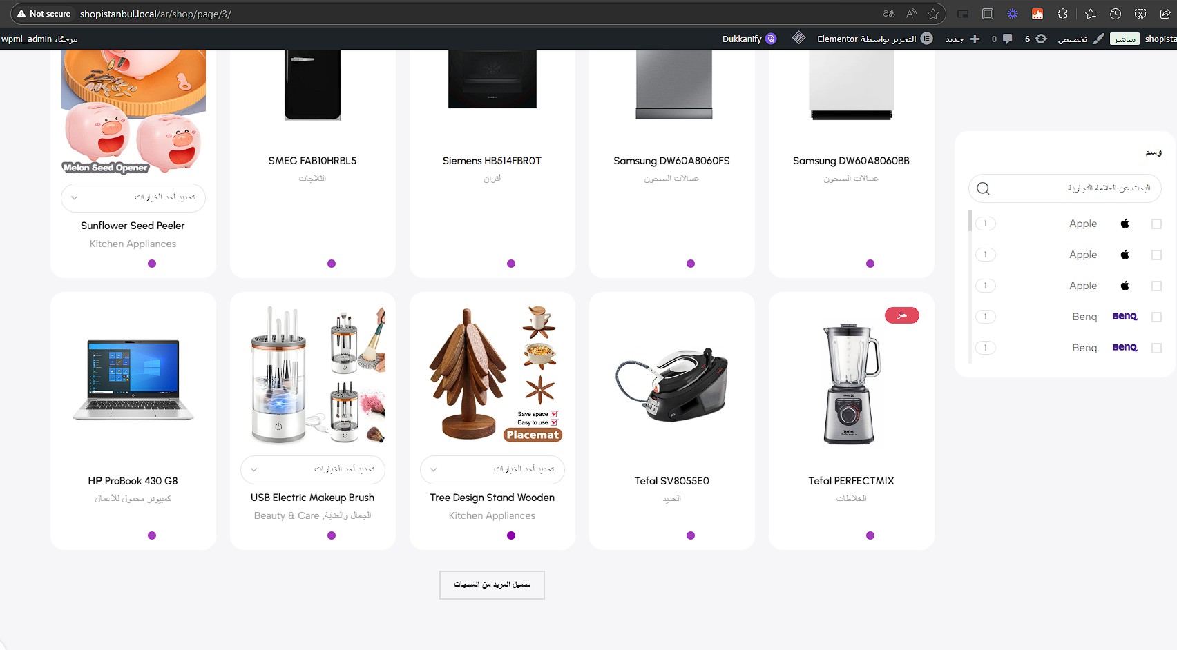

May 9, 2025 at 11:59 pm #17018218
On a local copy of your site, the issue does not occur. See screenshot.
I will need to run further tests on your site, to find out what is causing this problem.
