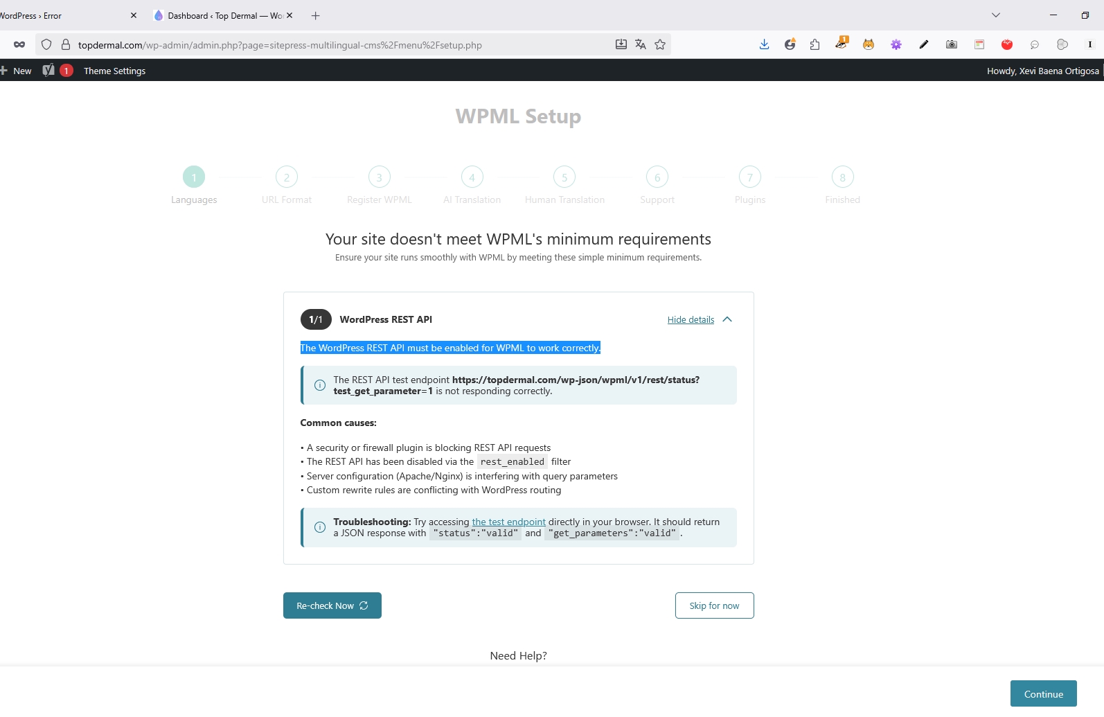

I am trying to activate WPML and encountered an issue with the REST API. The problem can be seen at this link: hidden link. I can't provide debugging information, since I can't activate WPML
Error screen "There has been a critical error on this website" when I activate WPML, instead of seeing the REST API screen. WPML spits an error that "Your site doesn't meet WPML's minimum requirements, the WordPress REST API must be enabled for WPML to work correctly." The REST API works when WPML is deactivated, and stops working when I activate WPML, so WPML can't setup itself. Also with WPML active the site becomes really slow and bulky
Why does the REST API stop working when I activate WPML and why the site becomes really slow when WPML is active?
How can I resolve the critical error on the website?

I could narrow down the issue to 3 custom snippets we have in the site at wp-admin/admin.php?page=snippets.
The testing site is at hidden link, the credentials are the same I gave you through the chat.
The snippets that make the REST API not work when they are active are those with the title:
- Translate strings that are not translatable with WPML
- Register billing professional accreditation field on the checkout
- Manage incentive free shipping options on the checkout
I passed this information to our developer too, but maybe you have some useful insights about how to proceed.
