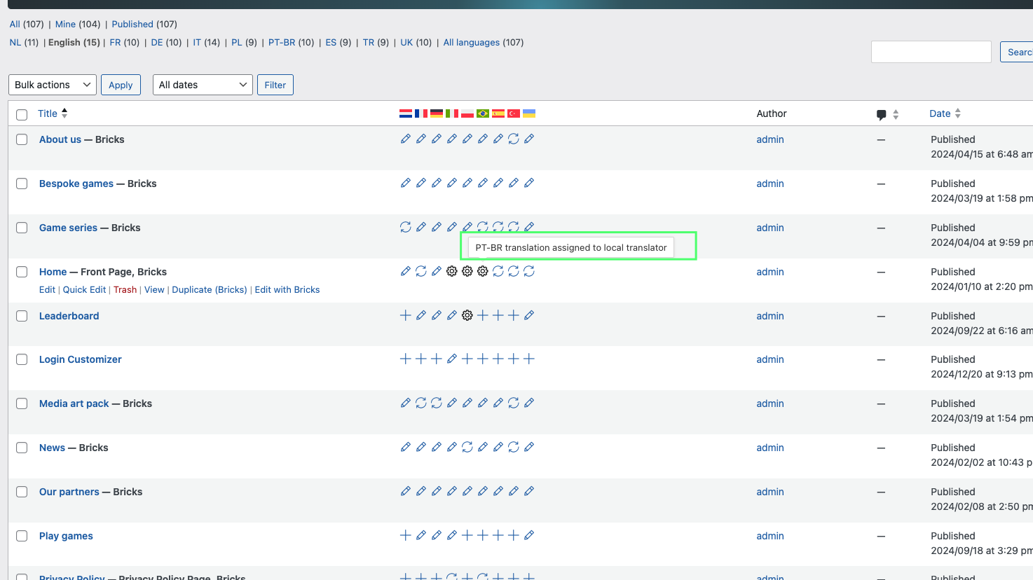

Now it is showing assigned to a local translator. ANd it is not completed.
Now i have following questions:
How to delete a translation completely? I tried to delete the transltions fully. But when I recreate the page and open it in advanced editor the previous translations are already there.
Please let me know how can I delete a translation fully. and as well as the first question. I am attaching the screenshot with this.

Thank you for the updates.
It is showing assigned to a local translator due to the previous issue because translations were left in progress (not completed). When you translate manually, you are the translator and until it is completed, the status is shown like that.
You can simply update the translation to make it 100% complete. However, in case you want to start over, like want to delete the translation and translate it again, please follow these steps:
- Go to Pages, in default language.
- Switch to a secondary language from the top admin bar.
- Remove the page's translation.
- Remove it from Trash also. (This is important, if you skip it, you'll be seeing previous content in translation editor.)
- Repeat this for all secondary languages, for which you want to delete the translation.
- Switch back to the default language.
- Translate the page again.
More details at https://wpml.org/faq/how-to-delete-the-translation-of-a-page/.
