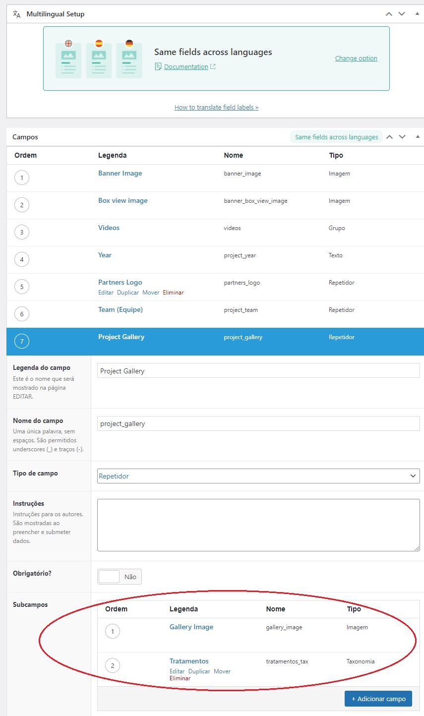

I have added a new ACF repeater field, but when edit a field and save the post in the original language, the field is not translated, or copied (I tried both options), to the secondary language. I have the field group set to "same fields across all languages". It was not initially set, as I added ACF Multilingual after adding the field initially.
Here are my steps:
1. Field added (original language only)
2. Posts updated with content
3. Added WPML multilingual (not sure if this matters)
4. Duplicated field (secondary language)
5. Field does not force translation

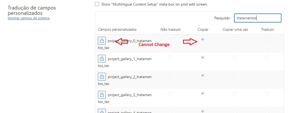

Also, I did notice that despite the field group set to "same fields across all languages", in the "WPML -> Definitions" the field is set to "copy" and cannot be changed (the "copy" function doesn't seem to work either).
See attached.

The ACF fields will only appear locked if the Translation preference is set to 'Copy'. Based on the screenshot, I noticed that the Translation option for the filed group is set to "Same fields across languages". Therefore, the "Copy" preference will be set to all fields within this field group by default. Check the link below for more details: https://wpml.org/documentation/related-projects/translate-sites-built-with-acf/recommended-custom-fields-translation-preferences-for-acf-and-wpml/#pre-set-translation-preferences
Based on the WPML Debug Info, I've noticed that the translation preference for the ACF File Group post type is currently set to "Translatable," which we don't recommend. Having duplicated/translated field groups can lead to complications in the translation process. If you're considering altering the translation preference for the field, please follow the steps below, which should assist in addressing the issue.
- Delete the translated field group and set the translation preference for the "acf-field-group" post type to "Not Translatable" by following the information outlined here: https://wpml.org/documentation/related-projects/translate-sites-built-with-acf/expert-translation-option/#field-group-translation-settings
- After that, navigate to "ACF → Field Group" and open the Field group which includes the specific field.
- At the top, there is an option to modify the Translation mode. Click on the "Change Option" link there.
- Choose the "Expert" mode from the available options.
- After selecting "Expert" mode, scroll down to the field you want to change the translation settings for.
- Change the translation preference for the field to "Translate' and save your changes.
Please let me know if that helps to solve the issue or if you need further assistance in this matter. I will be happy to help.

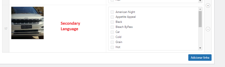

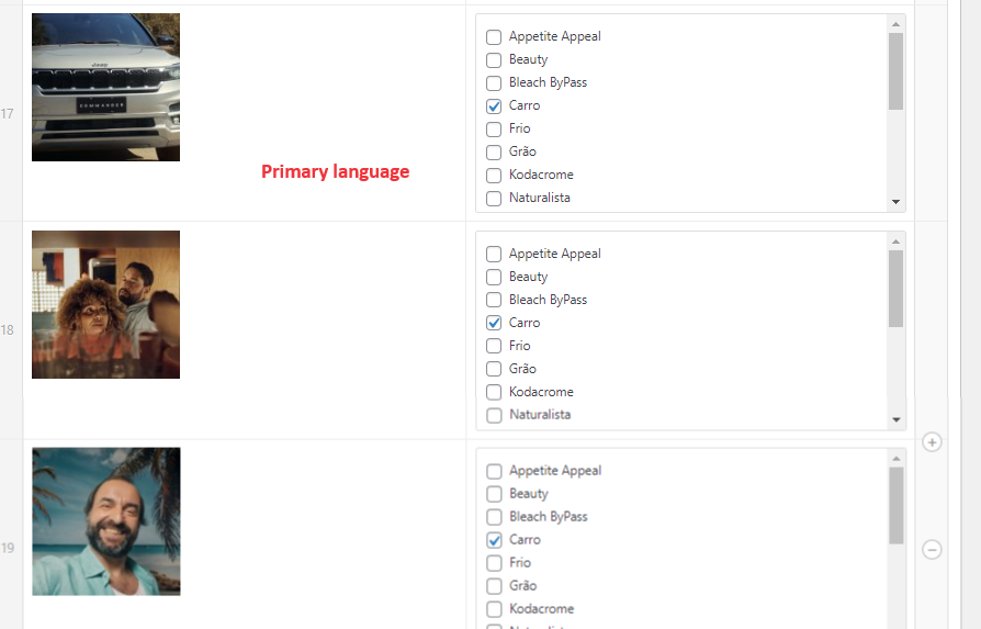

Thank you. I followed the steps and removed the field groups in the secondary language, and set field group post type to "do not translate". I changed the field group translation mode to "expert mode" and set the field to "translate".
The result is as you can see in the images. As you can see, when I look at the field in the primary and secondary language, they are different. It doesn't seem to matter whether I set the field to "translate" or "do not translate".
What I want is for the field to always be the same across languages. It doesn't even need to be translated. But for some reason, whatever change I make to the primary language on that field doesn't seem to be affecting the secondary language.

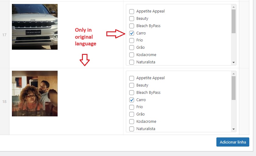

I've attempted to set the field type "gallery image" to Copy. That doesn't seem to do anything. Is the expected functionality that the data is copied instantly when publishing in the original language, or do you need to go through translation process? Either way, this is what I did:
1. In ACF, I set Gallery Image field to Copy
2. In ACF, I set Tratamentos field to Translate
3. Note that the repeater field group is set to "do not translate"
4. In the post, I added a new Gallery Image, checked off Tratamentos, and published.
5. Approved translation
6. The gallery image is not added in the secondary language, nor is any taxonomy changed.
So the issue isn't just the taxonomy, but also either the repeater field, or the image. Please verify that the settings in steps 1,2,3 are correct.

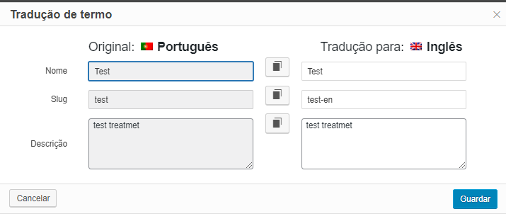

As to your last point, the terms have no additional metafields to translate. Would you be able to provide documentation on adding translatable metafields?

Regarding the issue with the Meta field not being visible, navigate to "WPML > Settings > Custom Term Meta Translation," adjust the translation setting for the term meta field to "Translatable," and save your changes. The Meta fields should become visible after this adjustment.
