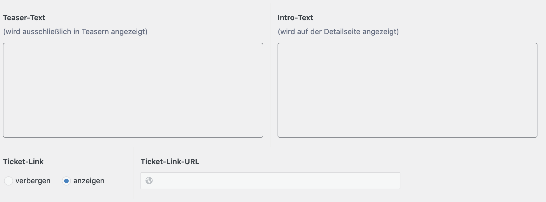

I am having an issue with 3 ACF fields – all of them 'stuck' to "readonly", although they are all set to "translate". The german interface is fine, those fields are only readonly in the english interface. I have attached two screenshots showing the field "Ticket-Link-URL" in readonly mode and the related wpml setting for that field.
Is there any other setting i might have missed that may tell the fields to be in readonly-mode?

I completely understand what you're looking for. An ACF field will appear disabled in other languages if the translation preference for that field is set to "Copy". From the screenshot, I can see the translation preference for the link field is set to "Translate" but the WPML debug information says that the translation preference for that specific field is set to "Copy" in the system, which might be causing the issue.
Please follow the steps mentioned below and check if that helps to solve the issue.
- Go to "WPML > Settings" and scroll down to the "Custom field translation" section.
- Click on the "Show system fields" link
- Now, enter the field name in the search box
- Set the translation preference for the "_ticket_link_url" system field to "translate"
Please try and let me know if that helps to solve the issue. I will be happy to help if you need further assistance in this matter.

Unfortunately, the site you shared in the private message was showing a 404 error. However, the access credentials worked properly on the staging site[ hidden link ] you initially shared in the first private message. So, I investigated that site and successfully been able to trace the root cause.
Upon inspection, I noticed that the ACF Field group is set to 'Translatable' under "WPML > Settings > Post Type Translation." It's generally advised to set the ACF field group post type to "Not Translatable." Marking the field group as translatable is only necessary if you aim to translate the ACF interface, which is typically not needed.
I changed the translation preference for the Field group post type to "Not Translatable" and that solves the issue. Now you can add the link manually in other languages.
