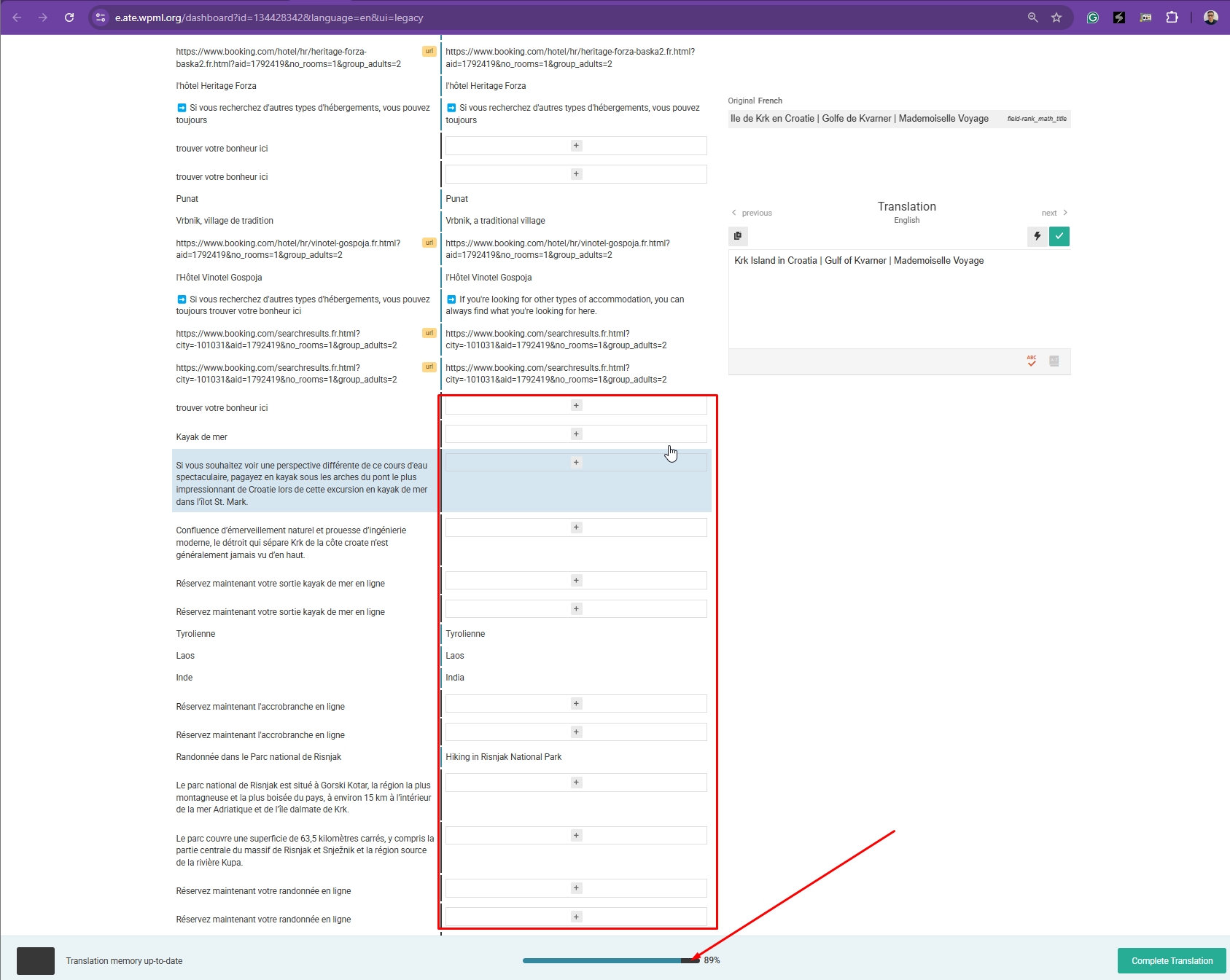

can you do a screen recording while fixing this post issue:

March 26, 2025 at 10:55 am #16861966
Thanks for your reply.

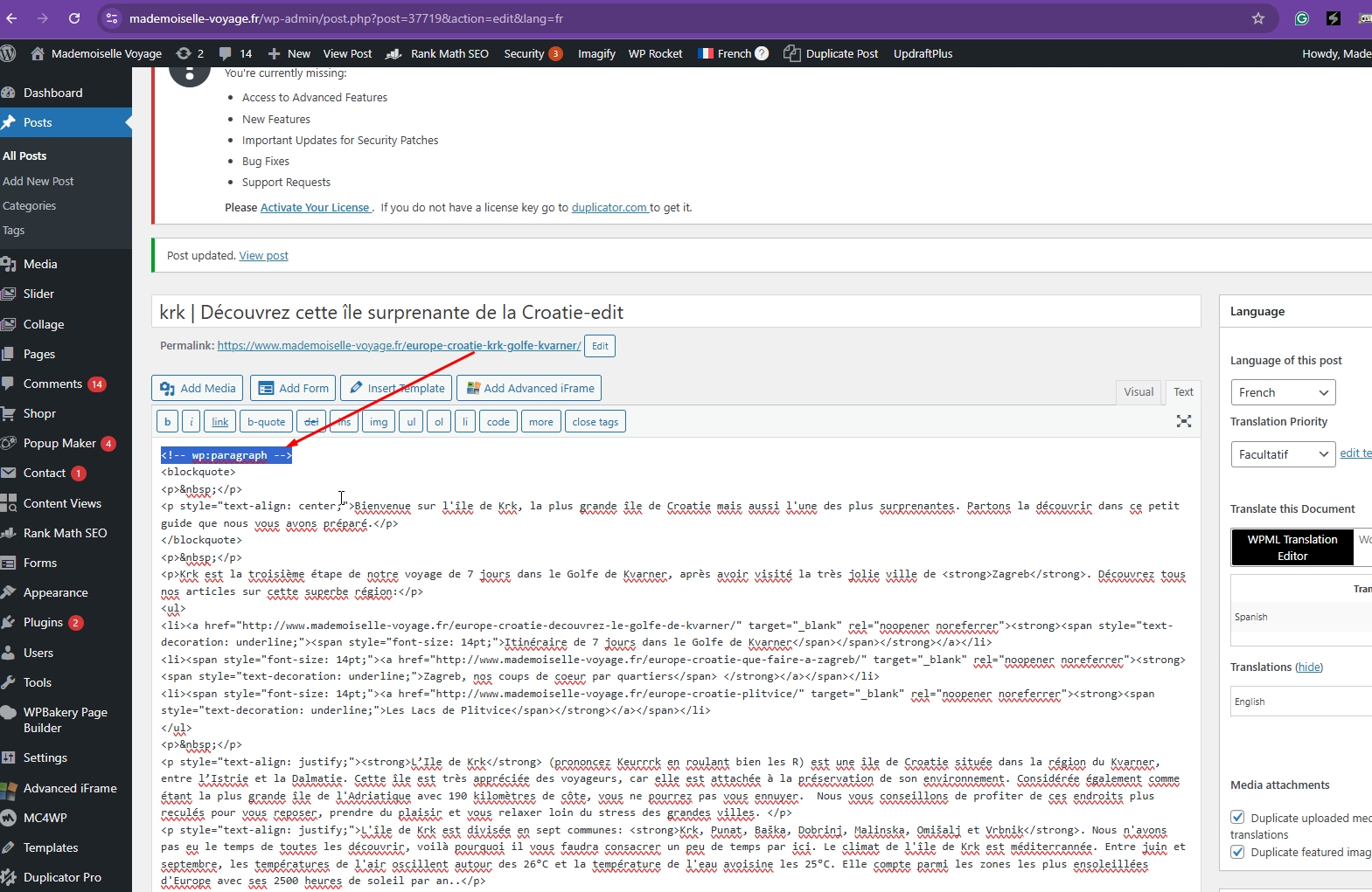

Sorry, I need to check the HTML code to fix the issue and a screen recording would not be possible. Anyway, I've corrected the Gutenberg editor tags as shown in the attached screenshot (top and bottom section) and you should be able to translate all the contents now for this post hidden link
Everything seems translated here hidden link . Did I overlook any sections?

Thanks for your reply. If you check my previous screenshot, I've added <!-- wp:paragraph --> to the top and at the bottom section, I've added this <!-- /wp:paragraph --> . Then, resave the post and retranslate it. You can try this on your other post and see if it helps.

So, do I have to add this to the post? I was adding this into WPML XML.
April 4, 2025 at 10:57 am #16897069
Thanks for your reply. Yes, you need to add it to the post. Use the code editor.
