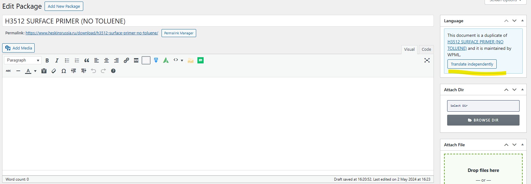

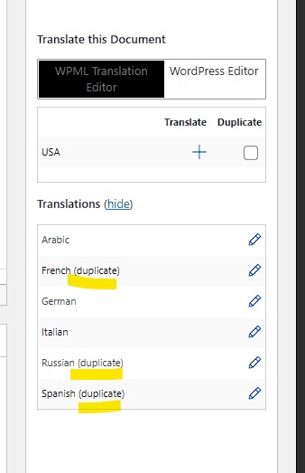

So far I have not been able to replicate the issue on the sandbox and need to run further tests.
A question:
As you can see on the screenshot some of the translations that you created are duplicates. This means that those are not independent translations and they will get overwritten each time the original product is updated.
Would you mind if we ran a test and set those duplicates as independent translations to verify if this solves the issue?

April 25, 2025 at 4:24 pm #16969446
This failure is not to be connected to Yoast SEO.
Your example also showed the error, if I saved the original content without making any changes.
Settings these "Duplicates" to "Translate independently" appears to solve the issue.
In this case, I would suggest not duplicating these custom post types with WPML.
