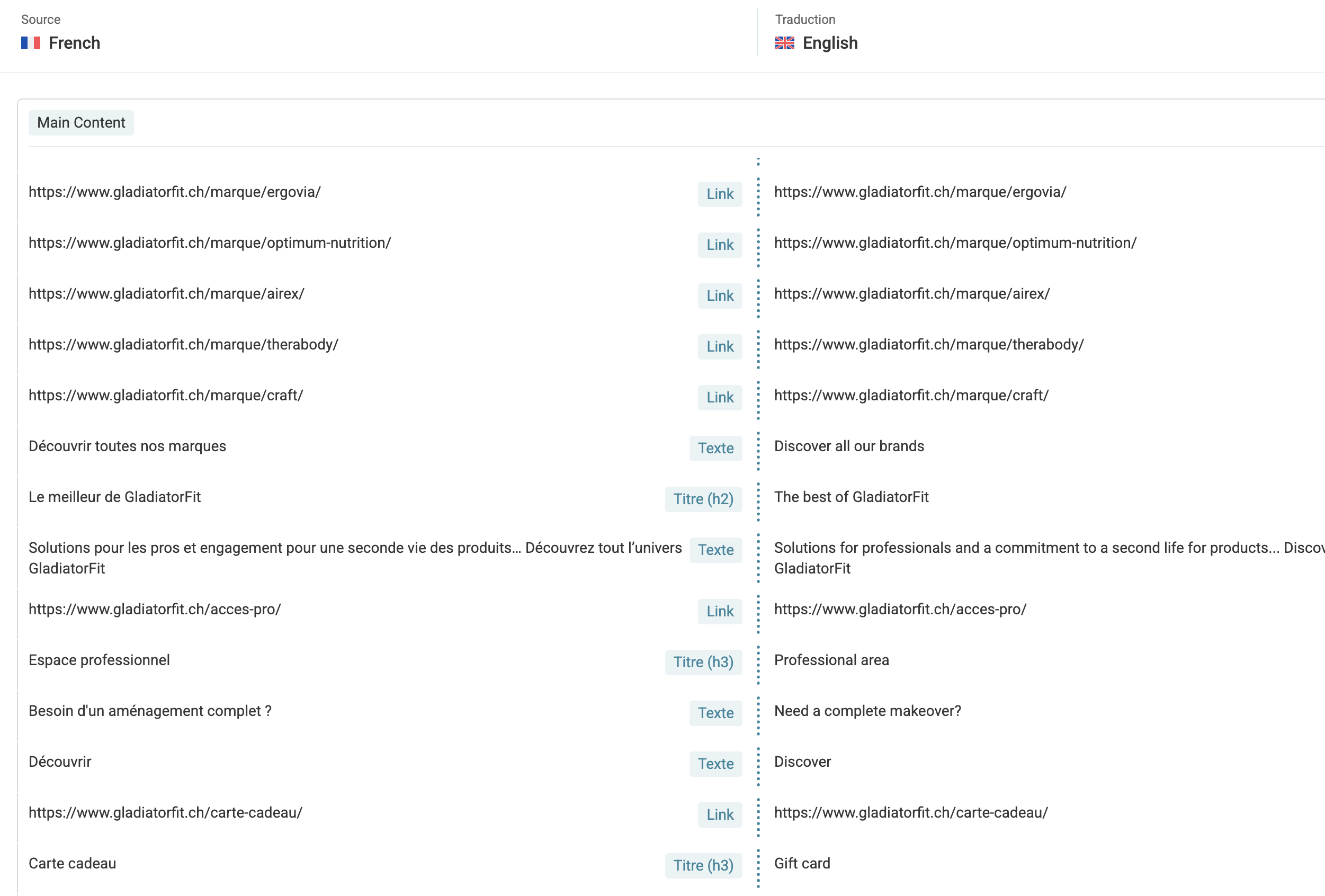

You're right, I see it now on the manual translation editor, but it puts the same link in translation ...

Dražen
I tried to translate them manually, but it still does not work.
Let me check with our 2nd tier, and I will get back to you.
