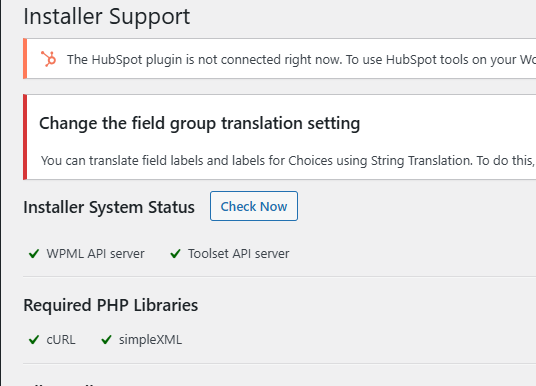

March 11, 2025 at 12:30 pm #16801571
dawnV
Here's a screencap from your requet
FireShot Capture 334 - Installer Support ‹ Instron — WordPress - [staging.instron.com].png
March 11, 2025 at 9:22 pm #16804219
Mihai Apetrei
WPML Supporter since 03/2018
Thank you for the update and for the screenshot.
So yes, we have that red X showing up there, meaning that there might be some kind of block that prevents your site from connecting to the WPML API.
I recommend whitelisting the following domains with the assistance of your hosting provider:
wpml.org
cdn.wpml.org
api.wpml.org
api.toolset.com
cloudfront.net
For more detailed information, please refer to our documentation: WPML plugin cannot connect to WPML.org
Please let me know how that goes.
