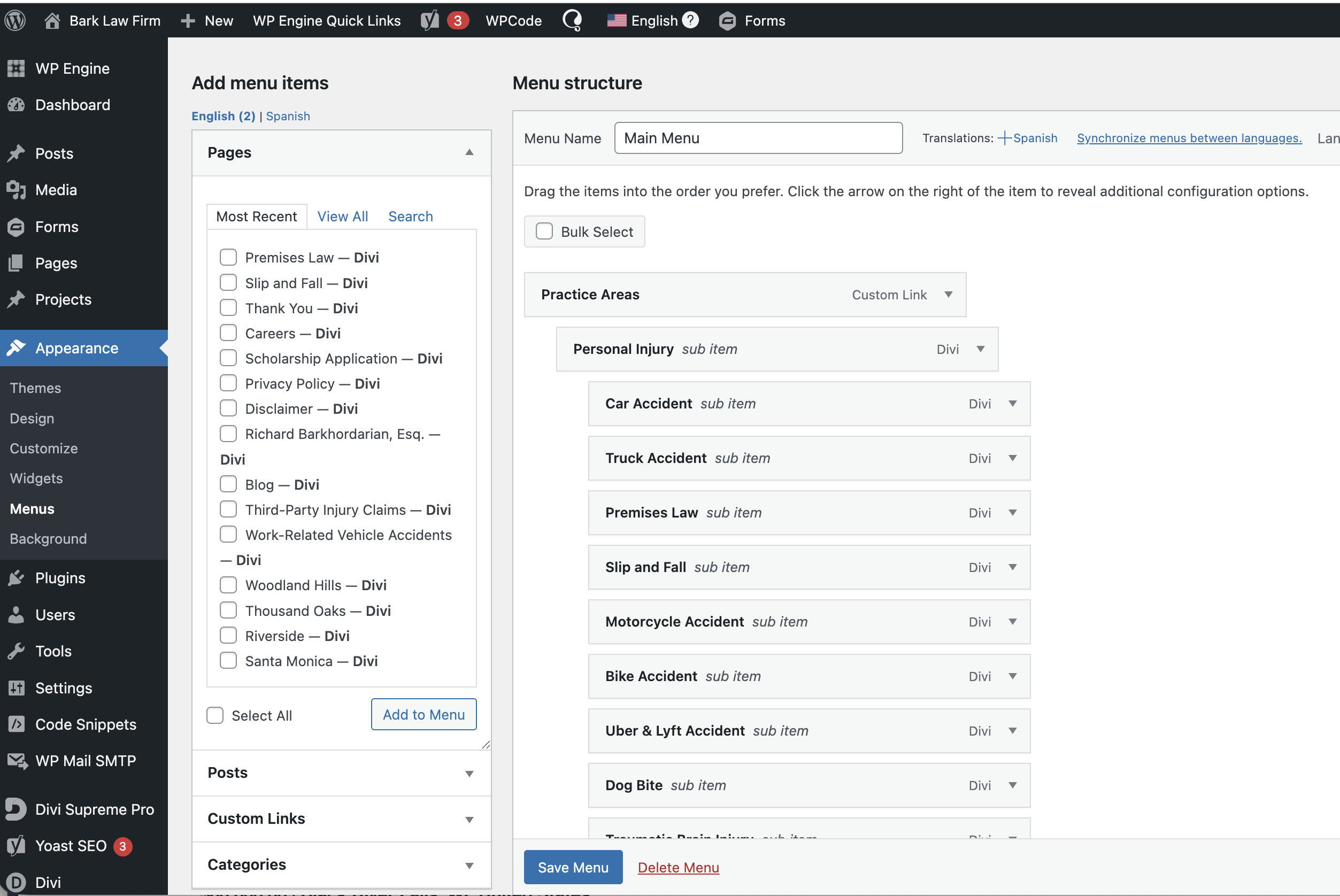

Do I need to create the custom links? It appears I need to create the menu for the secondary language. If so, I have one custom link which is Parent link, the sub menu links are all correct. Is the screenshot I have the correct process?

February 23, 2026 at 5:55 pm #17844076
Bobby
WPML Supporter since 04/2015
Translating the menu this way is considered "manual", therefore yes you would need to create it for the secondary language.
What you could do is "Synchronize menus"
Then once that is finished, you can edit the menu in the secondary language and manually edit in your custom links.
Custom links - because they are custom do not behave in the same way as a menu item for a page such as "Home" would behave.
That page has an ID in the database tied to it, which is then tied to the translation, therefore it behaves different.
