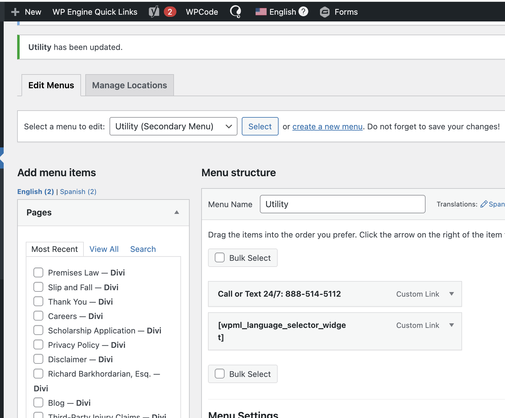

I'm using this function to enable shortcode in a menu
add_filter('wp_nav_menu_items', function($items) {
return do_shortcode($items);
I'm using the shortcode provided in the documentation to output it in the secondary menu but it's not showing.

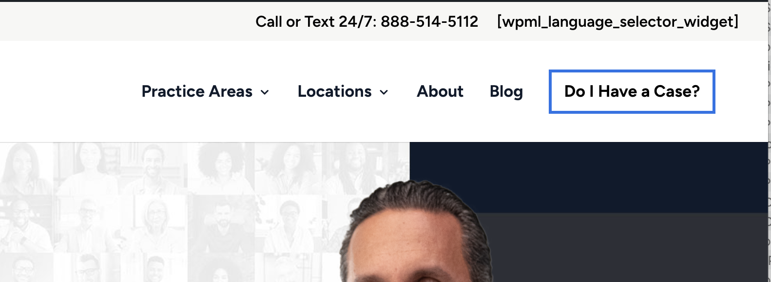

I'm trying to place it in the secondary menu. Now there's a gap above the text or call area.

March 3, 2026 at 2:24 pm #17868892
ryanR-5
I added this PHP - do_action('wpml_add_language_selector'); and the attached screenshot is what happens, it outputs the shortcode but not the actual contents of the shortcode.
