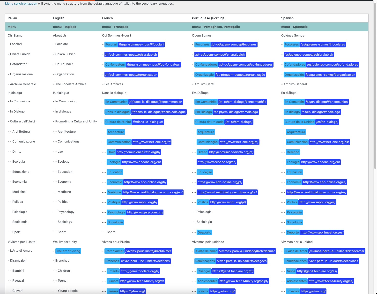

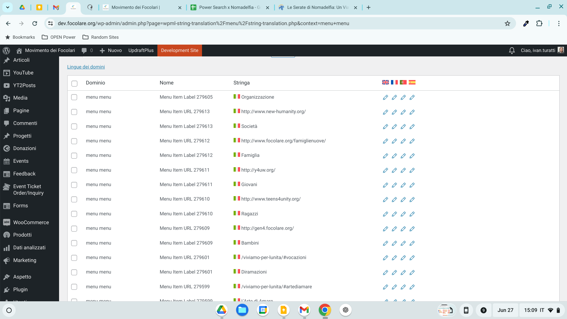

The menu is translated in all the languages in the strings, but when i do sync it doesn't changes them.

I updated the translated menus and tried the Menu Sync, which worked correctly. (Kindly check the attached screenshot)
The staging site can't be reached, so I couldn't complete the sync process. Would you please complete it and check the menu items on the front end?
