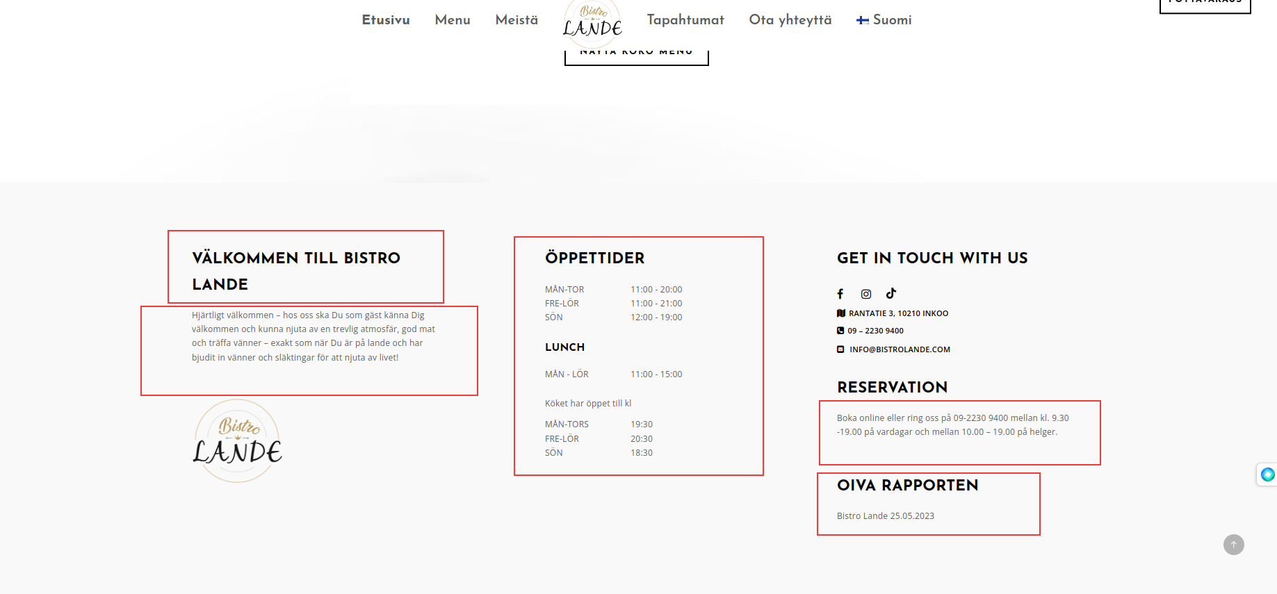

I have three languages managed using WPML String translations. For some reason, when I am adding translations for the Finnish language, it doesn't work.

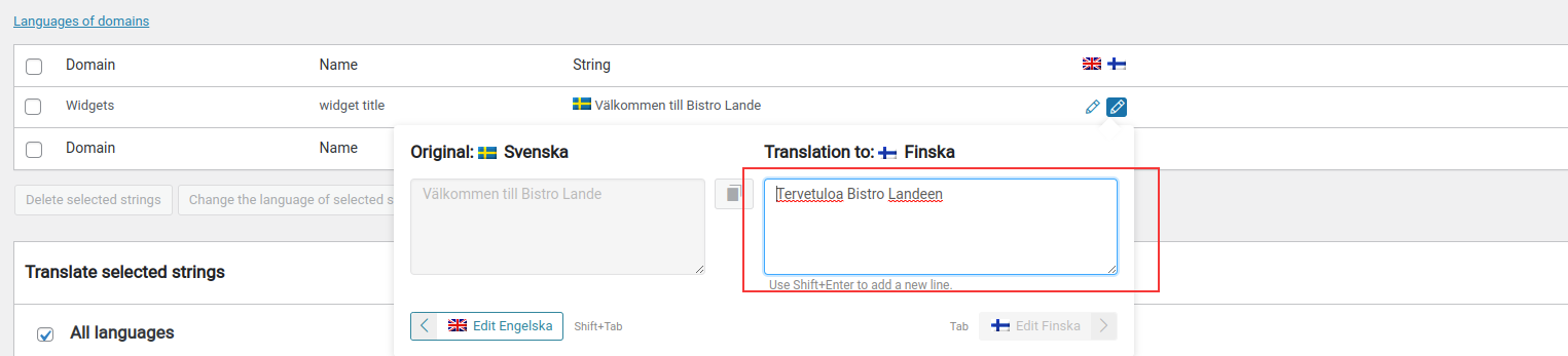

I am enclosing images to explain the issue. In the enclosed first screenshot, you will see that the welcome string is translated in the Finnish language correctly but when you look at the second highlighted screenshot, you will see it is still displayed in the Swedish language.

Thanks for your reply.
Please check now. I've removed the fi.mo and fi.po language file from your server languages folder here /www/bistrolande_622/public/wp-content/languages and it works fine now. Could you check?
No, this is not a bug. The issue is caused by your language file overwriting the WPML language file. Since you're using WPML for translation, all language files will be kept into the language/wpml folder and will be used.
Yes, just remove the fi.mo and fi.po from /www/bistrolande_622/public/wp-content/languages in your production server.
