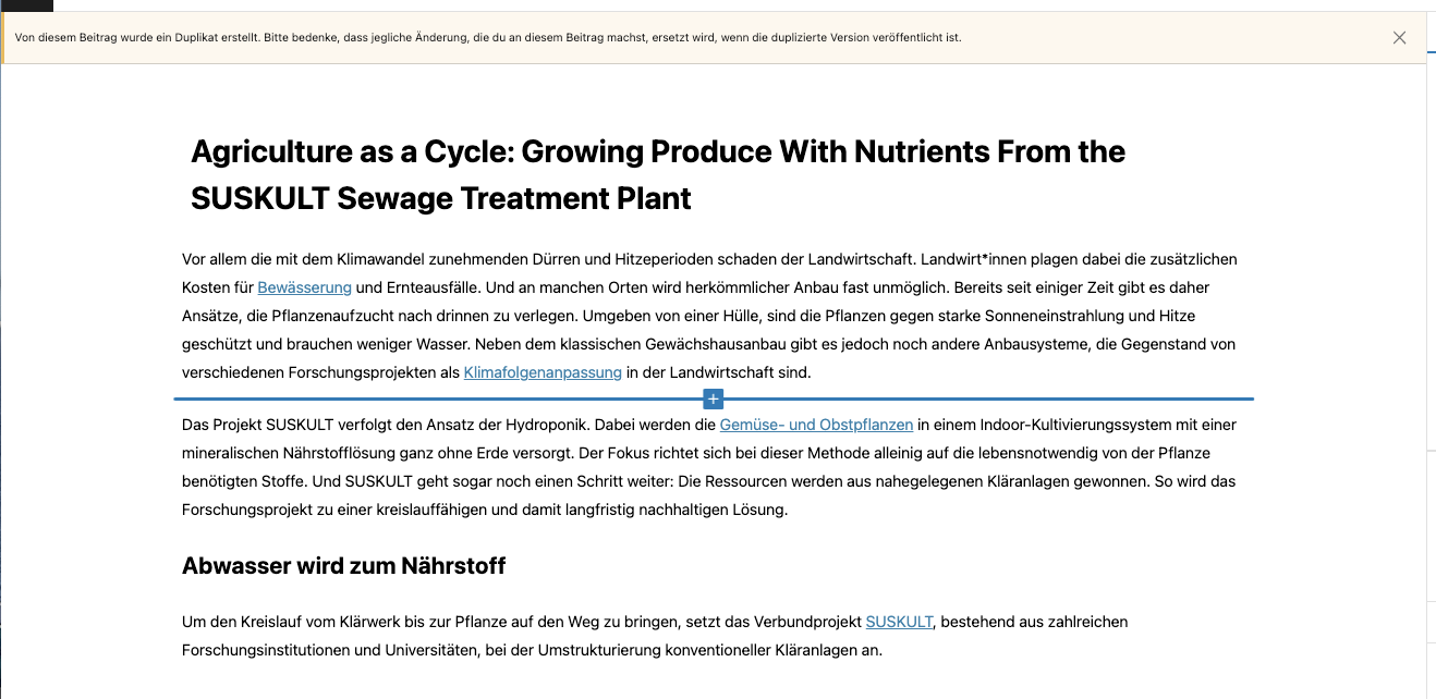

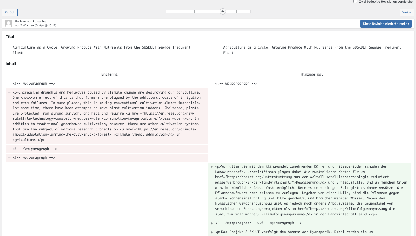

utaM
Dear Waqas Bin Hasan,
does this problem seem familiar to you? The same thing still happens and our programmer says there is nothing he can do about it: Translated articles show the untranslated bodytext, when the original (untranslated) article has been updated.
Going back to a good version in revisions has no effect. Instead, a duplicate article is created.
So, the question remains: when can we count on a review on our problem?
Thank you and best, Uta Mühleis.

April 23, 2024 at 2:57 pm #15557059
Nigel
WPML Supporter since 02/2016
Timezone: Europe/Madrid (GMT+01:00)
Thank you for that.
I logged in to review your settings and familiarise myself with your site (I haven't been making any changes).
Looking at the post revisions for the first of the links you shared, and those of the German original, I can see that—yes—the English content was replaced with German content at the same time as an update to the German original occurred.
This would only be expected if you were using Automatic Translation, or if the translated post was a duplicate of the original that had been edited independently.
That doesn't appear to be the case, but could it have been before?
Could you please describe your workflow for creating content in German and then translating to English, including details of when the content is published?
We have identified a workflow where it can happen that the translated content can be overwritten with the original if making translations and editing them with the WordPress editor, but that only occurs if you make a draft post and duplicate to the secondary language.
Might your workflow be similar?
April 25, 2024 at 12:48 pm #15565673
utaM
Hey Nigel,
"We have identified a workflow where it can happen that the translated content can be overwritten with the original if making translations and editing them with the WordPress editor, but that only occurs if you make a draft post and duplicate to the secondary language."
-> We always translate after the original article has been published (no drafts).
We create new articles via the WP Dashboard - Post - Add new Post.
When this is published, the translation will be created later:
1. Select translation in the backend / dashboard / all posts / Click on the ‘+’ next to the chosen article in source language
2. Scroll down and ‘Copy content from [source language]’
3. Add in the target language translation carefully
4. Make sure to ‘Save draft’ as you go - particularly every time you leave the page
5. Replace tags with the target language, add the featured image and excerpt
6. Publish oder Schedule article
I hope I was able to clarify this.
