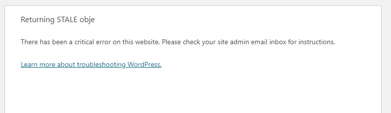

I just tried to login again but am seeing "Returning STALE obje" error on hidden link and can't access the site (see attached).
Lastly when I checked it was just working fine and I hadn't change any setting, as well as, deactivated any plugin or theme.
Please check on your side and let me know when I can access the site.
