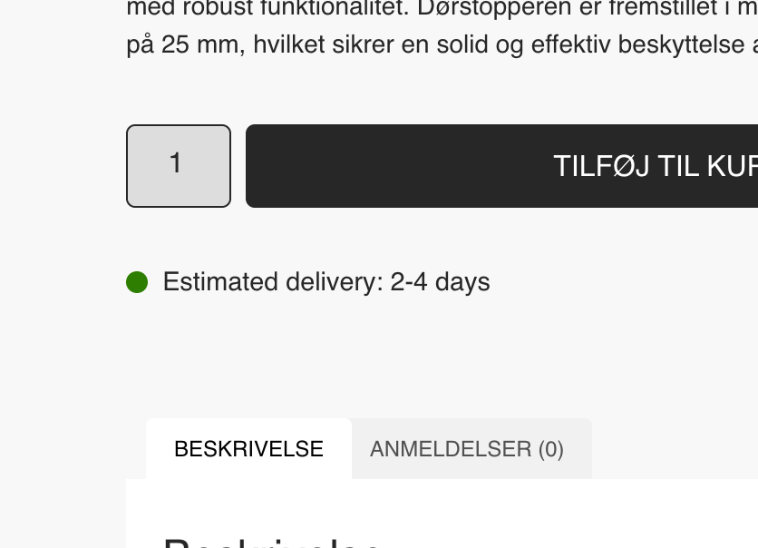

I am trying to translate shortcode content. I have added the texts via 'Admin Texts Translation' so they are visible in the String Translation Manager. From here, I have updated one language, but there is no effect on the front end. The issue can be seen on this page: hidden link.
I expected to see 'Estimated delivery: 2-4 days' translated to Danish, but instead, I got nothing.
Why are the translated strings not appearing on the front end?

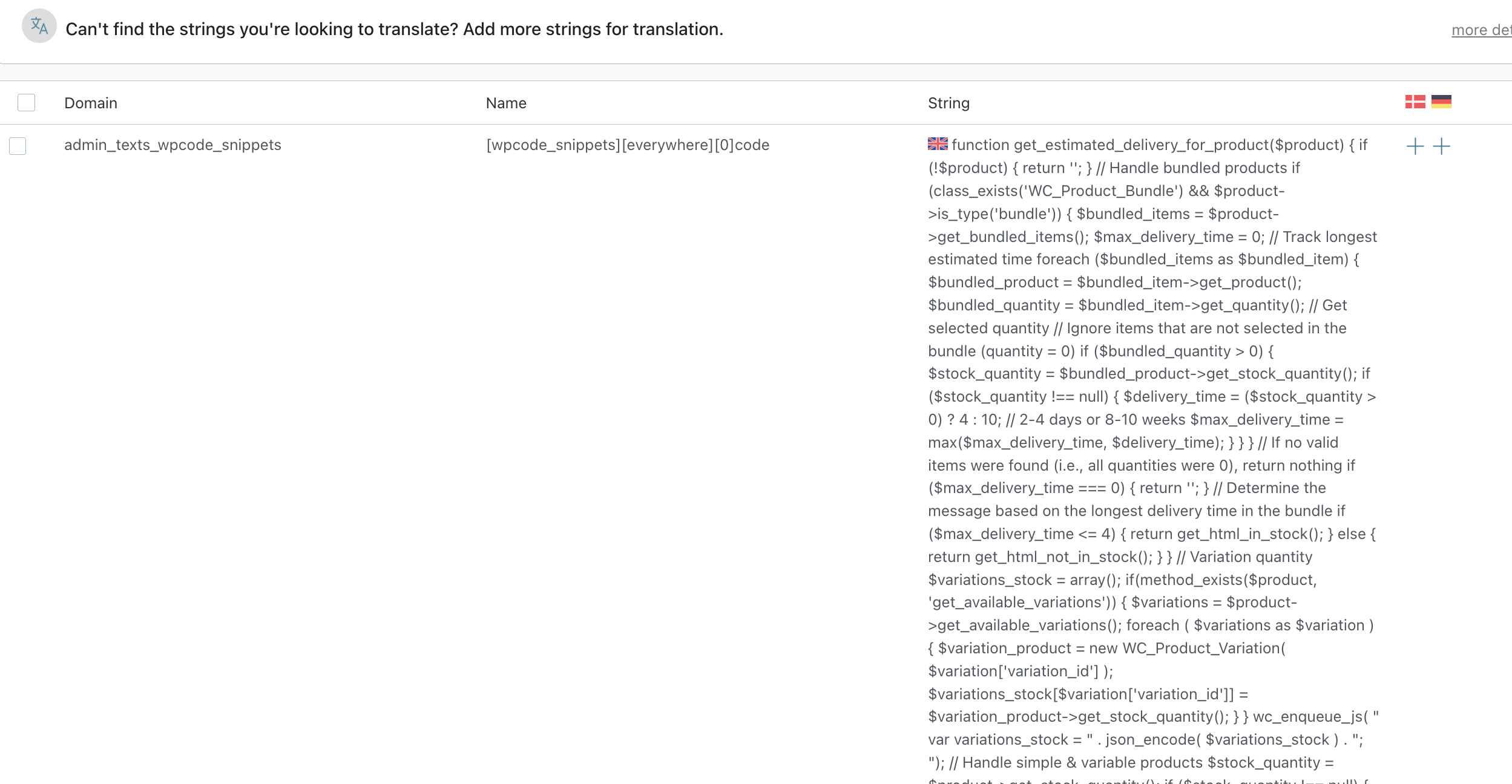

August 18, 2025 at 12:49 pm #17327803
henrikO-8

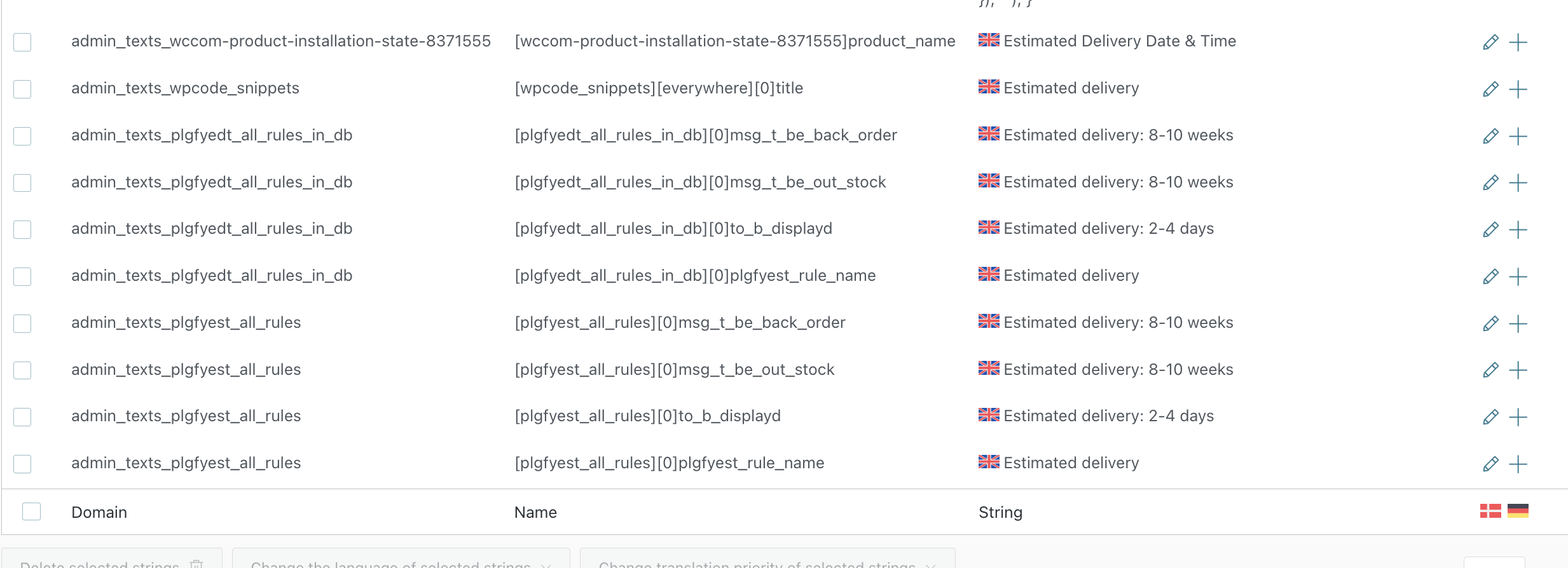

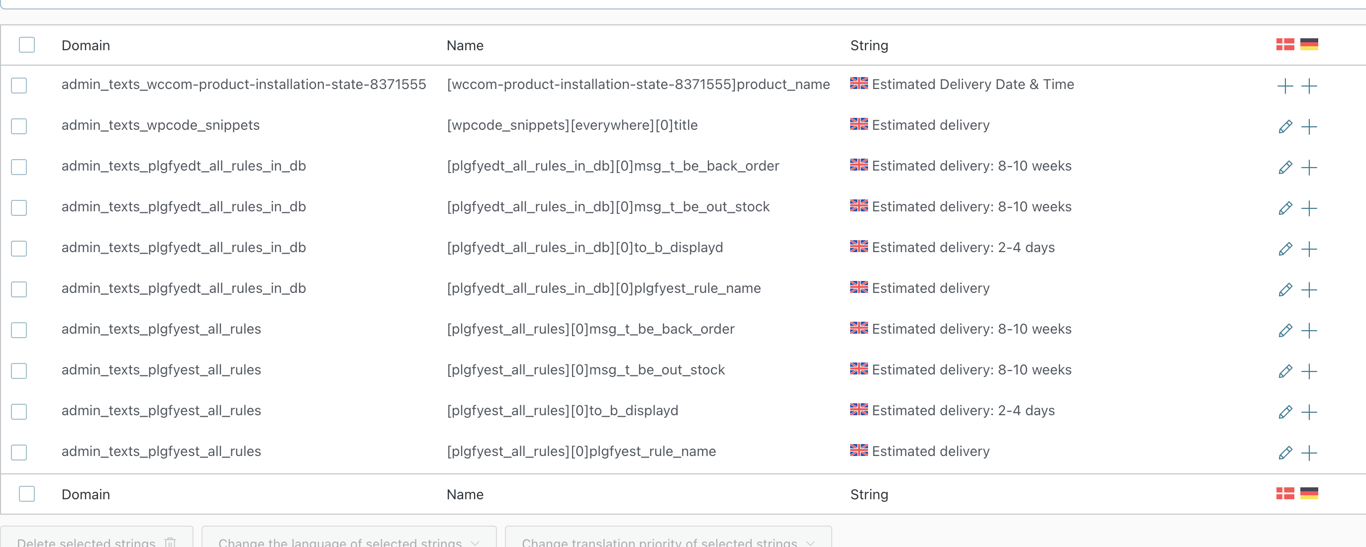

Please see attached screenshots. Do we really need to "translate" the PHP block as seen here?
It looks like WPML recognizes the shortcode inserted... that is just not working though.

August 18, 2025 at 10:12 pm #17329536
Bobby
WPML Supporter since 04/2015
Timezone: America/Los_Angeles (GMT-08:00)
What are your results if you click on the + for the code block, then duplicate it into the translation and within it simply translate ONLY the string.
While this is rare I have seen a similar case in the past.
August 19, 2025 at 6:45 am #17329785
henrikO-8

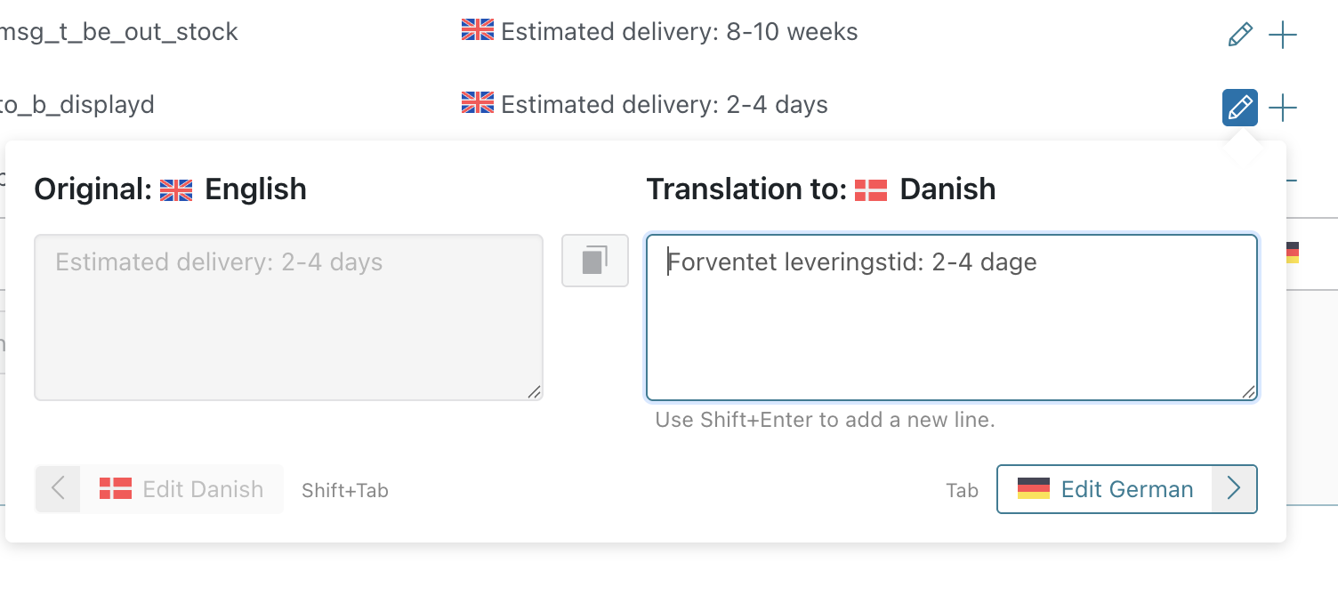

I have tried that as well now, with no luck. Do we need to do anything special for a translation to take effect? We have no caching on at the moment.

August 22, 2025 at 11:45 pm #17341505
Bobby
Thank you for the access details!
I can see the shortcode [estimated_delivery] is used.
Where is there shortcode pulling the data from?
This is important because WPML by itself will not know to register this content.
Typically admin texts are reserved for strings coming from theme options.
I have additionally attempted registering the shortcode via wpml-config.xml but this did not help.

August 24, 2025 at 9:59 am #17343044
henrikO-8
Hi Bobby,
Thanks for getting back to me.

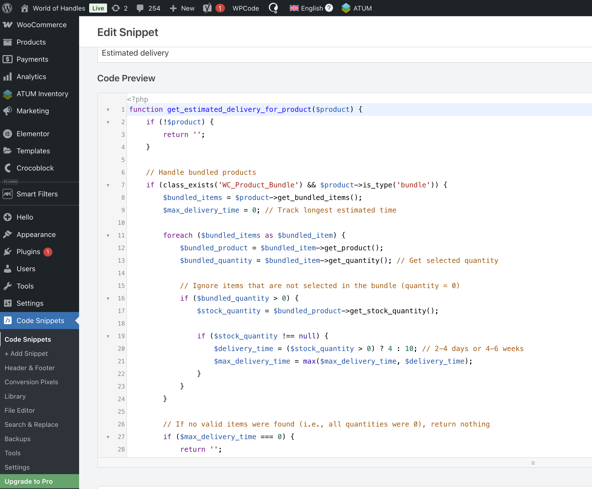

The shortcode is pulling data from here: See image.
Please check the Code snippet: Estimated Delivery.
Looking forward to hearing from you.
August 25, 2025 at 8:37 pm #17346322
Bobby
Thank you for sharing this.
I can see the following code.
function get_html_in_stock() {
return '<p class="estimated-delivery in-stock"><span class="stock-indicator" style="background-color: #008000;"></span> Estimated delivery: 2-4 days</p>';
The HTML string should be wrapped in a gettext call in order to correctly register for translation.
If possible, please remove the code snippet and add it directly to your theme, code snippets typically do not work well with WPML.

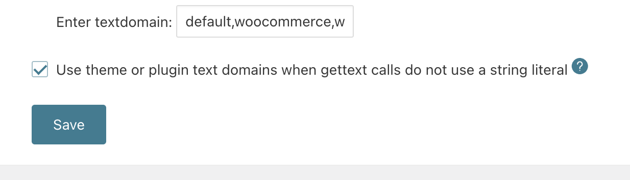

NOTE: Custom work is outside the scope of this forum, however, I am sharing this code under my own discretion to help you move your project along. Before using this please have a backup in place and understand that it is a piece of code that has not been tested officially by our team.
After you implement it, go to WPML->Theme and Plugins localization and scan your theme for strings, then go to WPML-> String translation locate it and translate it.
August 26, 2025 at 12:36 pm #17348315
henrikO-8
Thank you Bobby. I also had to check this one to make it work. See attached.
It works now - thanks!
