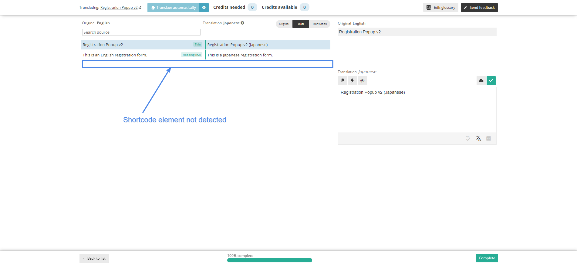

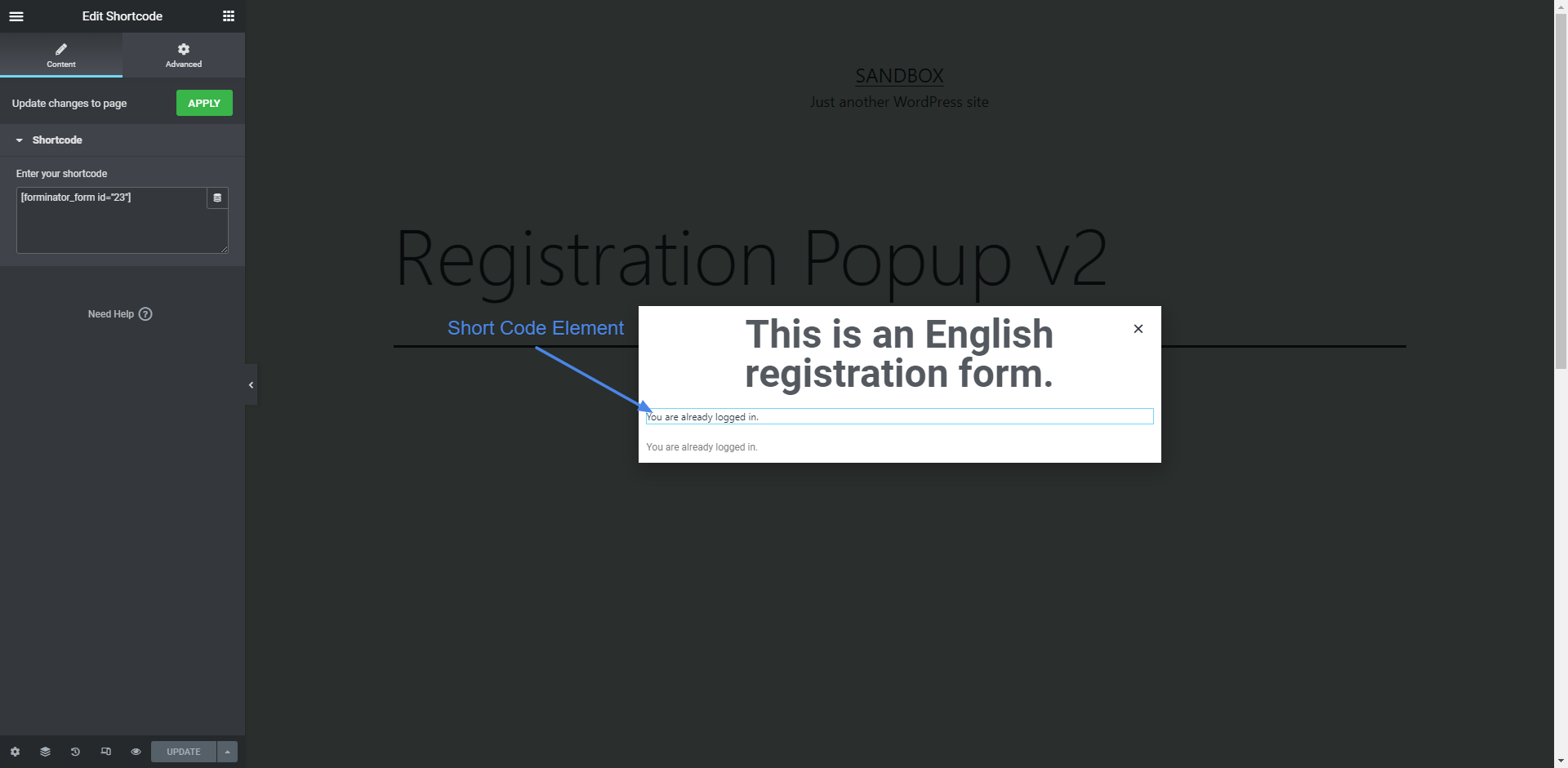

I also created a pop up and added the translations, BUT, i was not able to add the translation for the shortcode? Screenshots attached.
Outside of the above issue, I linked the button to pop up, and the words on pop up translate fine.

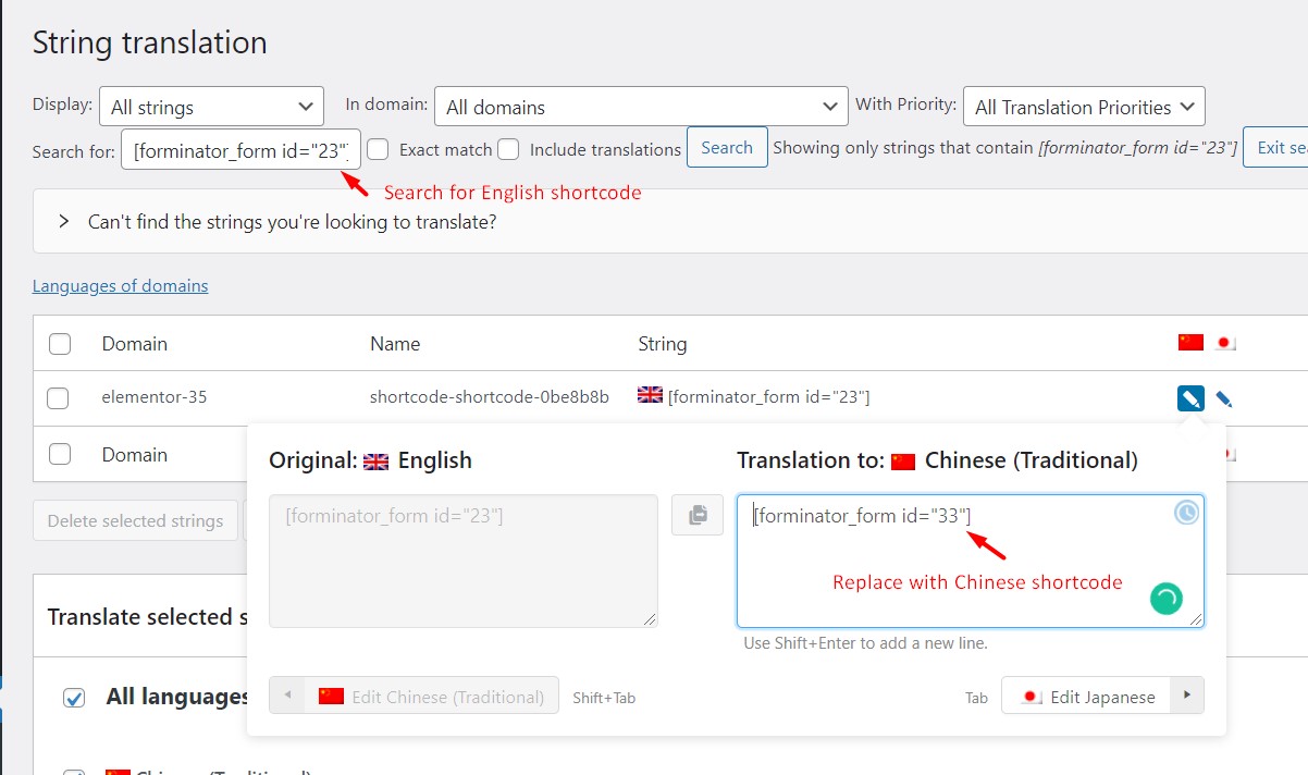

I checked the sandbox and found that the form shortcode can be translated with the String Translation module. Also, you can change it manually with Elementor by editing the original template then switching the language from the top admin bar, and editing the translated template with Elemntor. You'll be able to use a different shortcode here: hidden link
As you see in the attached screenshot, I've translated the form shortcode with String translation.
Now it works fine and the popup shows the correct form for each language. Please check the following record hidden link

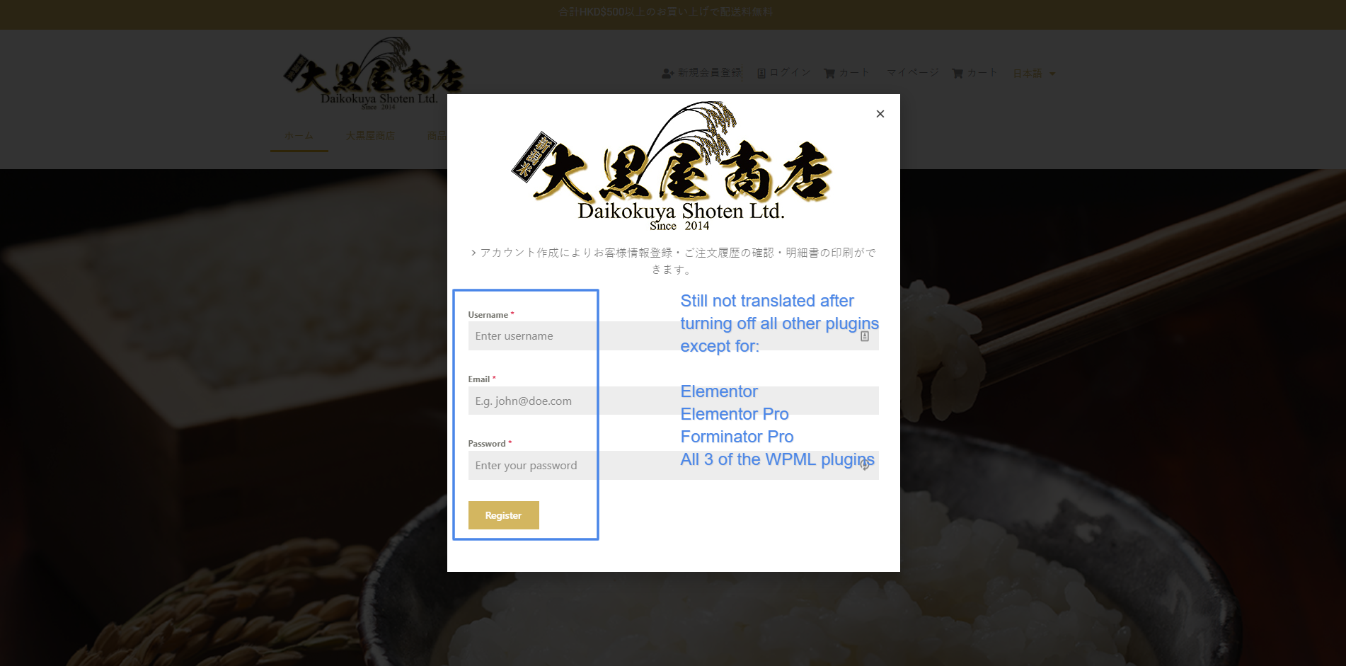

cordonL
Ok that's great. but what about the live site hidden link ?

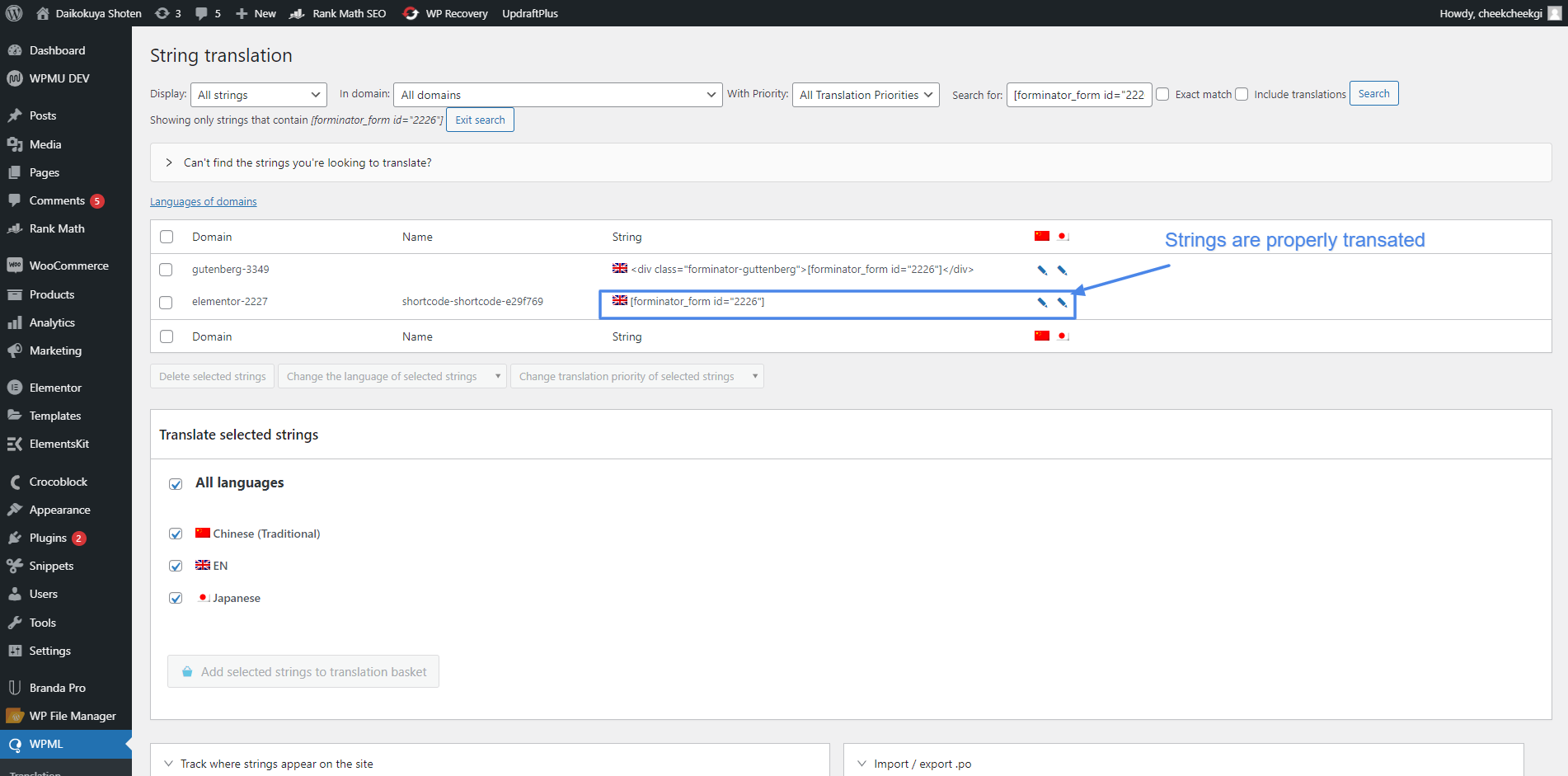

I've disabled all plugins except for Elementor, Elementor Pro, Forminator Pro, and 3 of the WPML plugins, and it still doesn't show the translation.
I've also ensured that the string was translated
