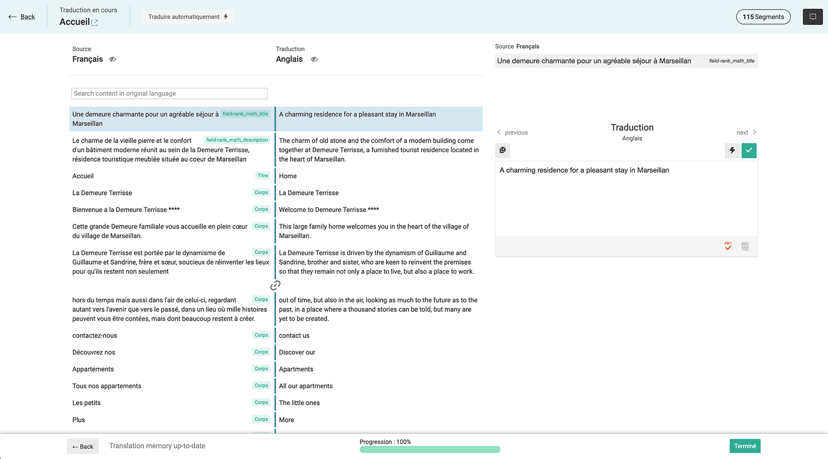

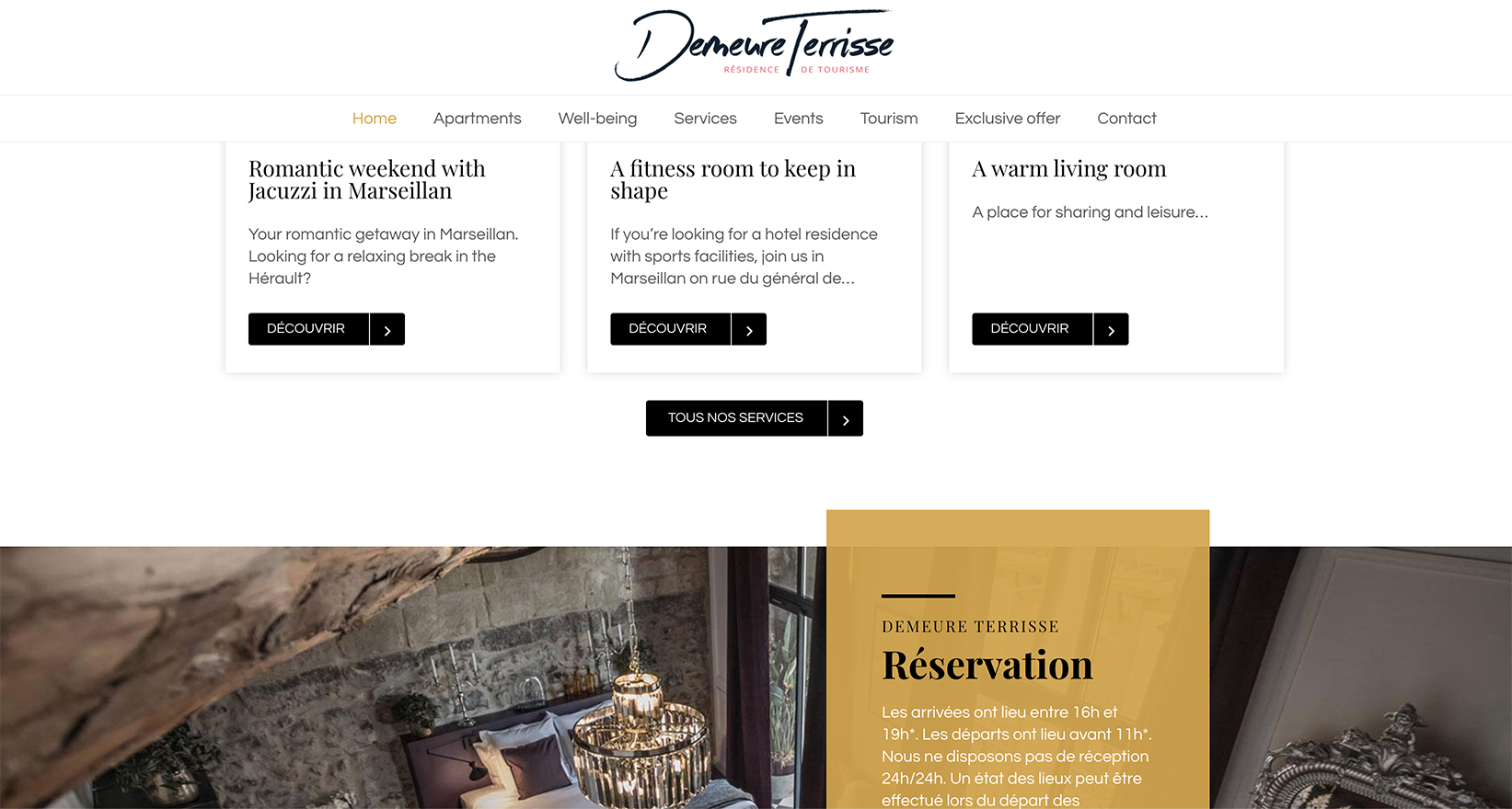

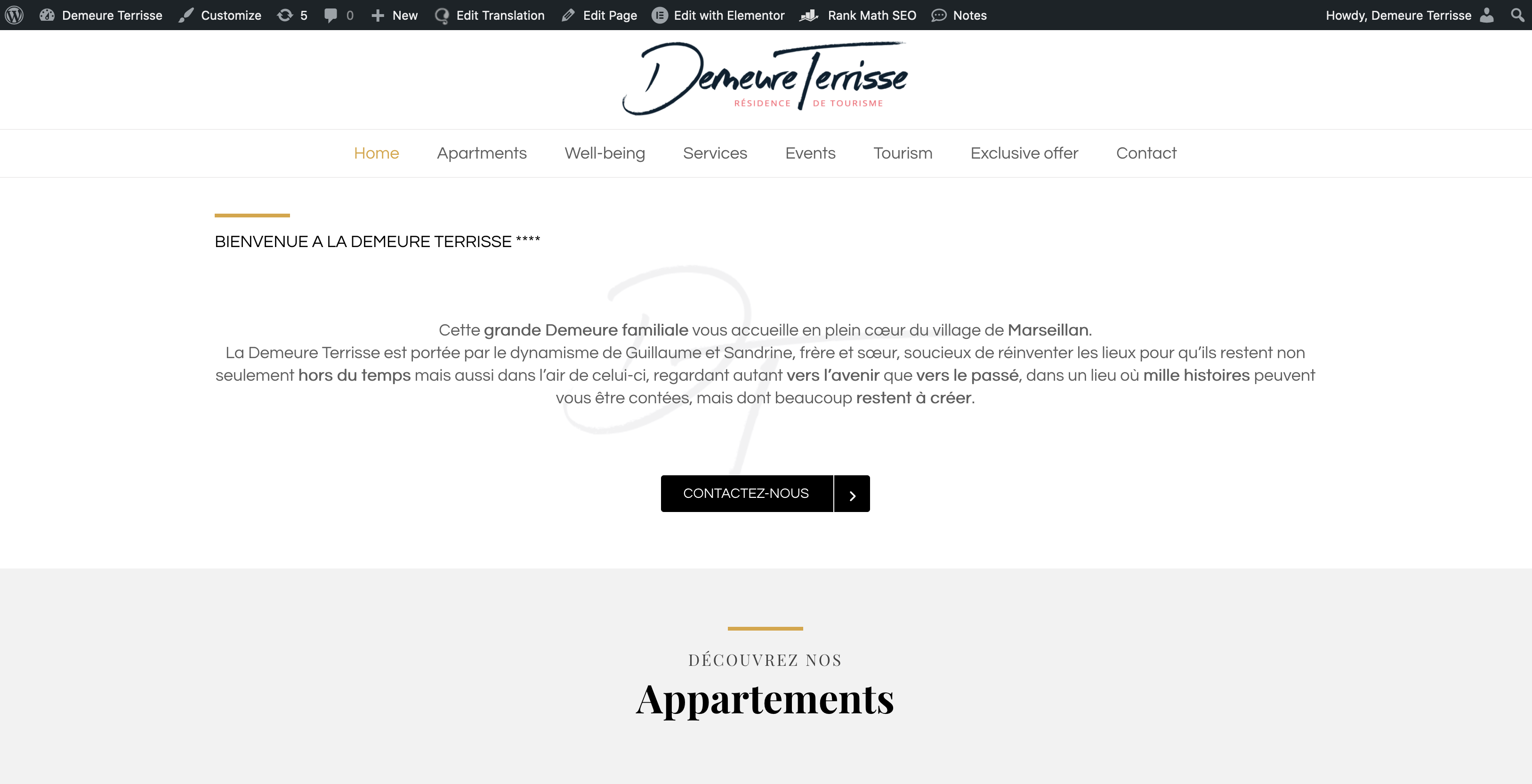

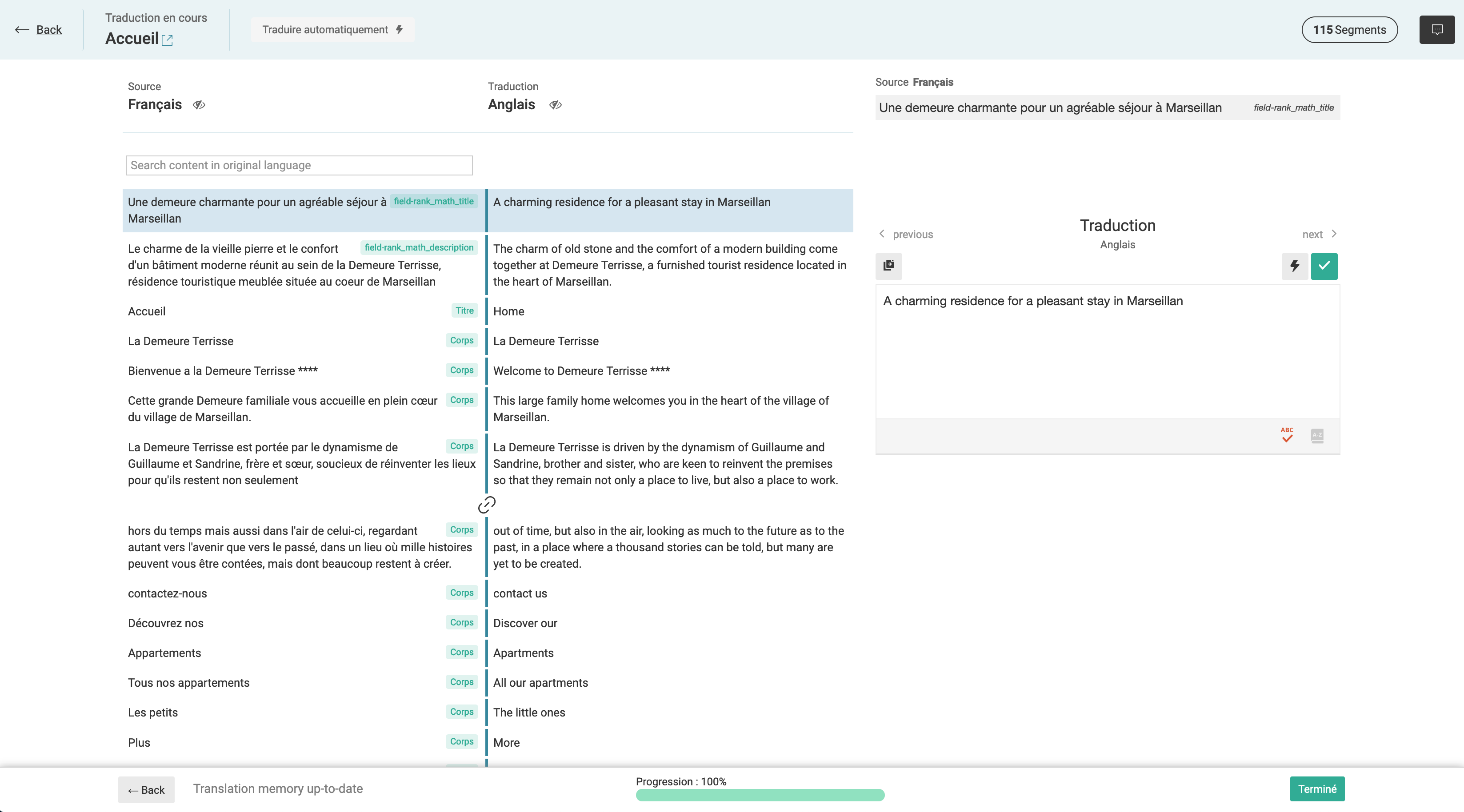

I'm experiencing an issue with WPML on my WordPress site built with Elementor. I've installed WPML Multilingual CMS and WPML String Translation, opting for automatic translation for the following elements: header, footer, pages, articles, and archives.
However, I've noticed that not all elements are translated as expected. Some elements, like the header and footer, are correctly translated, but others are not or do not appear on certain pages, articles, and archives. Yet, when I check the translations in the WPML dashboard, the content is indicated as 100% translated.
Attached, you will find screenshots illustrating the differences between what is displayed on the site and what is indicated in the WPML dashboard.

Thank you for the access.
1) I was able to check your website and I noticed on WPML -> Translations, that some pages translation is "In progress".
2) Also, on WPML -> Translation Management, I noticed that there are no credits to use for Automatic translation.
3) I was able though to check that the parts you need translated show on WPML -> String Translation, where they can be translated (I searched for "Découvrir") .
Could you please check what mentioned above and let me know?

1 / I have now finished the "In progress" pages translation. There are now all marked as finished.
2 / My account is set up as Pay as you go. See here: hidden link
I don't see any issue with that?
3 / I'm not quite sure what you mean. But I will explain the issue again in this video, so that is clearer for you :
I hope this video will help you to understand the issue.
We have the same issue with most of the pages and posts.
Example of the issue with a post:
Whereas all the translation are set here: hidden link
Can you please tell me how to fix this?

Marsel Nikolli
Thank you for the video.
The issue seems related to the WP MEMORY LIMIT being 40M when you translated the website's content.
I just did a test with this page: hidden link,
- I added a "+" sign to the page title, saved the page and then removed it again
- That triggered an update of the translation as well.
If you check: hidden link, the English version should be showing correctly translated now.
Try following the same steps I did on any other page that might have the same issue and let me know if you have any other problems.

    I just clear and disabled any cache system on the server, but I can't see the translation still.
    I did a full update of the extensions also.
