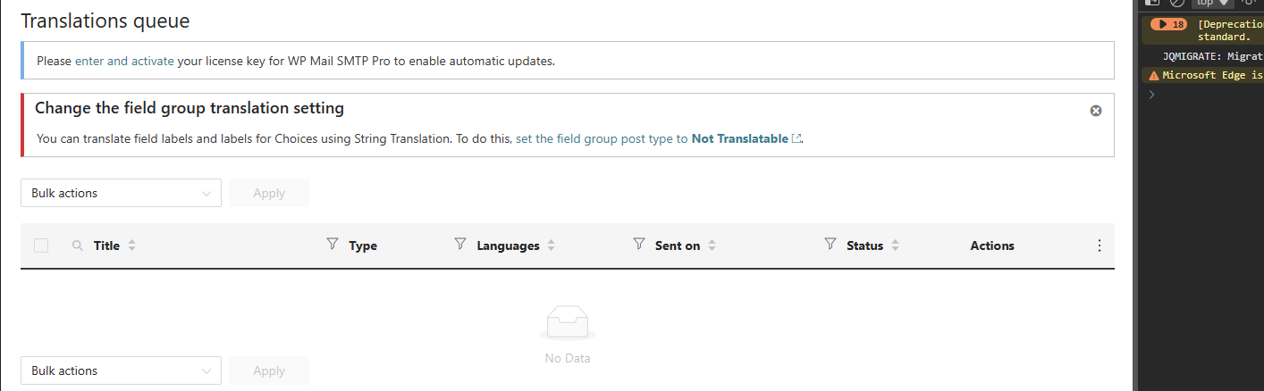

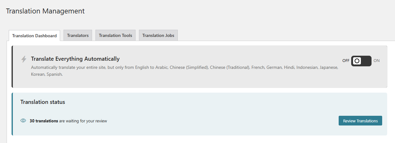

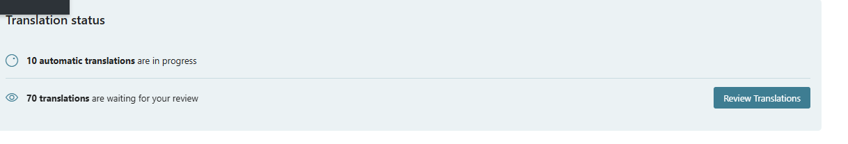

I have sent translations off to WPML using DeepL for translation and selected 'Publish and Mark for review'. We don't translate everything to manage costs, so we are selective about what is translated. I didn't select automatic publish and review by WPML AI for the same reason.
After clicking the 'Review Translations' button link shown on the Translate Management Dashboard, I'm redirected to the Translations page and the table shows 'No Data'.
Why are the translation jobs stuck in 'Pending for review' status?
Why does the Translations page show 'No Data' after clicking 'Review Translations'?

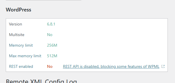

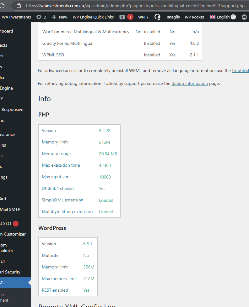

It seems the minimum requirements on the server are not met:
https://wpml.org/en/home/minimum-requirements/
Could you please increase the WordPress memory limit (WP Memory Limit) to at least 256 MB? WPML requires at least 128 MB.
Your current values ​​are:
PHP Memory Limit 512 MB
WP Memory Limit 128 MB
To do this, you need to connect to your website's server and open the wp-config.php file in a text editor. The file is located in the WordPress root directory.
Add this code to the wp-config.php file to increase WordPress's memory:
define ('WP_MEMORY_LIMIT', '256M');
Add this just before this comment:
// That's all, stop editing! Happy blogging.
The current values ​​can be viewed under WPML > Support > WordPress.
These settings can be restricted directly by your hosting provider. Therefore, I recommend contacting them and asking them to change them directly if the changes are not applied immediately.
If this will not solve the issue, please take a look at WPML > Support > ATE Error Log and send me a screenshot of the latest entries.
Also, please revise WPML > Support > Installer Support and click "Check now". Do you see any connectivity or site key issues indicated in the results?

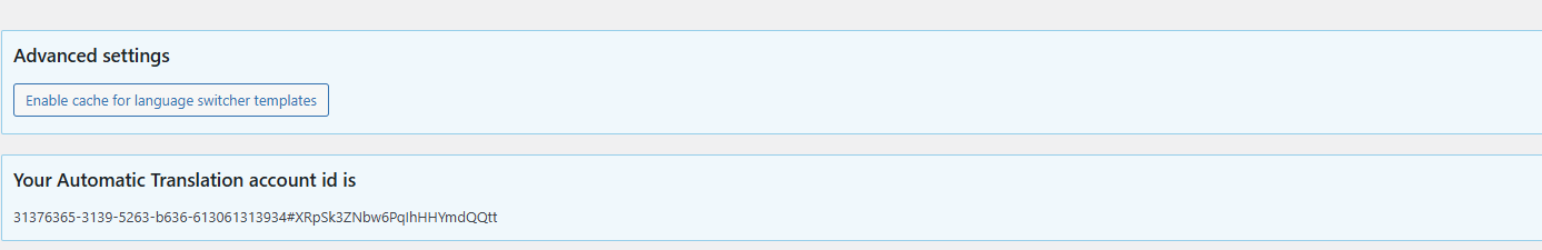

Finally, it also would be helpful if you could send me a screenshot of the Automatic Translation Editor ID used on your site, which can be found at WPML > Support > Troubleshooting inside the top section of the page.

May 5, 2025 at 1:26 am #16994082
paulW-64
Hi Andreas,

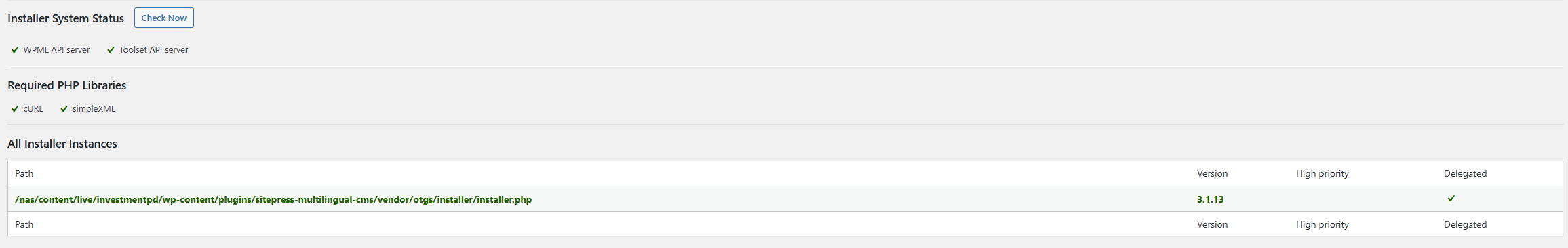

I have made the necessary adjustment for memory as requested; you can see from the screenshots included.
I have also provided the screenshot from the Installer Support showing that all is connected as expected.
And finally, I have included the screenshot from the Troubleshooting section.
However, the issue persists.
Please also note that from a security standpoint, we have denied access to all REST APIs
I can allow REST API access, but it would be handy to know which routes are used, can you provide them?
May 7, 2025 at 12:03 am #17003931
In this case, the problem may be caused by the disabled REST API, which is required by WPML.
Source:
https://wpml.org/documentation/support/rest-api-dependencies/
Please test enabling the REST API temporarily and creating a new job.

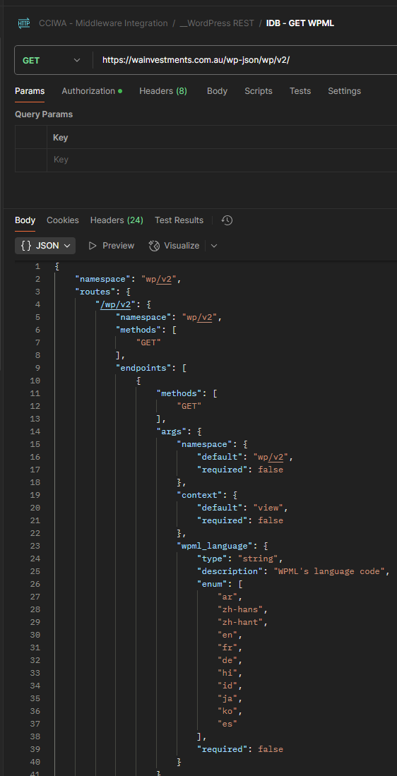

May 7, 2025 at 5:59 am #17004241
paulW-64

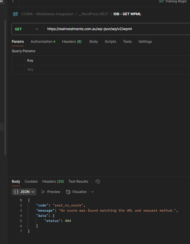

Please note that the restriction I have in place is on the server itself.
And the setup in our office allows me to view the REST API as you can see from the attached screenshot showing the base endpoint - hidden link
However, when using Postman and append the URL to include /wpml as per the document which you provided as per this URL - hidden link
Which based upon the other screenshot, I should be able to fetch.
I get "No route was found matching the URL and request method." as you can see from the included screenshot.
I remove the rule from the server and fetch the base of the REST API /wp-json/
I can see from here the endpoints as per the documentation.
I think the documentation should be updated to show it like
Example:
And while after removing the restriction on the server, the support page shows no problem with the REST API as per the screenshot included.
Following your instructions, I sent another job for automatic translation as I have previously as per the screenshot included. However, the issue persists and upon clicking the button to "Review Translations", the screen loads with no data listed.

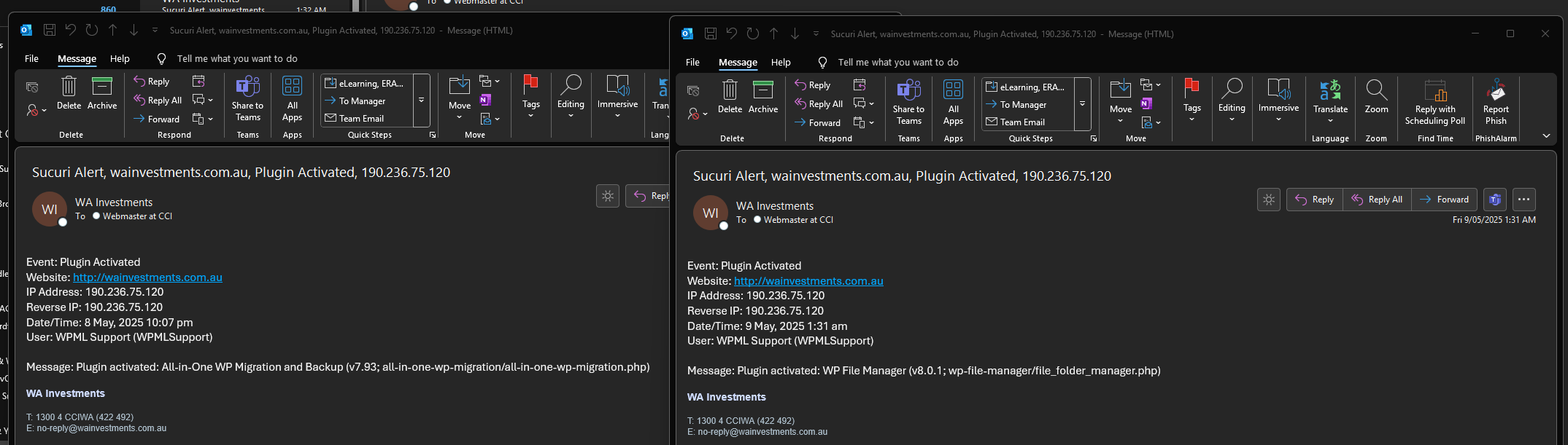

It looks like the capability "wpml_translate" is missing inside the WP User Roles.
I can try to fix this using a custom snippet, but sadly the FTP access I not working and I get a 403 Unauthorized error when trying to use a File Manager Plugin.
Note, that issues like this arise if manual edits have been made to the database or when using plugins like "User Role Editor".

Strange, as I have received two emails stating that plugins were activated.
I test the SFTP connection and it appears fine for the details I provided and I have saved.

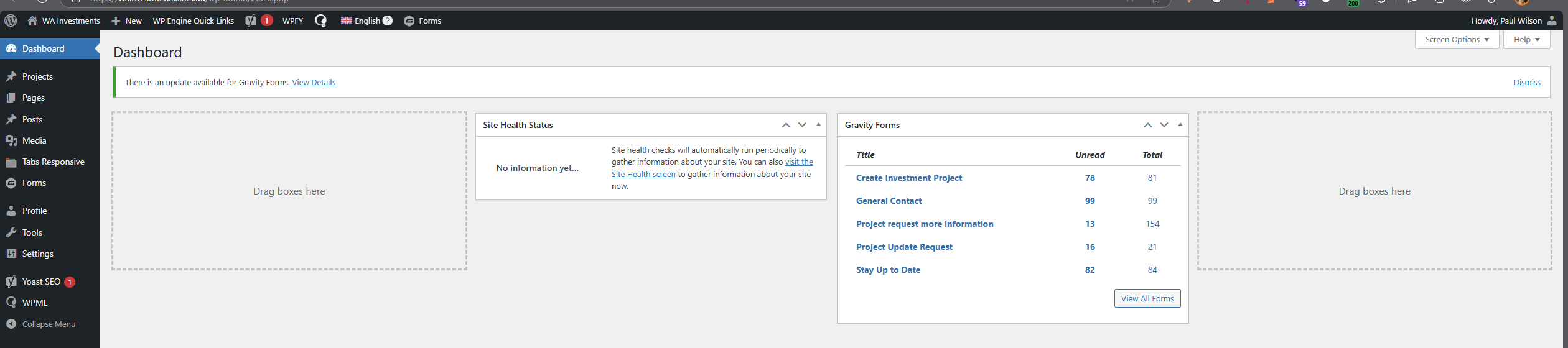

I did notice that my user profile and another with Admin roles where not showing all options.
I have had to restore the website to the point I saved prior to you investigating this issue, as it broke the Administration view in the backend.

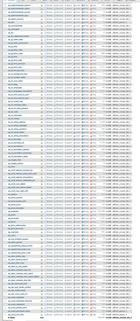

I went onto the WP Engine Logs page and found the below error logged. Looks like it is an issue with querying the data.
I included a screenshot of the DB Schema, there are only 3 tables which use a slightly different collation.
utf8mb3_general_ci (3 tables use this)
utf8mb4_unicode_520_ci (all others appear to use this)
From what I see in the error log, I can't see any of the 3 tables referenced. However, the log is cut off short.
Perhaps the issue is with the Yoast tables.

May 9, 2025 at 6:24 pm #17017668
The error states:
WordPress database error Illegal mix of collations for operation
All tables and the same database should be set to "utf8mb4_unicode_520_ci".
You will also need to make sure that this value is set on specific columns of each table.
Tools like phpMyAdmin have a special option on the "Operations" tab, which will adjust the value for table structures and table entries with one single click.
In doubt, please consult your hosting support.

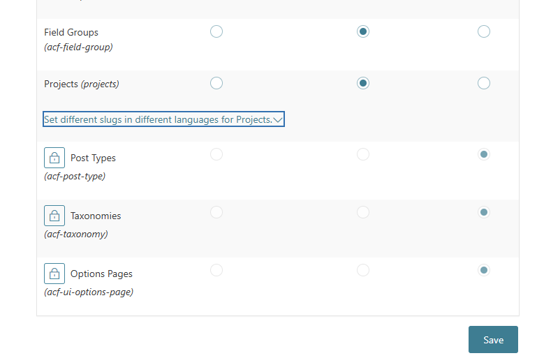

May 13, 2025 at 4:40 pm #17029184
Note, that "Field Groups (acf-field-group)" at WPML > Settings > Post Types Translations should be set to "Not translatable".
It was currently set to "Translatable use translation if available or fallback to default language" and I changed it to "Not translatable".
If I now go to WPML > Translations I can see the available reviews.

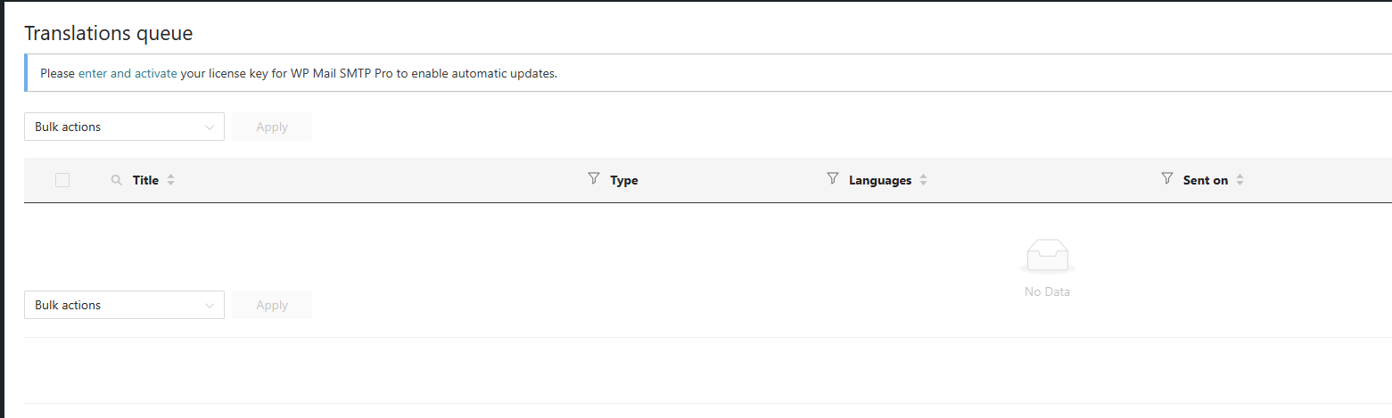

May 14, 2025 at 1:24 am #17029984
paulW-64
I see that the error message is gone, however when I visit the below URL, it still is not showing the items for review for my profile.
/wp-admin/admin.php?page=tm%2Fmenu%2Ftranslations-queue.php
When I visit the below URL it shows information, similar to your screenshot but no "Actions" are shown.
/wp-admin/admin.php?page=tm%2Fmenu%2Fmain.php&sm=jobs

May 14, 2025 at 2:24 am #17030005
It seems the issue was that ACF Field Groups were set to "Translablable", but they should not be translated. It might be that a translation job for one of the ACF groups caused an issue.
If you can not see any translation or review options, then the user is not an admin or is not assigned as a translator in Translation Management > Translators.
