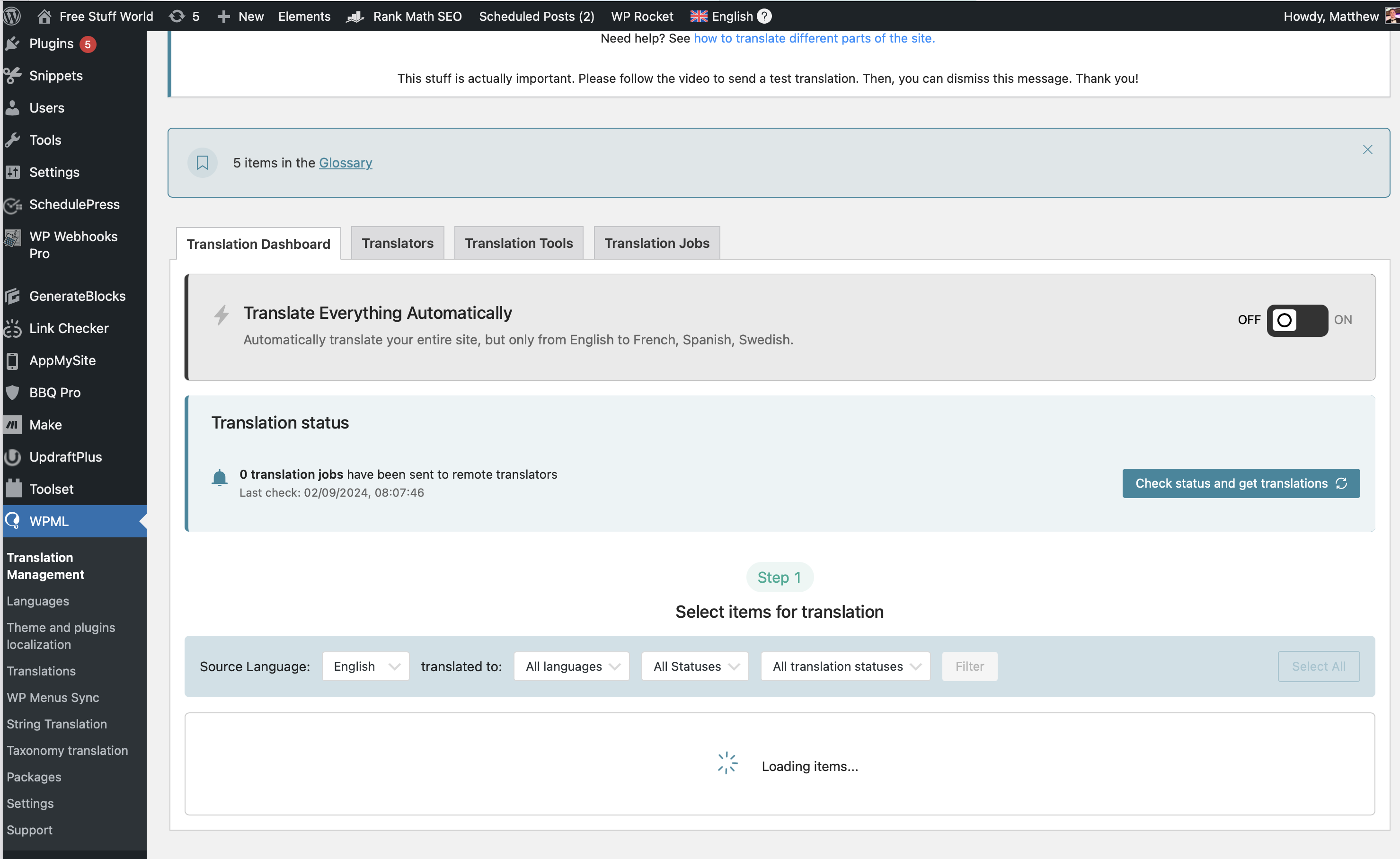

I am trying to load the list in translation management, but it just says 'loading items...' forever. Link to a page where the issue can be seen: hidden link. Console log: <code>[Info] Successfully preconnected to hidden link [Log] JQMIGRATE: Migrate is installed, version 3.4.1 (load-scripts.php, line 5) [Error] Failed to load resource: the server responded with a status of 403 () (populated, line 0) [Error] q (anonymous function) (dashboard.js:1:180054) (anonymous function) (dashboard.js:1:179145) y (node-modules.js:2:275279) u (node-modules.js:2:275753) (anonymous function) (node-modules.js:2:270026) [Error] Failed to load resource: the server responded with a status of 403 () (populated, line 0) [Error] q (anonymous function) (dashboard.js:1:175871) (anonymous function) (dashboard.js:1:174923) y (node-modules.js:2:275279) u (node-modules.js:2:275753) (anonymous function) (node-modules.js:2:270026) [Error] Failed to load resource: the server responded with a status of 403 () (populated, line 0) [Error] q (anonymous function) (dashboard.js:1:180054) (anonymous function) (dashboard.js:1:179145) y (node-modules.js:2:275279) u (node-modules.js:2:275753) (anonymous function) (node-modules.js:2:270026) [Error] Failed to load resource: the server responded with a status of 403 () (populated, line 0) [Error] q (anonymous function) (dashboard.js:1:180054) (anonymous function) (dashboard.js:1:179145) y (node-modules.js:2:275279) u (node-modules.js:2:275753) (anonymous function) (node-modules.js:2:270026) [Error] Failed to load resource: the server responded with a status of 403 () (populated, line 0) [Error] q (anonymous function) (dashboard.js:1:175871) (anonymous function) (dashboard.js:1:174923) y (node-modules.js:2:275279) u (node-modules.js:2:275753) (anonymous function) (node-modules.js:2:270026) [Error] Source Map loading errors (x2) [Error] Failed to load resource: the server responded with a status of 404 () (dashboard.e6ac4d17.css.map, line 0) [Error] Failed to load resource: the server responded with a status of 404 () (dashboard.bundle.js.map, line 0) [Log] [Private Click Measurement] Triggering event accepted. (x6)</code>
The list of items to translate never loads. Console log shows multiple 'Failed to load resource' errors with status 403 and 404.
Why won't the translation management list load?

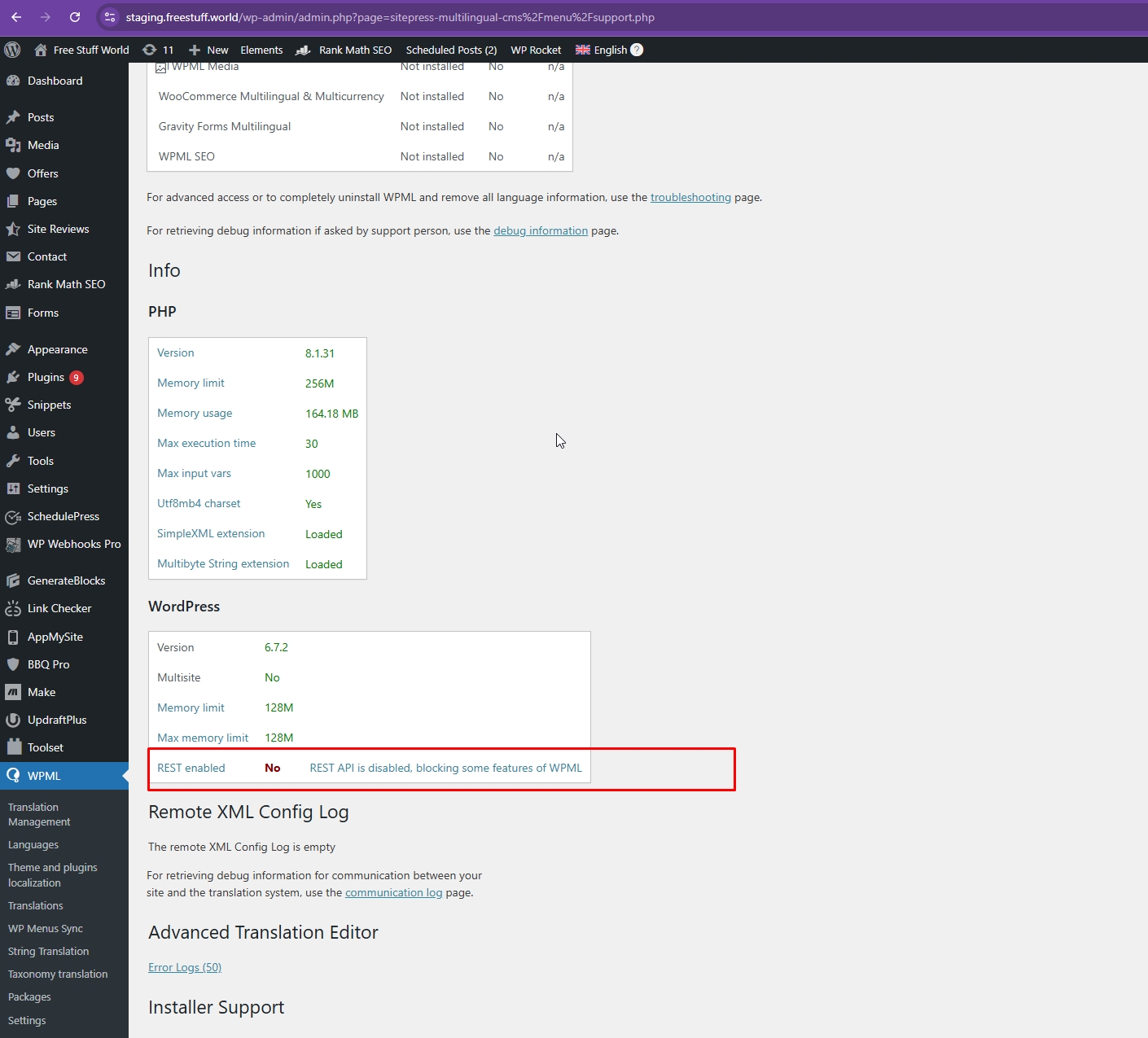

I've checked and I noticed that the "REST Enabled" is showing "No" as shown in the attached screenshot here hidden link in WPML > Support . Please follow the instructions here https://wpml.org/documentation/support/rest-api-dependencies/?utm_source=plugin&utm_medium=gui&utm_campaign=wpmlcore to fix the issue. Let me know how it goes.

Not sure what is blocking this, how often does it check?
Because I assumed it was either Cloudflare or our security plugin BBQ Pro.
I disabled both on the staging site and it still says REST enabled NO.
I am unsure if its still blocked or WPML is just not trying every page load to see if its enabled?
Can you see any info on the response when its blocked?

Good news figured this out it was BBQ Pro plugin as it blocks query strings with [ ] in them which the requests contain.
However oddly its still showing as REST enabled NO but it is working fine now.
Any reasons why this is still showing as NO? Checked the firewall log as well and no requests there.

Thanks for your reply.
It could be a false positive. But if everything is working correctly now, you can ignore this and continue to work on the site without issues.
