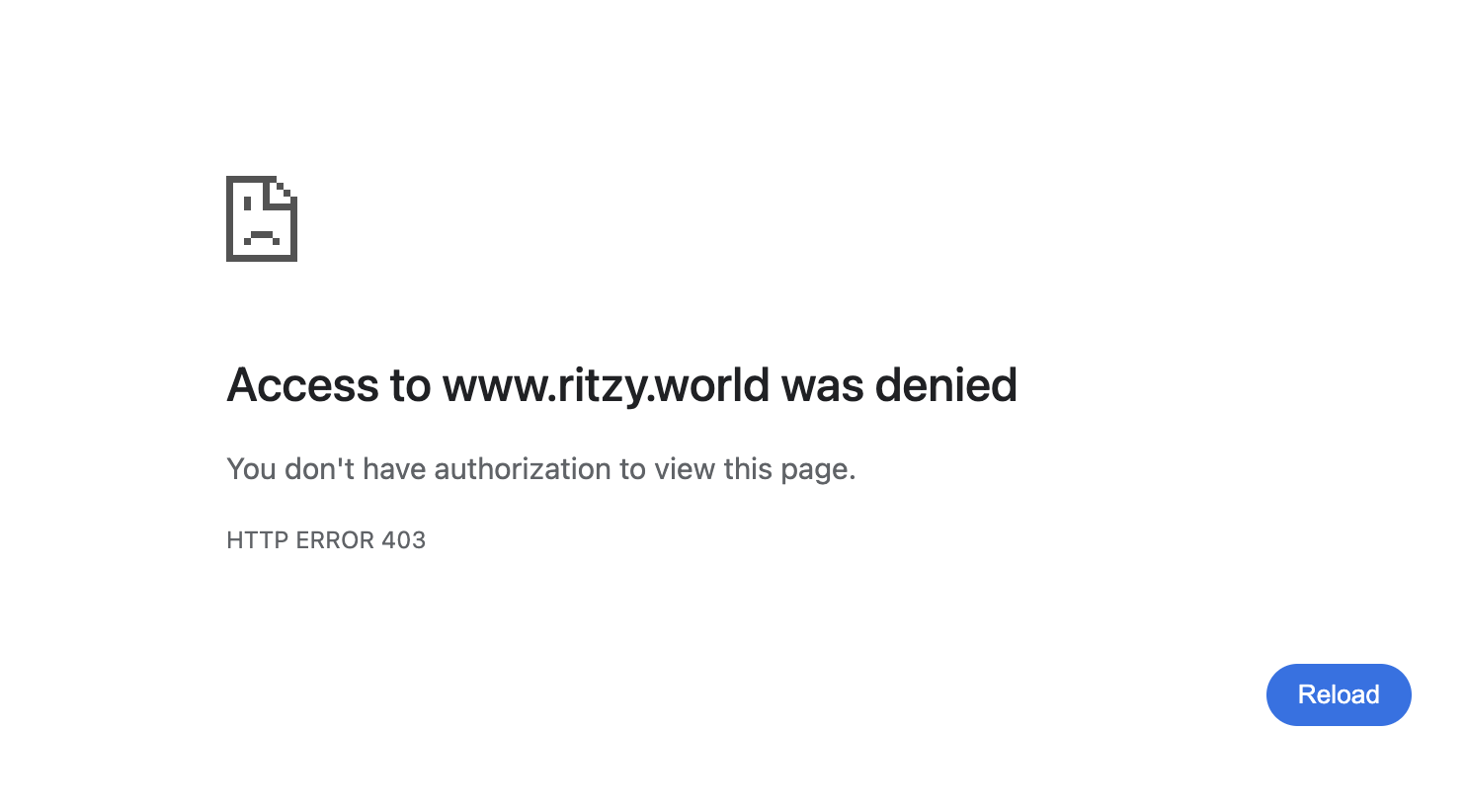

Please see the attached screenshot, I'm getting access denied when I try to login. Also, we do not offer support via phone call or email, only here ini the forum. I'm not able to add additional email addresses to the response, they get sent automatically to the email address you have set up on your WPML account. You can update this email from your wpml.org profile page at anytime if you prefer.
Please let me know when I have access so I can login, disable plugins/theme and test translating these templates. Thanks!
