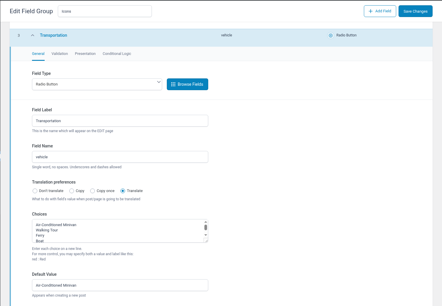

The client is using radio option values that aren't translatable in their project.
We recommend setting up the radio options to be translatable by following the method described on the Advanced Custom Fields site. Specifically, format the choices field like this:
red : Red
. After updating the choices, the client should try translating the labels as explained in the WPML documentation on translating sites built with ACF. For more details, visit the following links:
If this solution does not apply to your case, or if it seems outdated, we highly recommend checking related known issues at https://wpml.org/known-issues/, verifying the version of the permanent fix, and confirming that you have installed the latest versions of themes and plugins. Should you need further assistance, please open a new support ticket at WPML support forum.

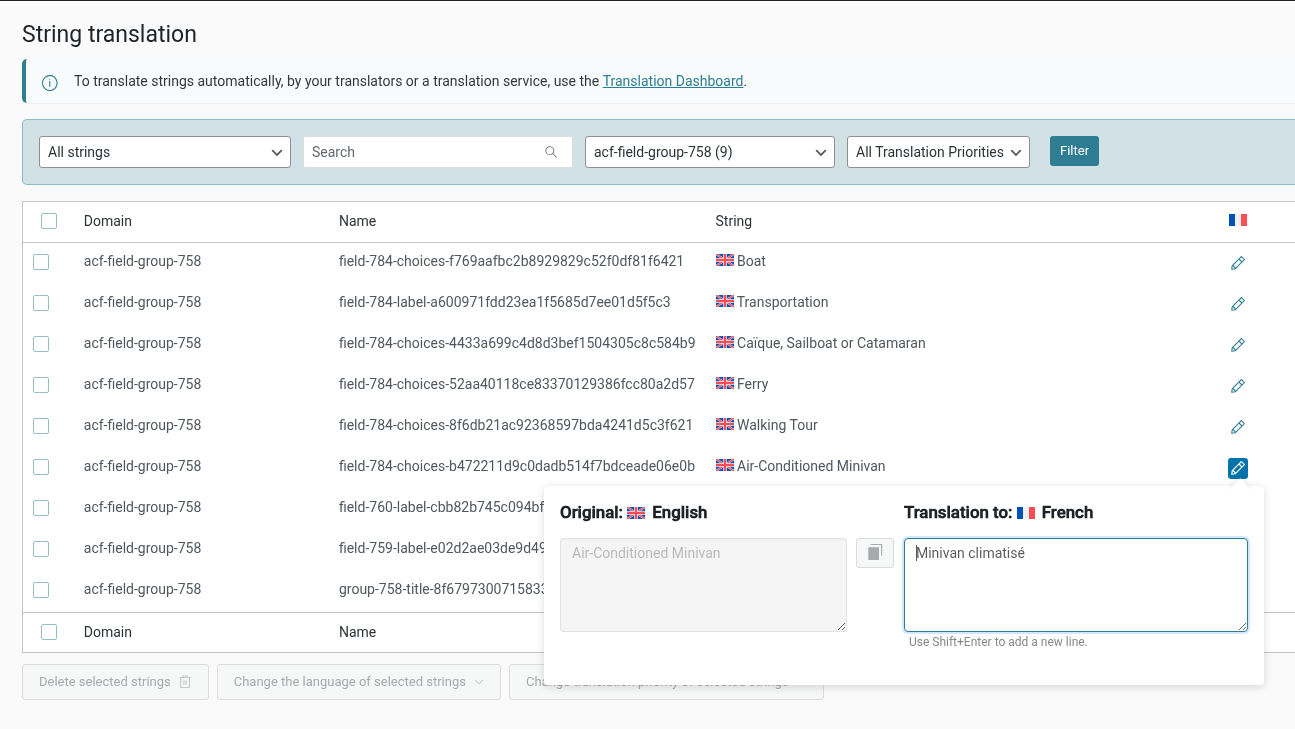

December 31, 2025 at 4:37 am #17697912
Shekhar Bhandari
WPML Supporter since 03/2015
Thank you for contacting WPML support. I’d be happy to help you with this issue.
You’re currently using radio option values that aren’t translatable. I recommend setting them up using the methods described here: hidden link
For example, the choices field should be formatted like this:
red : Red
After updating the choices, please try translating the labels as explained here: https://wpml.org/documentation/related-projects/translate-sites-built-with-acf/#acf-field-choices and see if that resolves the issue.
I look forward to your reply.
Thanks,
