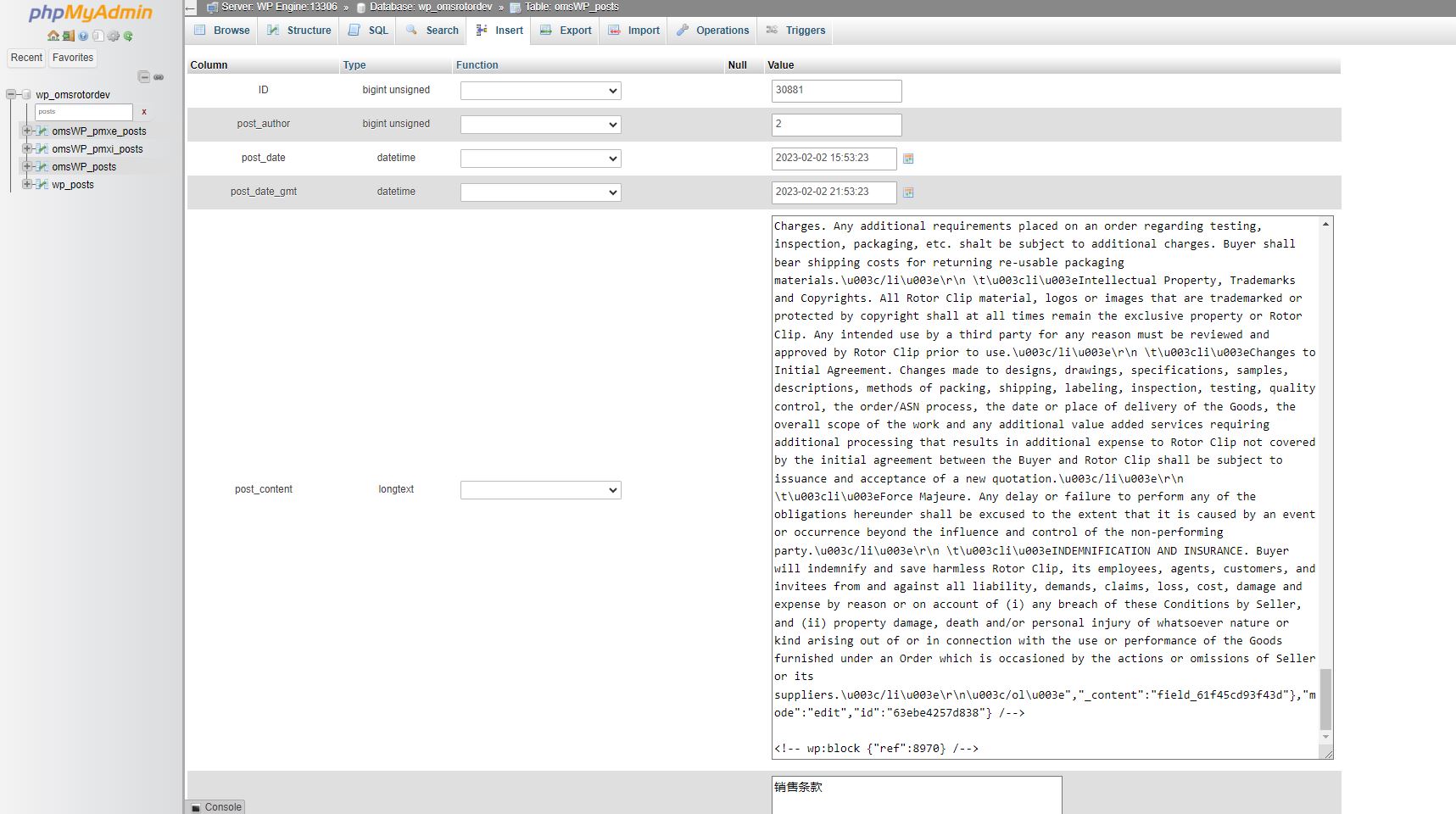

One other interesting thing I noticed after I shot the video; if I look at the post_content field in the database, I can see that it loaded the English content, but even that English content is not appearing. If I delete this content from the database and re-import, it appears. So it is able to grab the English content for some reason. See attached screenshot.

One point of clarification; the English content never appears on the front end of the site but does appear in the database. If I delete and reimport, it again appears in the database but not the front end of the site.
