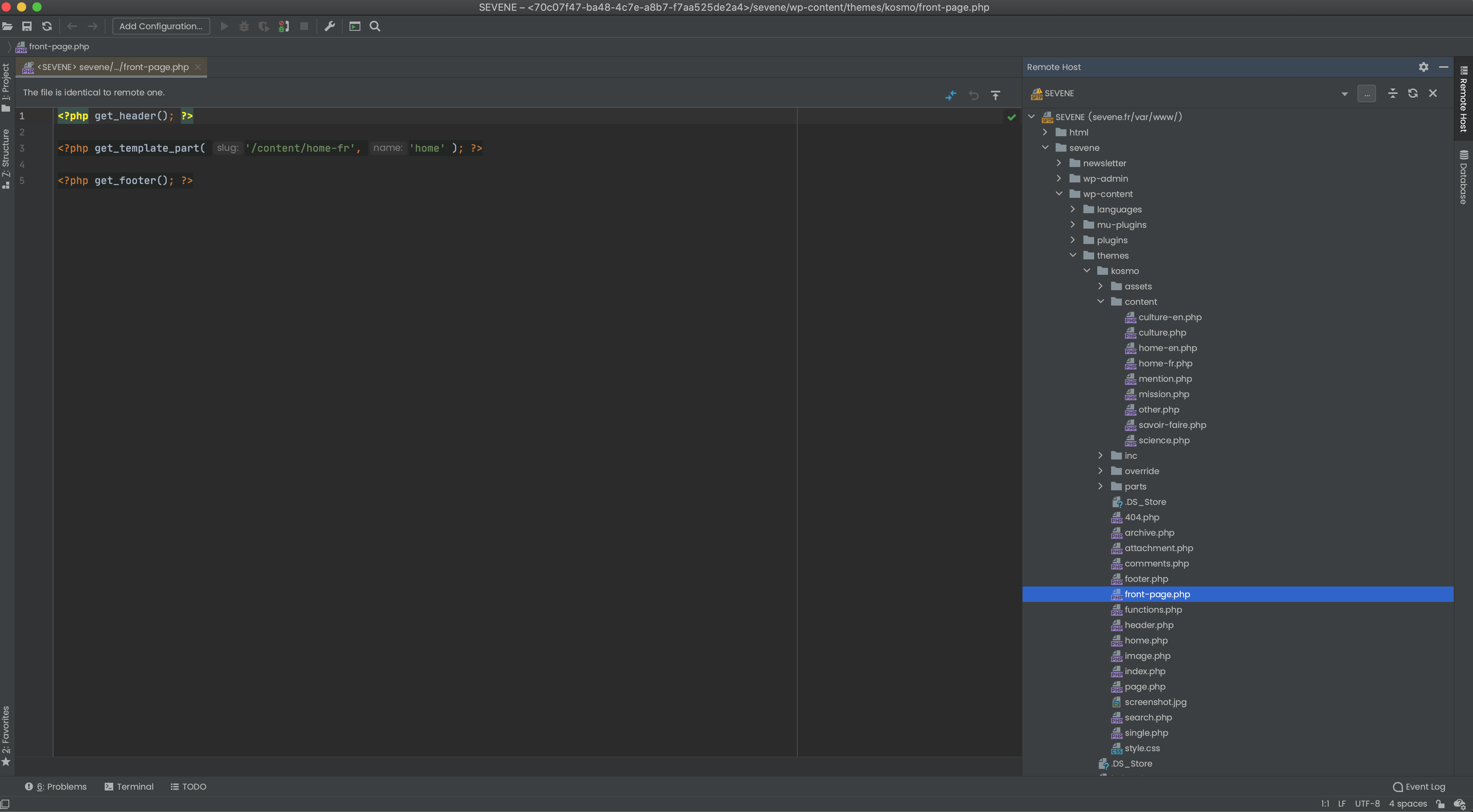

I need help with my custom theme for one of my clients.
I read this topic but I think I'm doing it wrong> https://wpml.org/forums/topic/using-custom-page-templates/
I have a front-page.php page which will look in one of my theme files /content/home-fr.php and home-en.php
When I duplicate the page for the EN version it does not save the template for the home-en.php
So I'm stuck and I can't translate the site.
Can you help me on that please?
Regards Nicolas

Thank you for contacting our support service. From the provided screenshot I see you are using a front-page.php template file, when doing so WordPress will render the homepage content using this template file. In the files contents it seems you are always getting the home-fr content no matter the language viewed. Although I can try to point you on the right direction, please note, to provide custom code is out the scope of our support service. I would recommend you to proceed this way:
1 - Instead of calling template parts in your front-page.php file, create a separed template for each language, for example page-template-en.php and page-template-fr.php.
2 - Then, manually adjust the pages in your WordPress Dashboard to render content either using the page-template-en or page-template-fr files.
3 - If you want to keep your current structure, please, make sure to look into our WPML API docs in order to understand how to load a different file according the language viewed.
See:
https://wpml.org/documentation/support/achieving-wpml-compatibility-for-your-themes-and-plugins/
https://wpml.org/documentation/support/wpml-coding-api/
As said, while we are happy in providing you with the directions above, we are not able to provide you a custom solution or to provide a fix for your code. For this kind of request, we recommend you to consider one of our WPML contractors at: https://wpml.org/contractors/
Hope it brings some clarifications on how to proceed. Thank you for your understanding, have a nice day.

Hello Marcos,
Thank you for your answer.
So if I understand correctly my front-page must call either page-template-en.php or page-template-fr.php
That's right ?
I try to do this as soon as possible and get back to you.
thank you for your help

Hello Marcos,
My problem is solved.

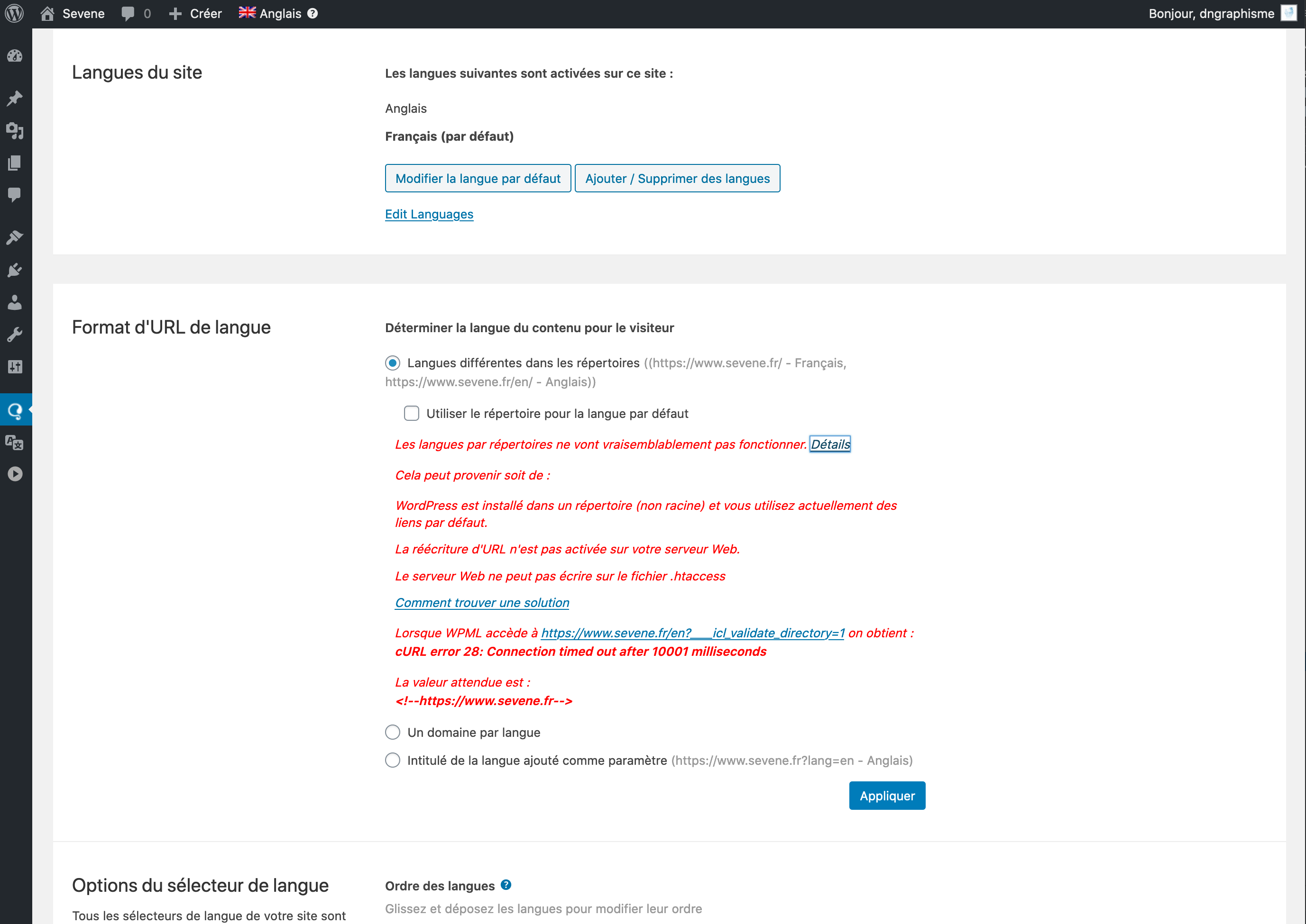

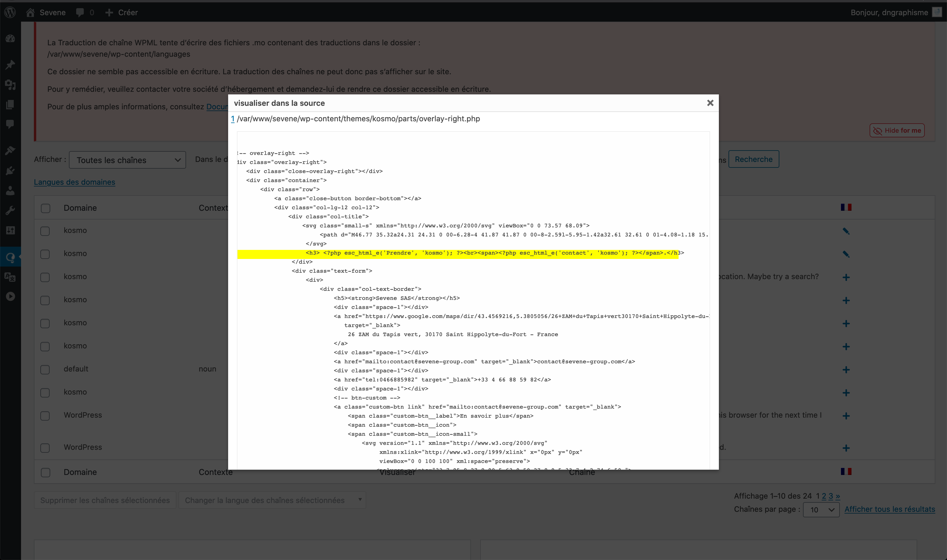

Something else: I'm trying to translate a field in an overlay that I created for my client's contact page (see PJ)
Except that I see that WPML cannot write in the file (I requested correction to the host but for the moment it does not work)
Is this what causes the concern of front translation?
Best regards
