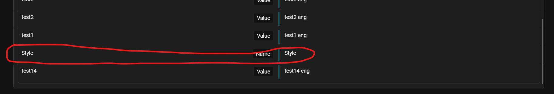

I think that might be it — I just created a new test product on the demo site: TH19534, and after translating it, everything ended up completely out of order again. So it really seems like the issue happens during product creation, when everything (theme + extensions) is already active.
Also, is it normal that in the WPML translation interface, the variation name always appears second-to-last? I'm not sure if it’s related, but I thought it was worth mentioning just in case.
May 30, 2025 at 9:09 pm #17093450
Lauren
I don't think the placement of the variation is an issue. However, we need to test on the staging site back in minimal and create a new product and see if the issue is happening. If not, then again activate a few plugins at a time and create another test product until the issue returns.
