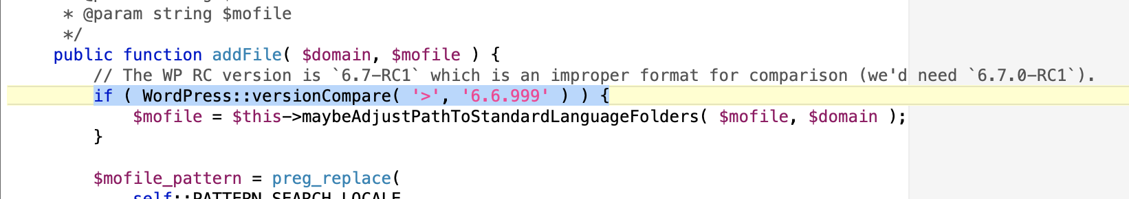

I am trying to address an issue with string translation files under WordPress 6.7.1 and PHP 8.3. I noticed lines like this in the error log: [Tue Nov 26 22:16:16.906964 2024] [proxy_fcgi:error] [pid 917641:tid 140596165412608] [client 4.227.36.112:0] AH01071: Got error 'PHP message: PHP Warning: is_dir(): open_basedir restriction in effect. File(/plugins) is not within the allowed path(s): (/home/admin/.composer:/home/admin/web/vud-design.com/public_html:/home/admin/web/vud-design.com/private:/home/admin/web/vud-design.com/public_shtml:/home/admin/tmp:/tmp:/var/www/html:/bin:/usr/bin:/usr/local/bin:/usr/share:/opt) in /home/admin/web/vud-design.com/public_html/wp-content/plugins/wpml-string-translation/classes/MO/LoadedMODictionary.php on line 103'. It seems that the function maybeAdjustPathToStandardLanguageFolders() is not looking for the right folder because WP_LANG_DIR is not defined. There is also a check which is probably outdated: // The WP RC version is `6.7-RC1` which is an improper format for comparison (we'd need `6.7.0-RC1`). if ( WordPress::versionCompare('>', '6.6.999') ) { $mofile = $this->maybeAdjustPathToStandardLanguageFolders($mofile, $domain); } The log entry disappears if I raise that WP version number.

As i said.. in latest stable wpml string translation there is a check on wp version if WP version is higher than 6.6.999 that is apparently calling a function where WP_LANG_DIR constant (not defined in my environment) is used.
if ( WordPress::versionCompare( '>', '6.6.999' ) ) {
File is LoadedMODictionary.php line 63.
This is calling a method that is not considering the fact that WP_LANG_DIR is not defined so results empty and then the code looks for path /plugins which is from system root so not accessible by the php code, generating the warning.
So IT LOOKS LIKE a WPML string translation related problem. And i fixed it by editing that version number. Please fix in next release (the actual beta have no changes related to that, i checked).
thanks
