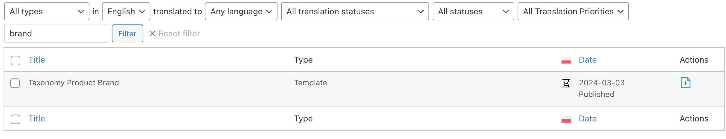

I checked the template in question and it seems that the template has not been translated yet. If you go to WordPress Dashboard > WPML > Translation Management and search for BRAND you will see the "Taxonomy Product Brand" item which shows the sand clock icon next to it which means the translation is not completed yet. (please check the screenshot)
I tried to select that item and send it for translation, but I saw that the job could not be loaded.

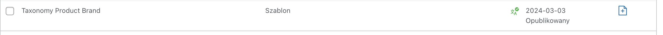

November 18, 2024 at 3:13 am #16412580
barbaraS-29
I did it as you can see in screenshot below and it dosent help
"I tried to select that item and send it for translation, but I saw that the job could not be loaded." - this is permamently problem on our website with every translation i have to delete account and add again for translations. Its not only about staging website.

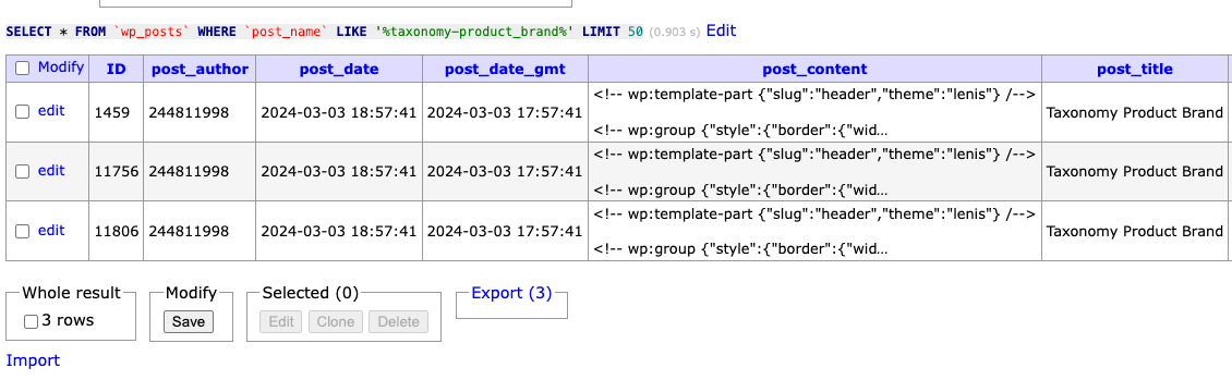

Our second tier support team managed to find the cause, which is an extra template that was created in PL language that caused the issue.
By deleting that from database it fixed the issue:
Please make a backup of your website database and access the wp_posts table and delete the row with the ID of 11756.
Please check the screenshot if you want to know the SQL command needed to find the item.
If needed, you can provide us with access to the database of the website and we can do that for you.
