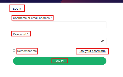

I am trying to translate WooCommerce login form texts on my site hidden link using WPML. I have checked the documentation and followed the steps from the topic https://wpml.org/forums/topic/some-texts-in-woocommerce-login-form-have-not-been-translated/.
Some texts in the WooCommerce login form have not been translated.
How can I ensure all texts in the WooCommerce login form are translated using WPML?

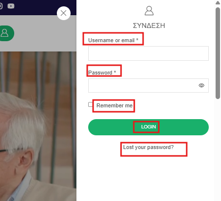

The login form is displayed in two places: on /my-account and when you click the account icon—both of which appear only when you are not logged in.

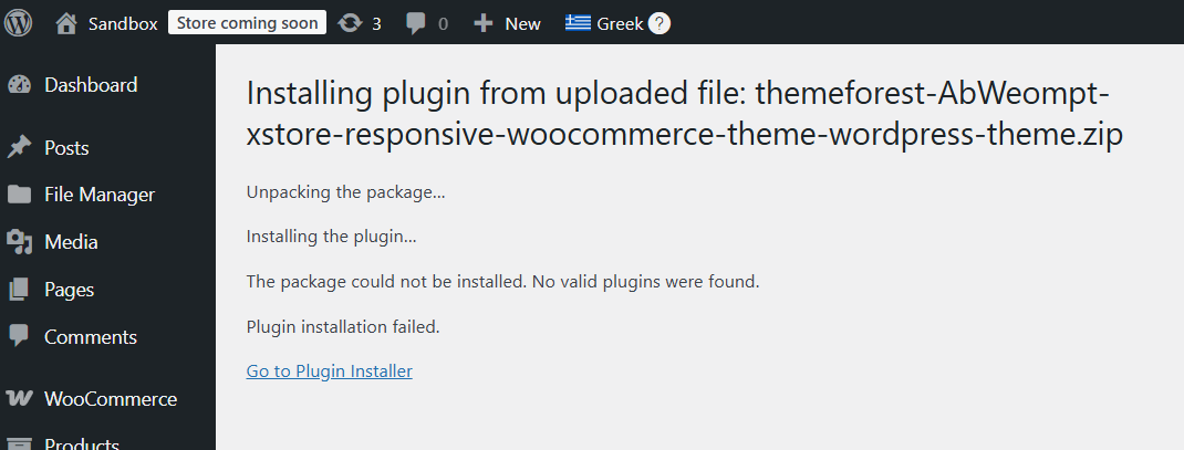

I tried installing the theme on the specified site, but I received the error shown in the attached screenshot.

You need to add it from Themes--> add new
