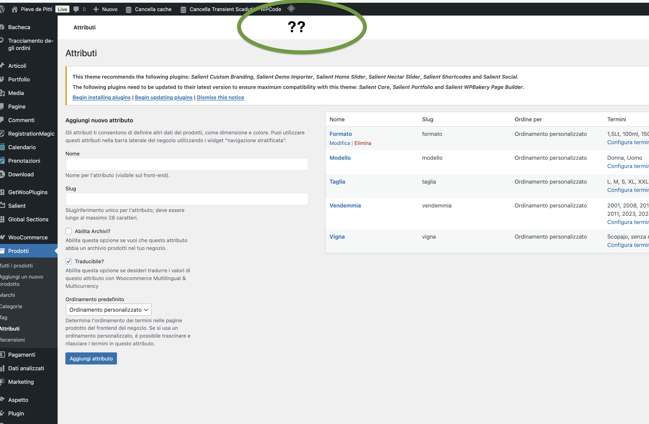

I cannot translate atrtibute. They do not exist in taxonomy translation anylonger.as you can see there is no switch to language in the attribute page and they do not appear in wpml taxonomy translator

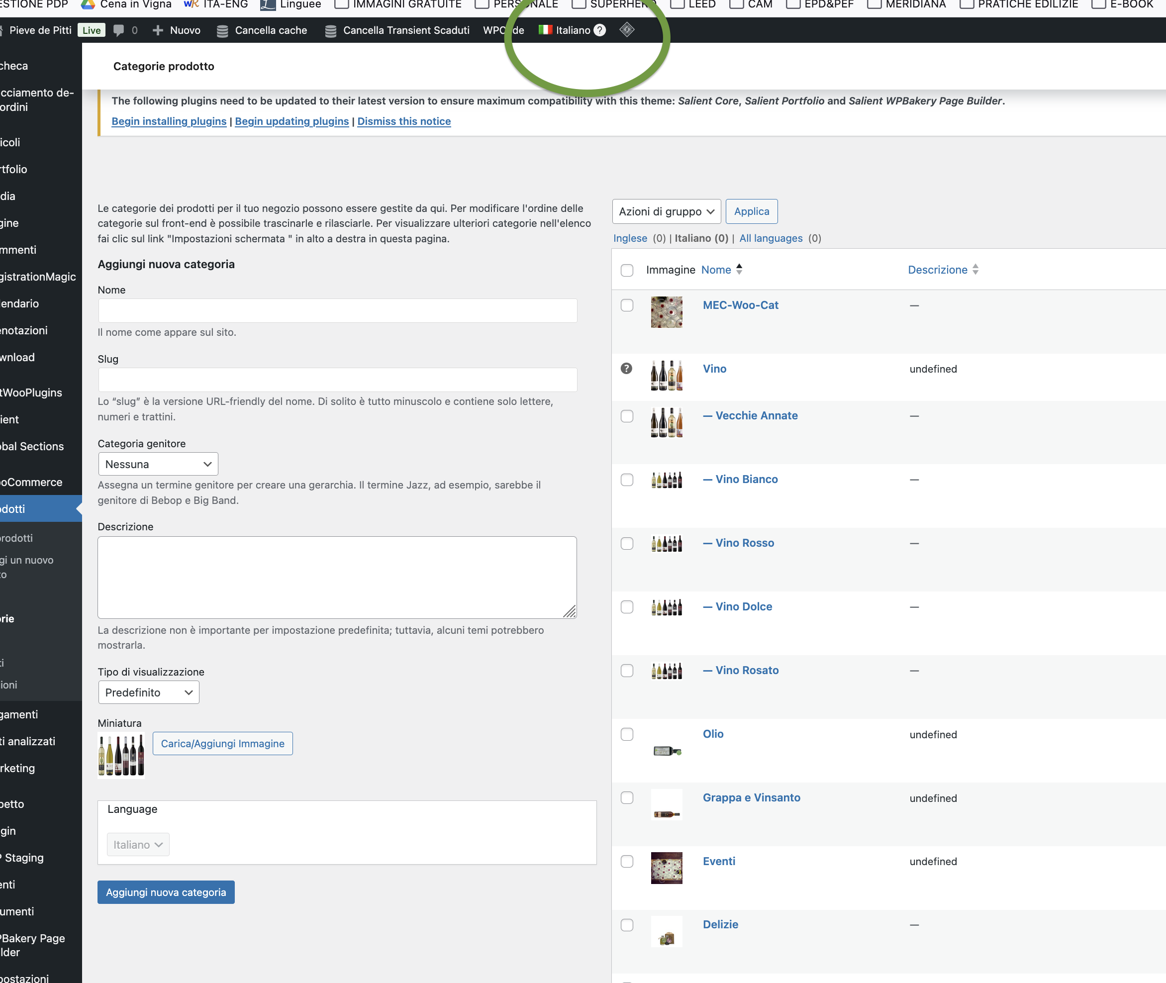

caterinag-2
I don't know why I have now two product categoriues, a general and a singular. That's something new that suddenly appeared after some updating

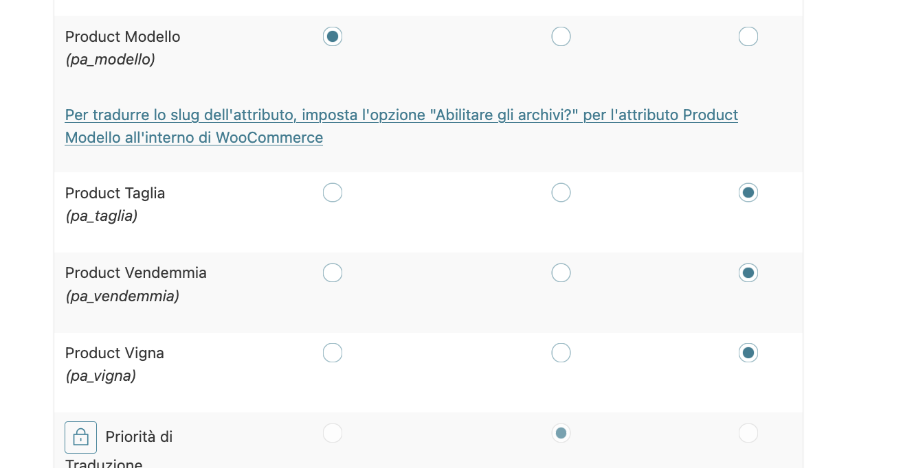

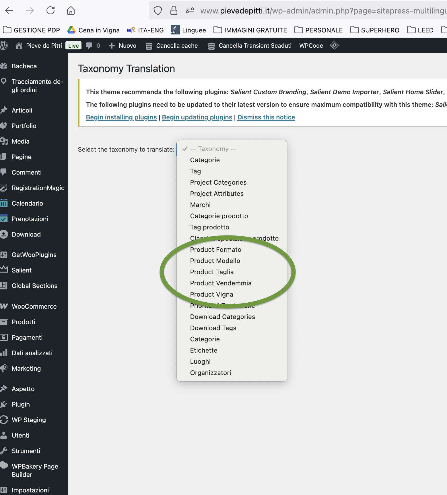

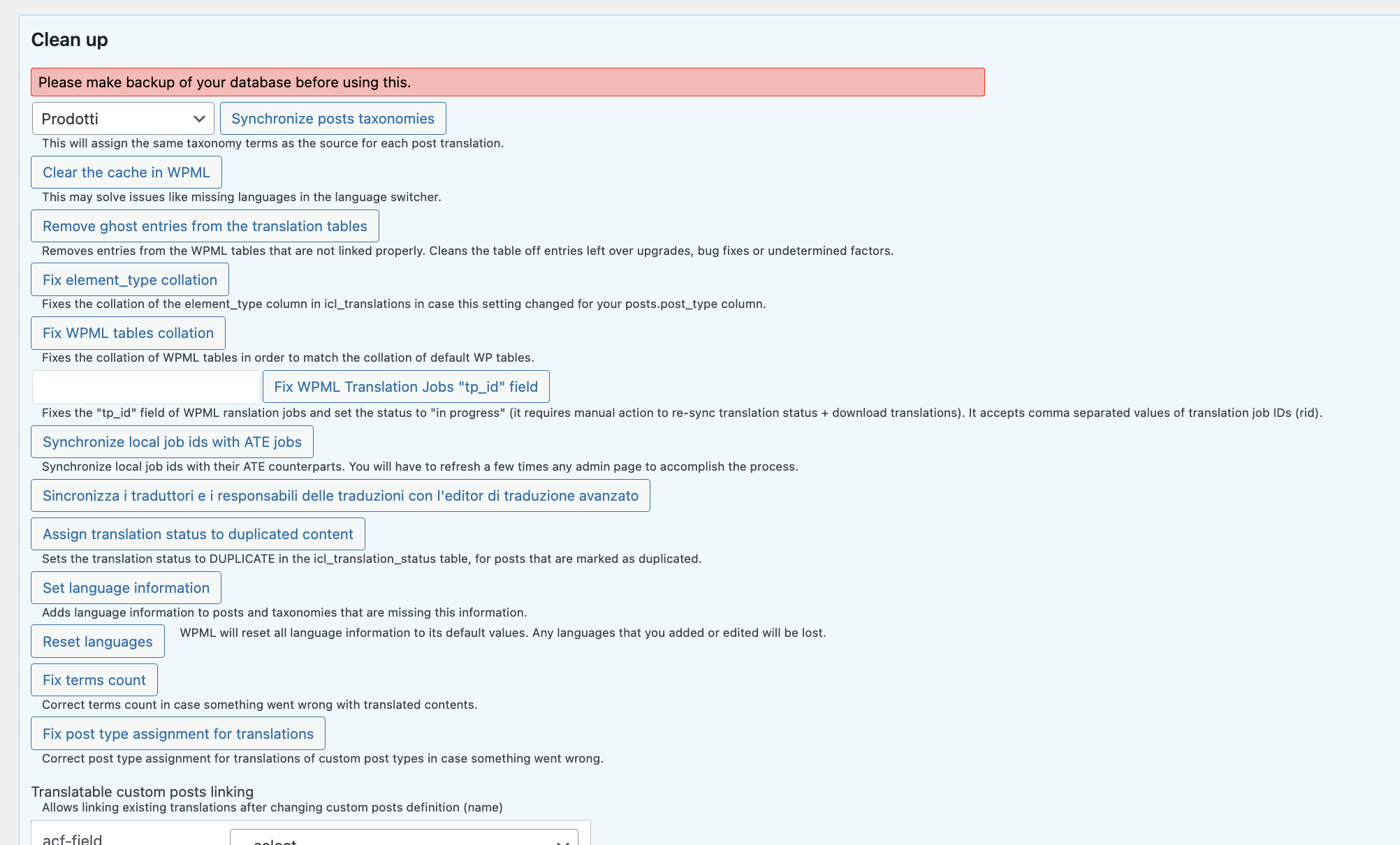

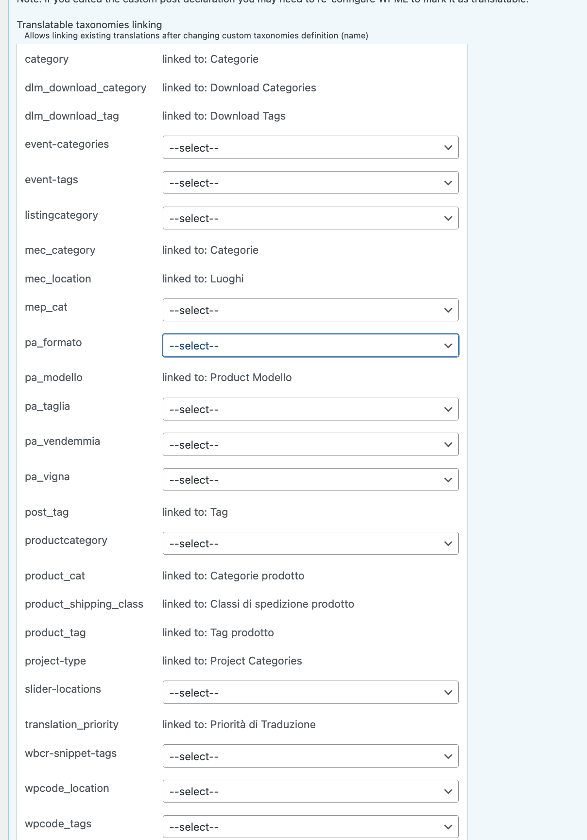

in Taxonomy Translation I found some of the attribute but they are not called "attribute" but Product *** (see picture).
Some attribute are missing.
If I go to Troubleshooting, command you listed do no exist so i cannot run them. (see pircture)
I don't know if I have to reset some links in the taxonomise linking tab (see picture

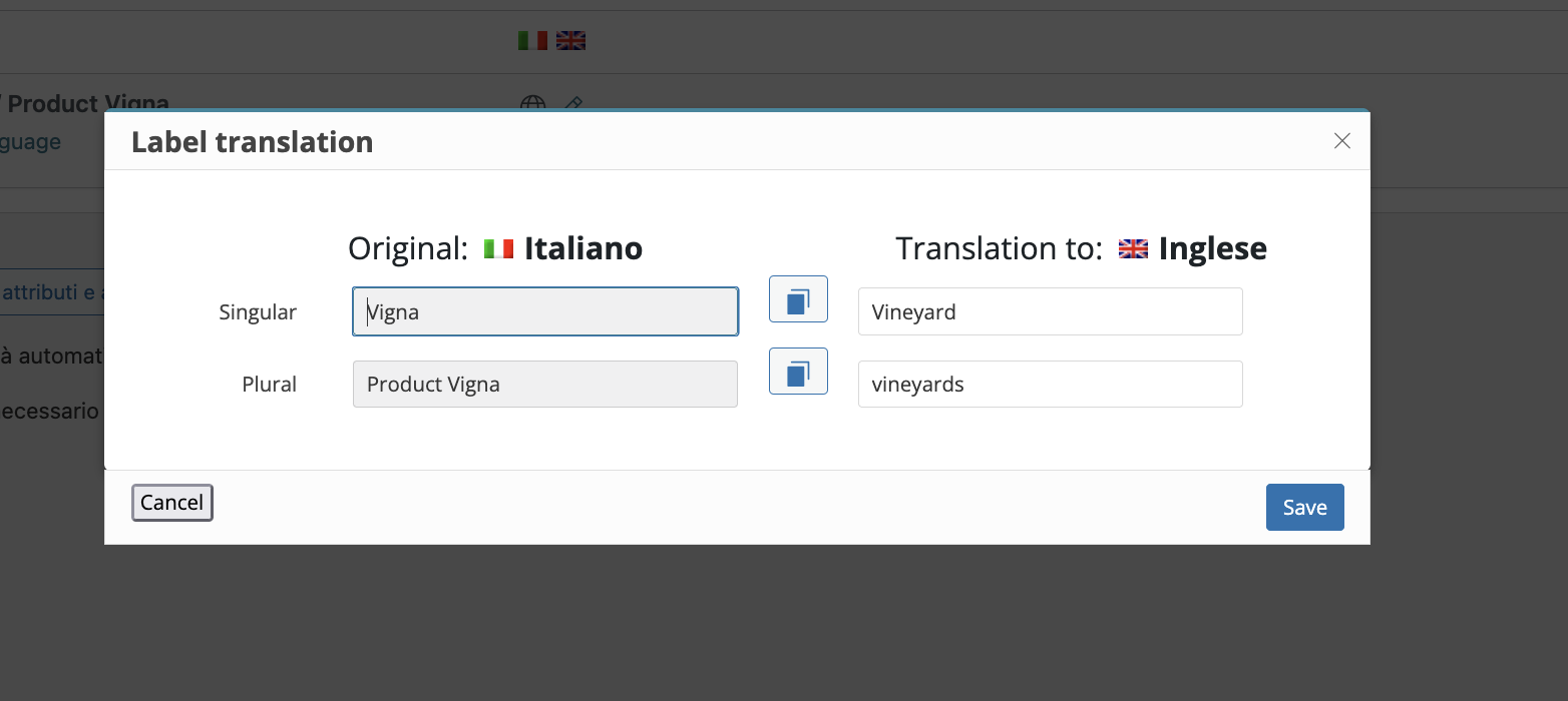

August 11, 2025 at 12:13 pm #17309672
caterinag-2
Hi, I'm still trying to solve it.

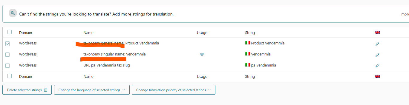

Can you explain me the meaning of "plural" and how to change it?
It makes no sense in ITALIAN and I don't know why is not the slug I suppose to be
Singular "Vigna" is "Vigne" as plural. Product Vigna means nothing
How to change it?
Please onfirm is not the slug (that is set in attribues and it's diferent from that text)
August 11, 2025 at 12:14 pm #17309674
caterinag-2
screenshot
August 11, 2025 at 1:13 pm #17310013

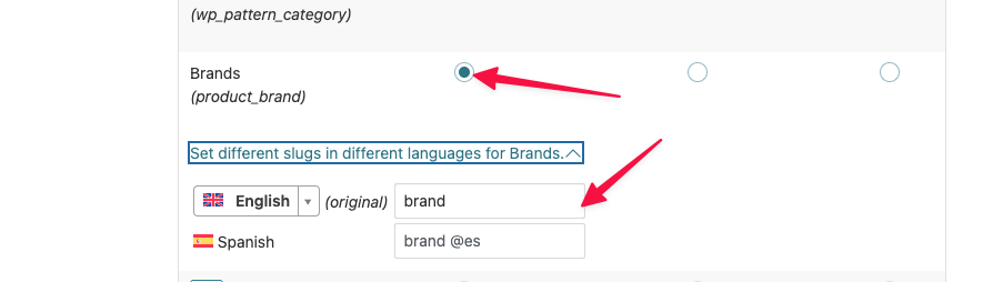

An attribute has two labels, singular and plural i.e. color - colors. And then the slug. If the plural makes no sense, you can set it the same as the singular.
Then, you can translate the labels. And the slug.
The slug is not appearing in the taxonomy translation.
Can you please check that the product attribute is set to "Translatable" in:
WPML > Settings > Taxonomy Translation
You can also translate its slug there, check the screenshot attached please.
Best Regards,
Otto

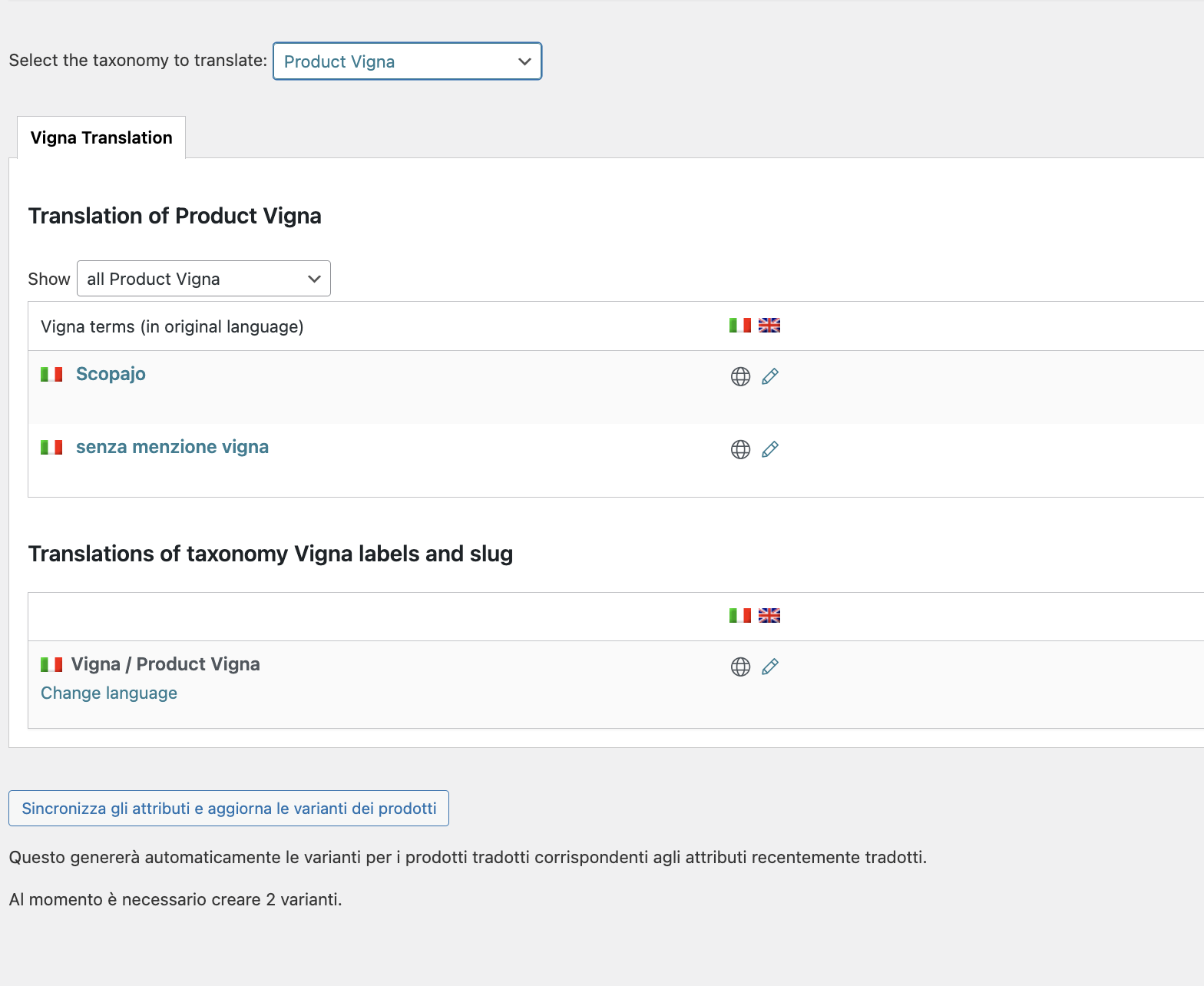

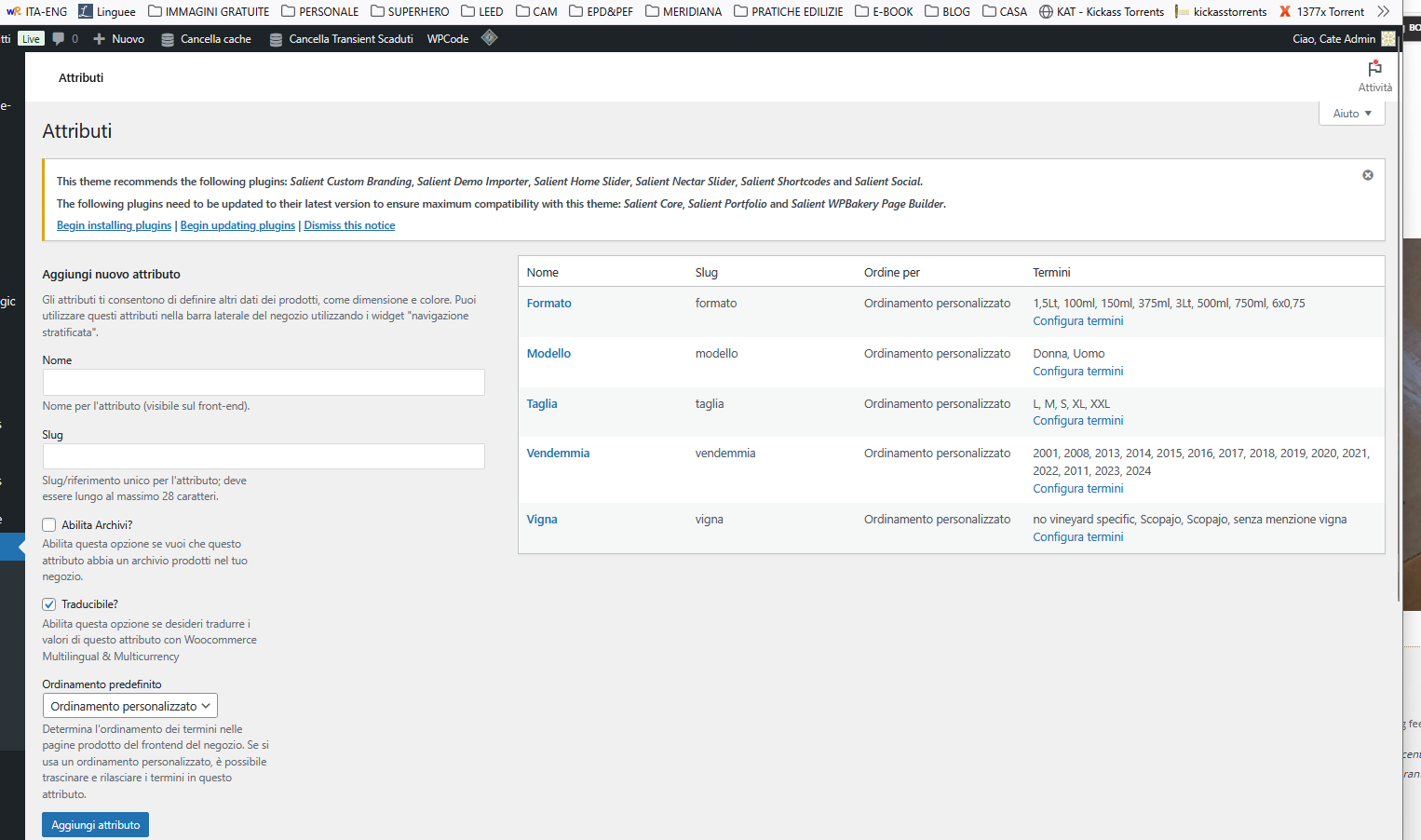

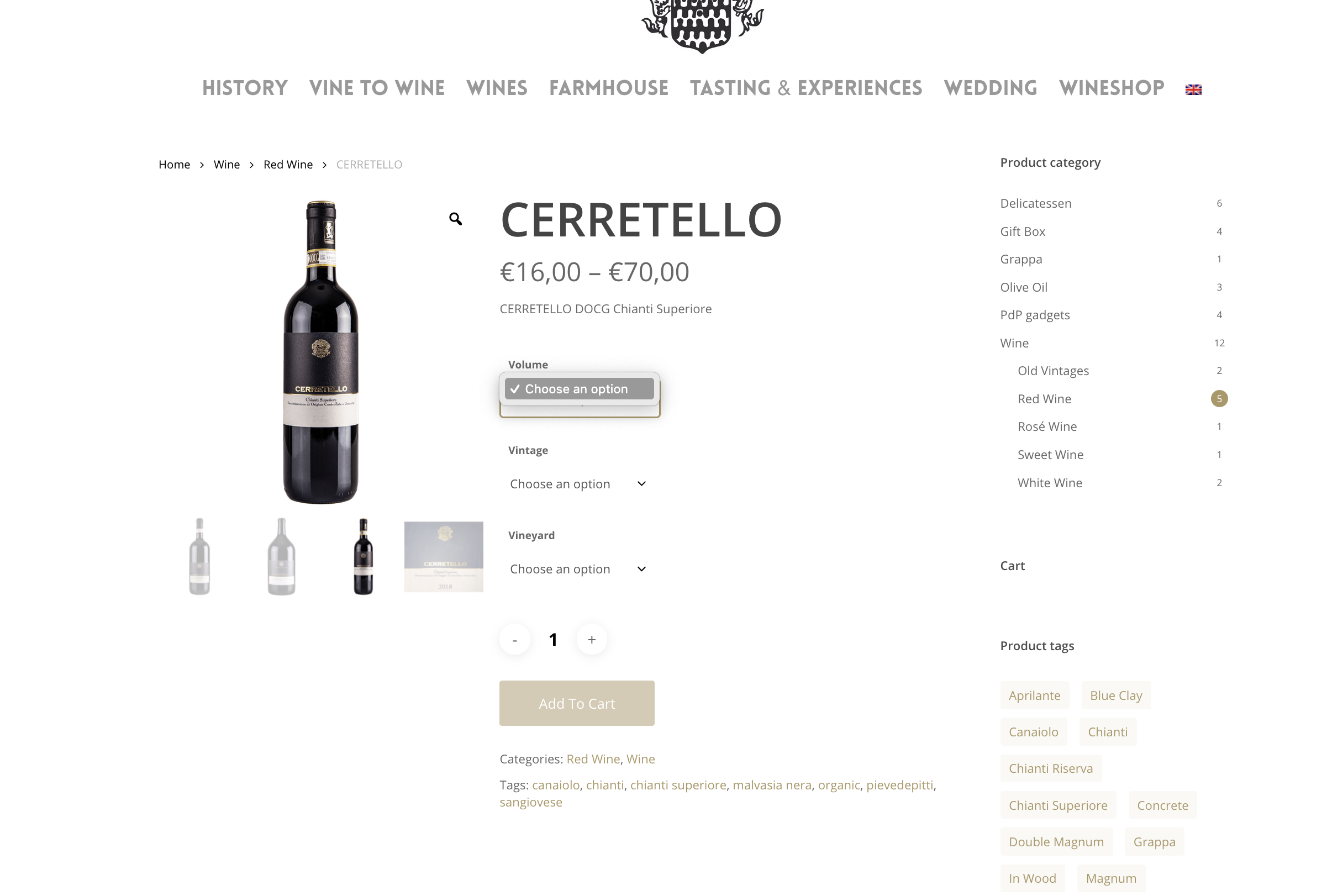

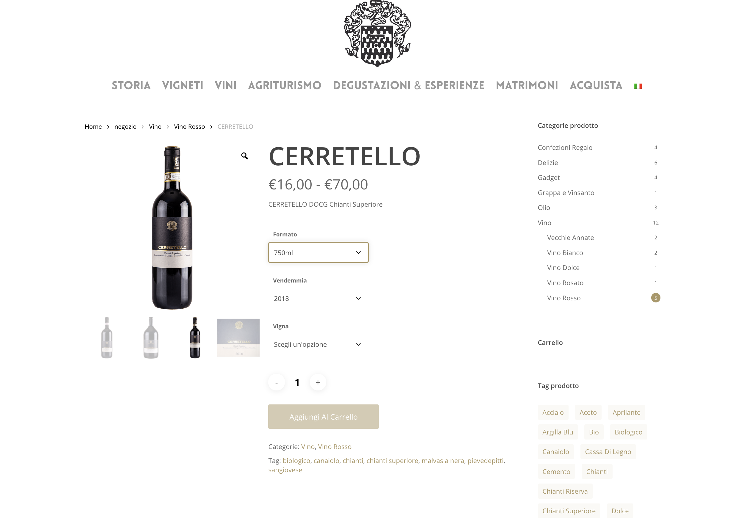

hi Otto, finally I managed all translations and have put in order all related terms. But i still don't see any way to switch between languages when I visit the product attrbute page as it was before and as it still is for product categories
see picture
all attributes have bee translated but they are not grouped as attribute in the taxonomy translation tab and they appear as single taxonomy item
see picture
all traslations exist, but translated product still haven't attribute
see picture
they are "Translatable" in:

About the language switcher in the attribute edit page. I am seeing the same behavior in a test site. I'll check if this is a bug. Meanwhile, if you need to reach it, you can switch languages before. I mean, in Dashboard change to the language you need and then go to WooCommerce > Attributes. You'll see the terms in the selected language.
Regarding the variations. In the screenshot you've share: 17310653-Schermata_2025_08_11_alle_17.35.14.png, there is a button below the table, "Sincronizza...". Can you please click it?
Best Regards,
Otto
August 12, 2025 at 8:53 am #17312436
caterinag-2
Hi Otto!
Thanks that worked!
now all attributes are properly linked to product in both language.
