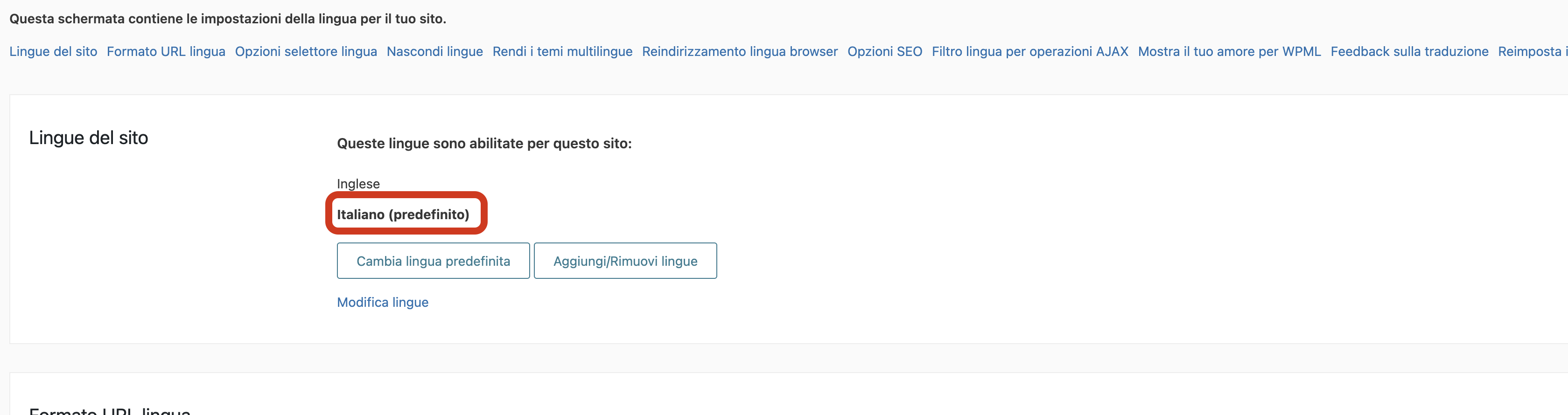

- confirmation that Italian is set as the default language and English as an additional language
This will allow us to accurately recreate your environment.
I look forward to your reply. Thank you and best regards.

### wp-core ###
version: 6.8.3
site_language: it_IT
February 13, 2026 at 11:57 am #17820315
rolandoC
Thank you for your reply.
In my previous message I provided the installation details (WordPress/PHP environment and the list of active plugins with versions).
I also attached a screenshot showing that Italian is set as the default language and English is configured as an additional language.
Thanks again and best.
