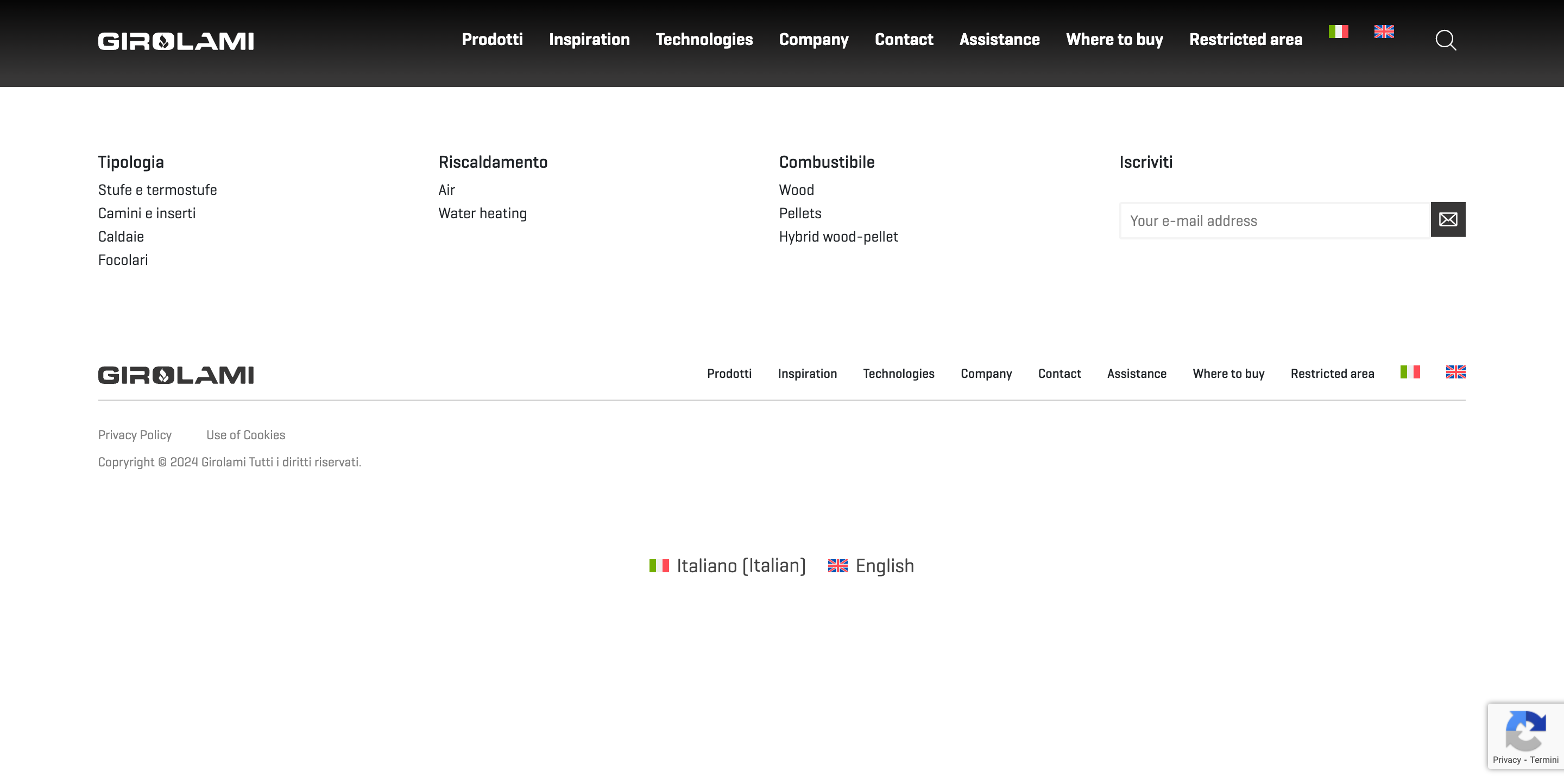

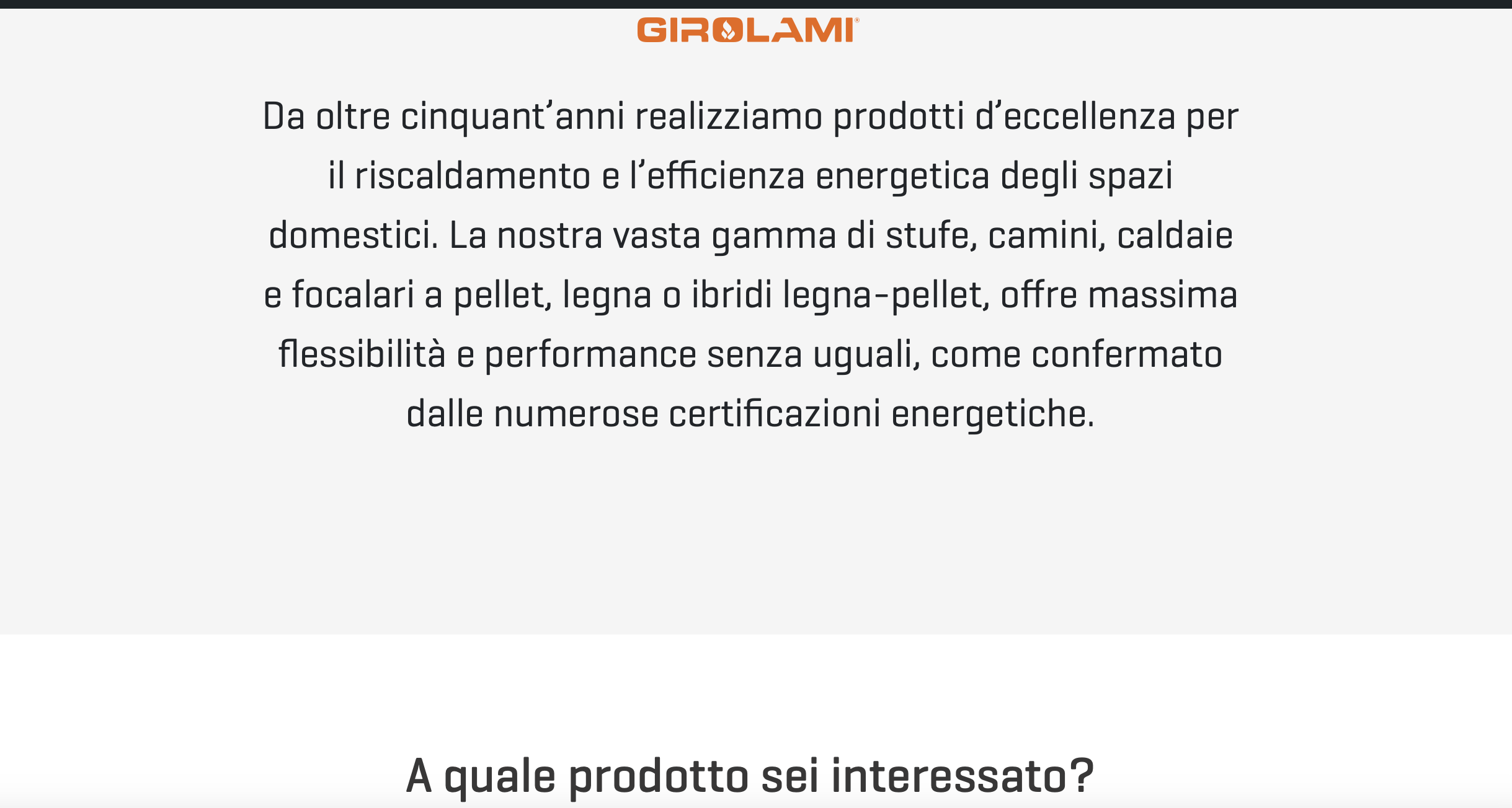

Ok let me try to explain better.
The 1st image is part of our home page in first language (italian)
The 2nd show the English where you could see that the is no content
All translation jobs should be done, we have enough credit and no queue
Hope of can help.

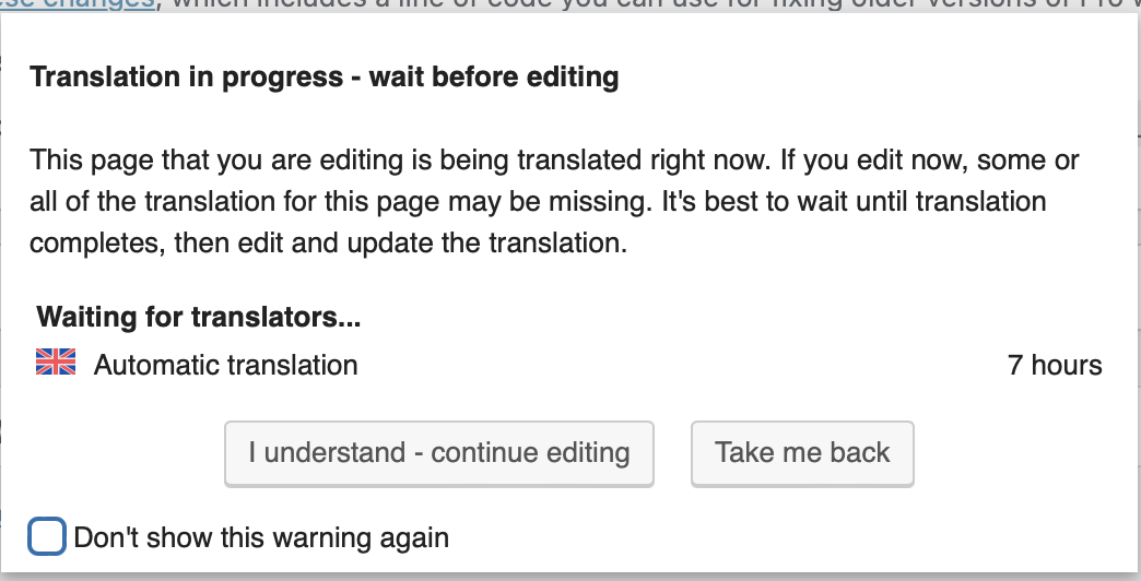

tommasoG-5
Ok I rememvber It tries but a warning message appear that translation process was taking other XX hours to be completed. What does it mean? Aren't translations done? Please see attachment
April 14, 2024 at 3:55 pm #15516409
Osama Mersal
WPML Supporter since 02/2020
This message appears when the translation is in progress. Please click "I understand" and click the update button.
When the translation is in progress, you will see the "Gear" icon instead of the "Pencil" icon.
